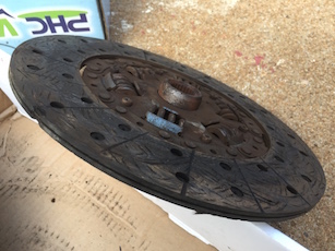

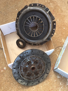

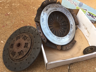

Good news
Got my truck back today. All works perfectly, and drives like a charm.
I must add, it is much more responsive when puling from standstill.
I took the car to them on Friday late afternoon.
They started taking it apart on Monday morning.
Engine out at the front to allow the gearbox to be dropped. So not an easy job.
Wednesday afternoon it was all done.
Well, so far so good.
(I will take pictures of the old clutch over the weekend and post it here)
I will keep posted if there are any latent issues.
But so far I can really recommend these guys.

Ek verstaan nie. Daai clutch lyk dan vir my nog heel ok?
