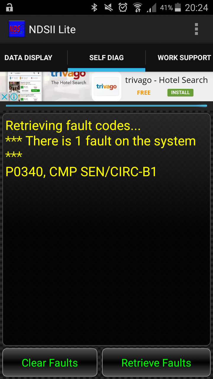

So it has been a while since I updated this thread. I have averaged 24.06l/100km or 4.15km/l over the last 5,274km, which is worse than those being quoted above. The 5,274km is mostly town driving, with a few long distance trips an a couple of off-road trips. I still think that it is a little too heavy, but I do drive it like I stole it every other day and I am running 285/70R17 BFG K01s, which are 1.6" or 5.1% larger in diameter than standard.
So, besides averging 4.15km/l, I downloaded the Nissan Data Scan II app on Play Store and connected it to my OBDII bluetooth adapter. I have one fault code that keeps on returning after being cleared
It is P0340, CMP SEN/CIRC-B1 which translates to Camshaft Position Sensor Circuit Bank 1. That could (according to Dr. Google) be part of my heavier than average fuel consumption
Have any of you guys successfully diagnosed fault code P0340, replaced the Camshaft Position Sensor (from who and at what price) and experienced improved fuel consumption?

Hi Bruce
Glad you sorted with Nissan data scan
I have not replaced my CPS but I have rotated it when setting the ignition timing to factory spec of 5 BTDC with the timing light.
Dont put anything magnetic close to the CPS as it can be damaged.
Do you have the Nissan workshop manuals? The information you need is on page 377-383 of the EC (engine control system) for the TB48DE AT.
Here is the link for a CPS for sale in Aus http://patrolapart.com.au/product/genui ... ensor-tb48
Not sure what Nissan SA would charge but maybe its just a bad connection etc.

Hi NMADNMAD wrote:Hi Bruce
Glad you sorted with Nissan data scan![]()
I'm hoping that it's just a connection cleaning type of issue cause that Aussie website has a scary price on a new sensor and I'm sure that Nissan SA will be even worse. I have two workshop manuals. The one is a hardcopy Max Ellery Repair Manual for 1998 -2009 Patrols and the other is a softcopy Nissan Motor Company Service Manual from 2004. The EC section of the softcopy only goes to page 60 so that's not the version that you are referencing and pages 377 to 383 of the Max Ellery relate to Rear Suspension and Steering so clearly I don't have the same manual as you. Would you mind PM'ing or emailing the section to me?
Thanks for the info
