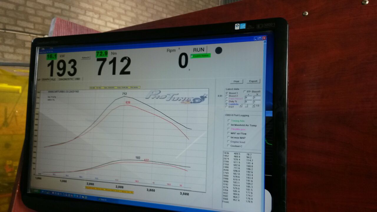

Re: So close to 200kw diesel
Hi guys thought I'd just post my dyno run today at Protune in Uitenhage PE. I played a bit and tickled my truck up a bit and managed to kick out 193kw and 712nm!!!! Now to find a way to gain 7 extra kw to make the magical 200kw in a diesel.... well I could put my 31's back on as it's running 33 at the moment.
- 193kw 712nm
- IMG-20160525-WA0000.jpg (82.6 KiB) Viewed 3752 times
- Been thanked: 432 times
Very impressive Niel!!
