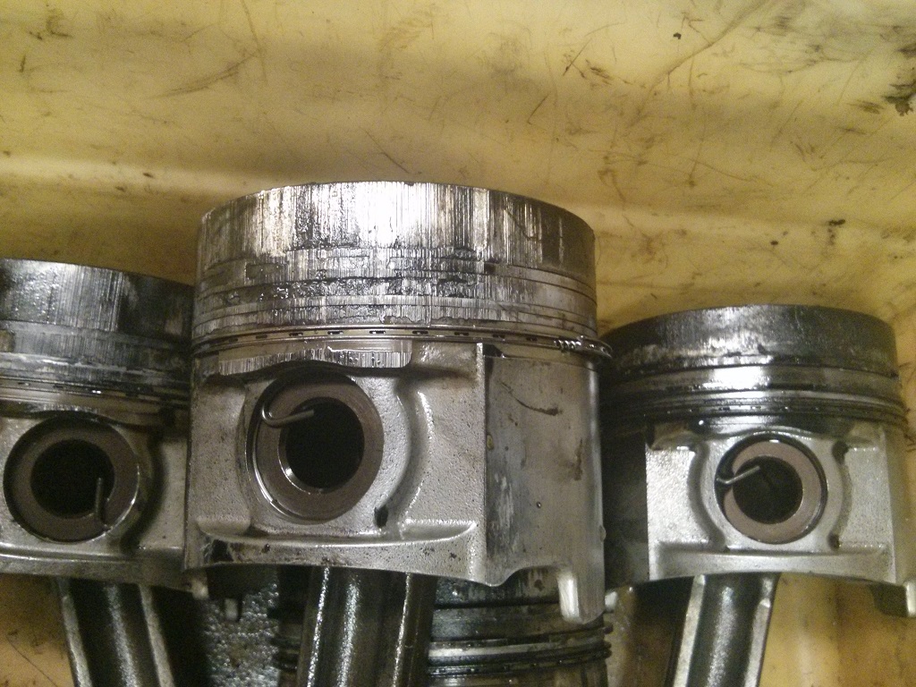

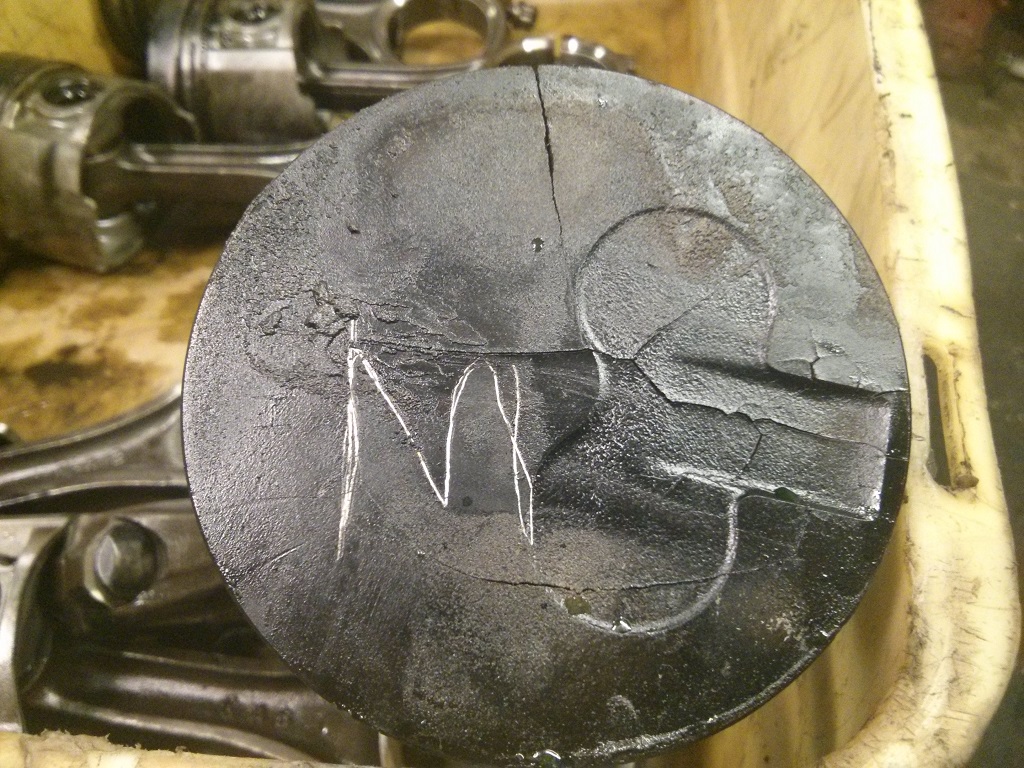

Five cracked pistons:
Compression rings bonded to piston & some serious scuffing:

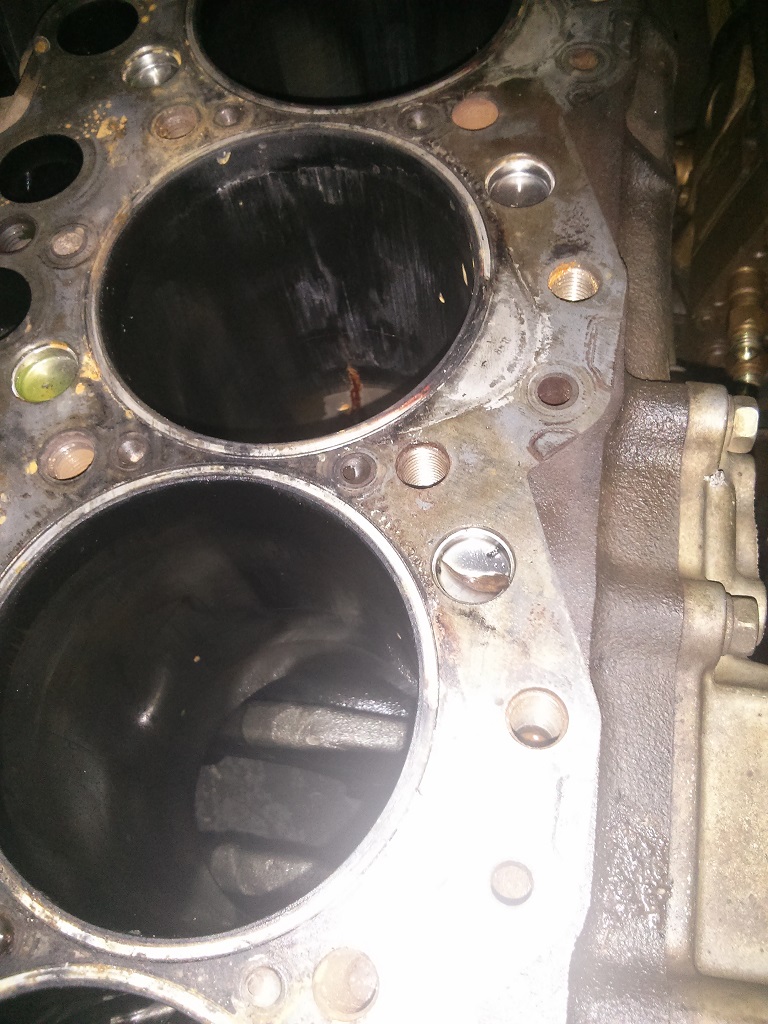

Scuffed and torn sleeves:

Sjo Christo, that engine became very very hot by the looks of things!!
How is the ceezed and cracked sleeve related ro the water in the diesel system? Looks very much like heat seazure to me.... but im no expert

Michael wrote:Sjo Christo, that engine became very very hot by the looks of things!!
I am also no expert in engine failures (thank goodness!), so I'm going by Graham's explanation. He undid the water trap at the bottom of the diesel filter and removed a lot of water, a finding that rhymes with the lit diesel warning on the dash. He reckons that the incompressible water & the high compression ratio combined to break the pistons. Once they cracked they expanded, then proceeded to gouge themselves & the sleeves. Once combustion was leaking, it created additional pressure in the sump, creating the PCV blow-by that was fed back into the motor resulting in a smoke-screen behind me.
None of the bearings showed any signs of heat damage/seizure and the motor still turned easily despite the piston failure. The head was generally in good condition with no carbon deposits, but the valve stems have some play (not sure if due to wear or water damage) and will need replacement. No gasket failure either - both water & antifreeze were in good condition with no cross-contamination.
When I realised that something was amiss (the engine suddenly lost power) I noticed that the water warming light was lit. The coolant temperature was still safe (roughly 3/4 of the gauge) but was climbing steadily. I had no Madman alerts either, and I monitor water level, oil pressure, oil temperature, EGT and coolant temperature! My guess is that it was a catastrophic failure, rather than a slow build-up. :think:
