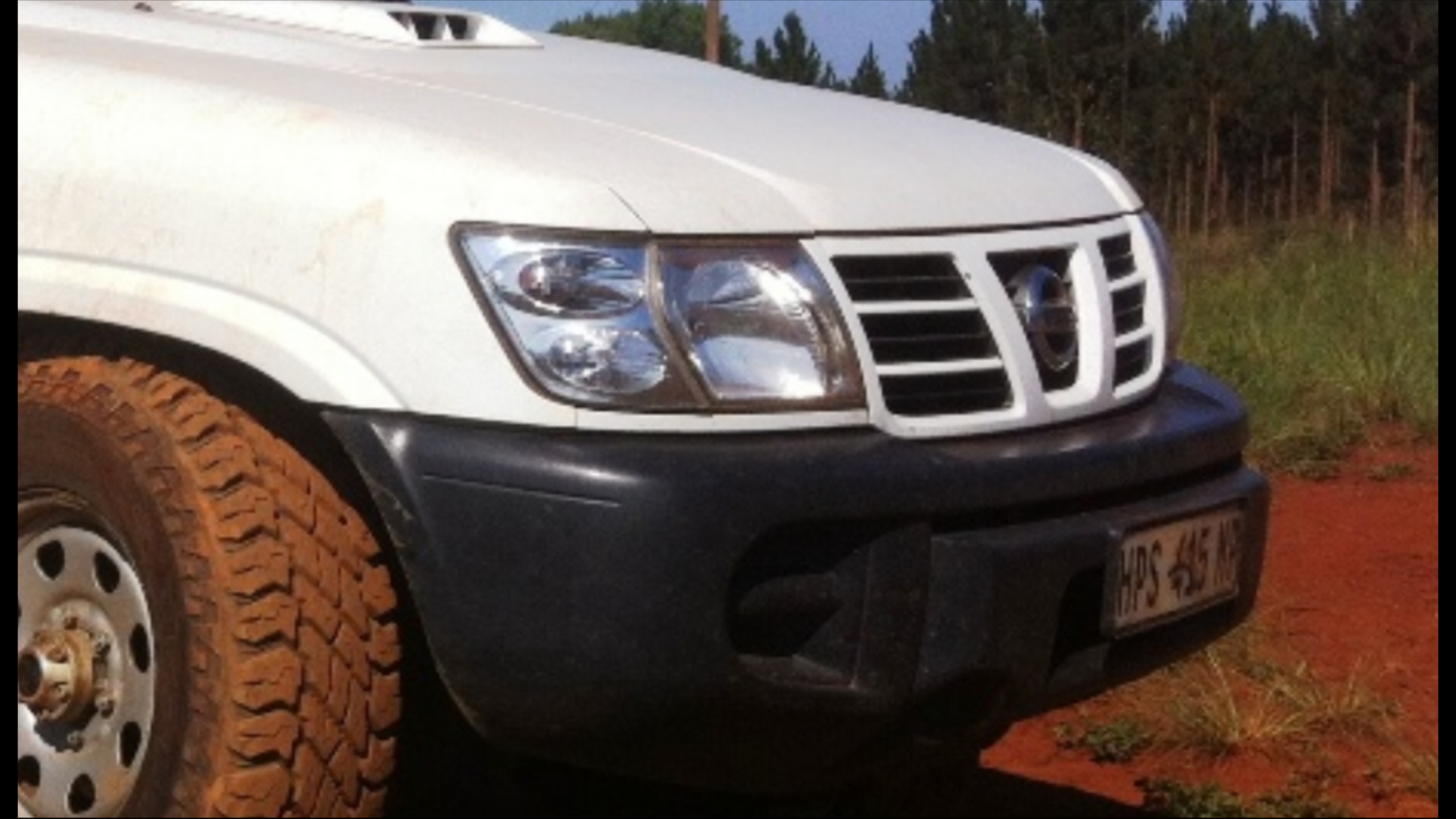

I noticed that the headlamp and indicator on Fanus's 4.2 pickup and many other older shape 4.8's looks way cooler than the headlamp and indicators on mine.
Can someone verify if I can just fit the newer ones?

These are the ones I am refering to
- NGR-21031-21011LHRH-COM-1.jpg (185.74 KiB) Viewed 2328 times

The headlight holes are the same over all the Y61s. The difference is the line between the head lights and the park/indicator pods. The prefacelift have a sharp kink while the facelifts have a curved jion.
So if you fit face-lift headlights the indicators need to match. It looks from the picture you posted that those indicators are facelift and will not work with the headlights!!

I see what you are saying, but its actually not easy finding a nice pic on the net of what I am looking for. And I am looking for both headlamp and indicator.
Here is a pic of Fanus's 4.2 bakkie which looks just like my Patrol's front end. I have also seen many preface 4.8's with these headlamp/indicators.
- Screenshot_2016-01-03-15-10-28.png (2.21 MiB) Viewed 2286 times

Michael wrote:Hi Steven
They will fit. Any of the y61 lights will fit as long as you match the indicators.
