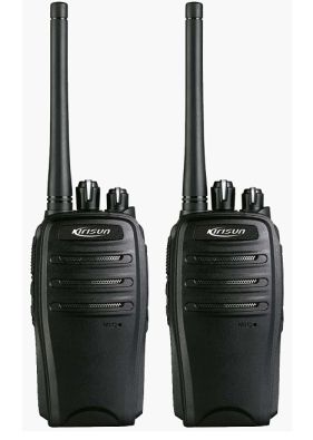

You recommended the Kirisun PT4200 VHF portable Radio. What is the range? And how do you charge the battery in the vehicle? They seem to be sold with a "rapid rate charger" which I assume is a 220 volt charger.

The PT4200 has long since been superceded by the PT3600 portable3 radio, which is a brilliant design. It is even more rugged than the PT4200 and has proven itself to be incredibly reliable.
You are correct that the charger is for 220v AC but the radio can be charged from a 12v supply as well by using an optional DC cigarette Lighter cable that plugs into the charger pocket, instead of the 220v AC mains power pack.
Range is dependent on many factors, but in general between two vehicles when the radios are both used in two vehicles you could expect about 1 - 1.5km, but by using two magnetic base antennas then we are looking at 5-6km, assuming level road with no obstacles in both cases.
Fixed mobile radios would provide at least double these distances, depending on how the outside antenna is mounted.

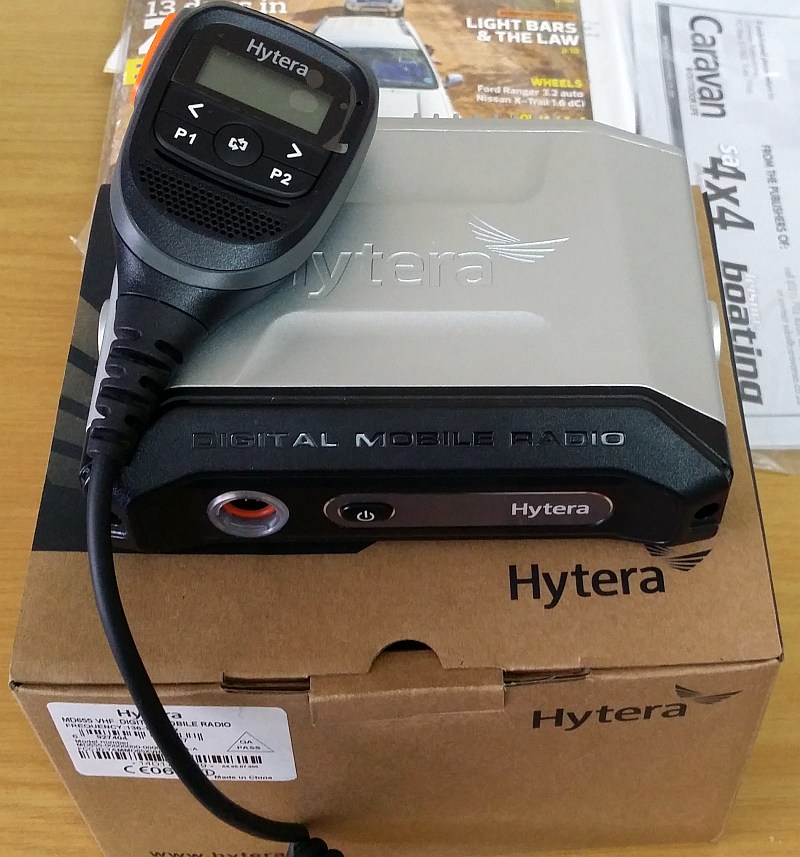

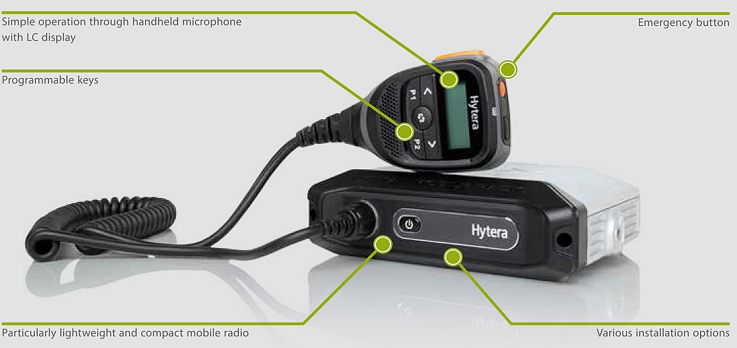

Practically all modern vehicles have very limited space for a two-way radio, and while there are various VHF Remote Mount Radios available, these have always been very expensive. Hytera ia one of the "Big Five" two-way radio manufacturers in the world and they have now come up with a cost-effective winner!
The Hytera MD655 is a fully remote mount radio which means the radio unit itself may be mounted anywhere convenient (subject to the standard microphone cable length of 2.2M, 6M optionally available), for example under a seat etc. The antenna and power cable connections go to the radio. The remote microphone is a specialised unit containing a LCD Display (CH 1, Ch 2 etc) and incorporates a very efficient loudspeaker as well as the channel up-down buttons and various other programmable function buttons.
The MD655 radio is a full 25w meeting IP54 Industry rating and exceeding the Shock, Vibration and Relative Humidity parameters as set by the USA MIL-STD-810 C / D / E / F / G specification. It is fully capable of both Analog (as in conventional radios) or Digital Radio Mode (DRM Tier II) and covers the full VHF band from 137 to 174MHz. UHF Models are also available but these do not apply to ORRA and Hilux Club frequencies.
