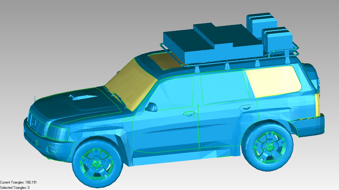

The Roof Top Tent caused a bit of problems with the top frame. I had to make some changes to the frame. This is what I am thinking of.
Roofrack STL 3.jpg (155.52 KiB) Viewed 4040 times
I do not want to raise the RTT to much due to drag. I can fit 4 Jerry cans on the back as well. The Jerry can brackets will be the next project.

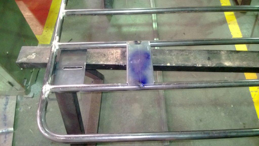

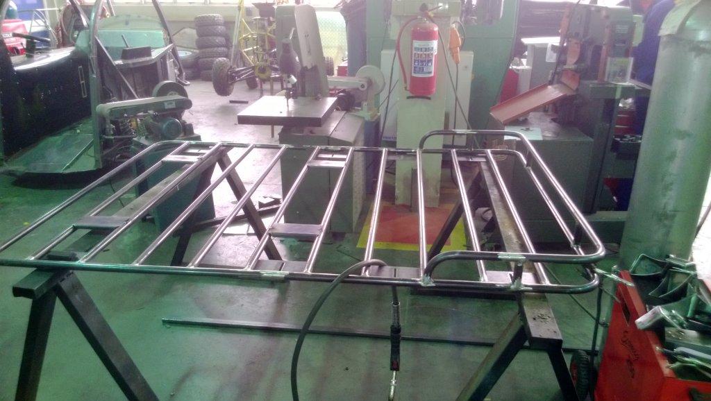

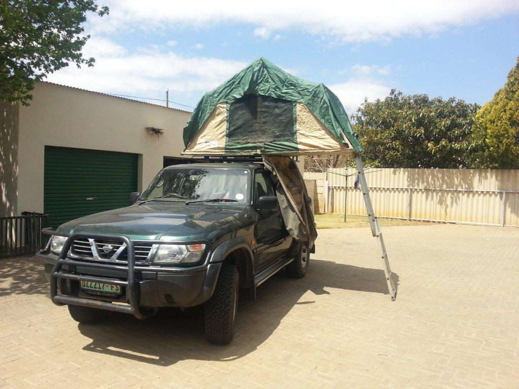

I finished the roof rack and received it back from the powder coating yesterday. I am not the best at taking photos during a project but here is some.
Welding frame
Welding frame
Roof top point
Roof top point

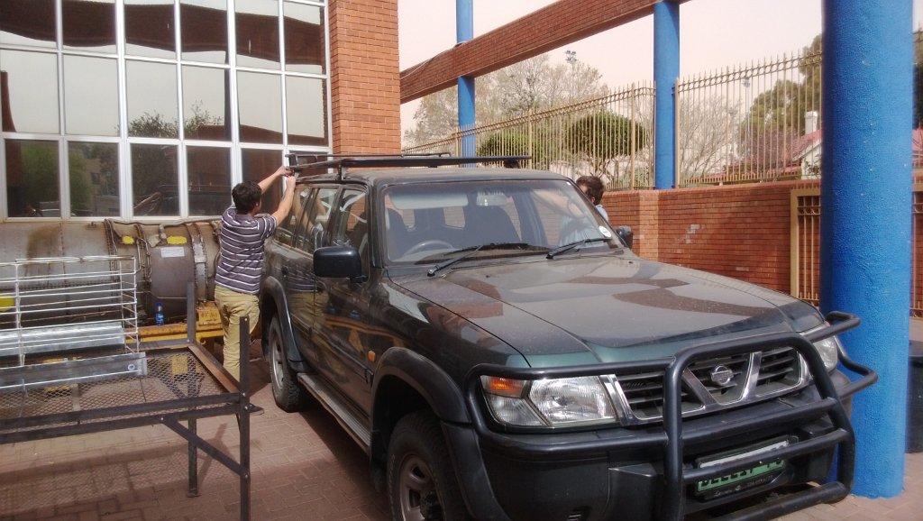

First Fitment
First Fitment
Before Fitment
Before Fitment

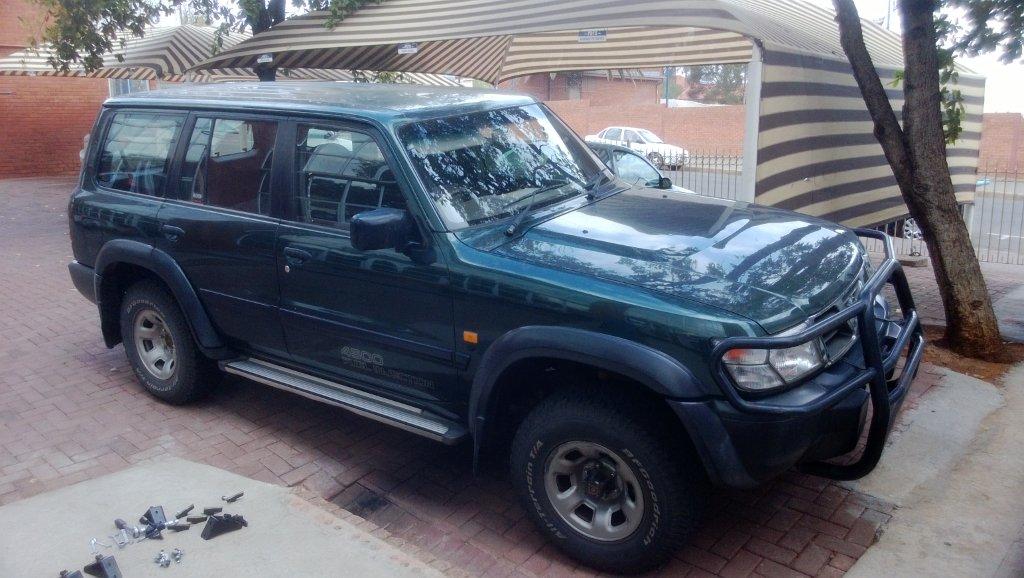

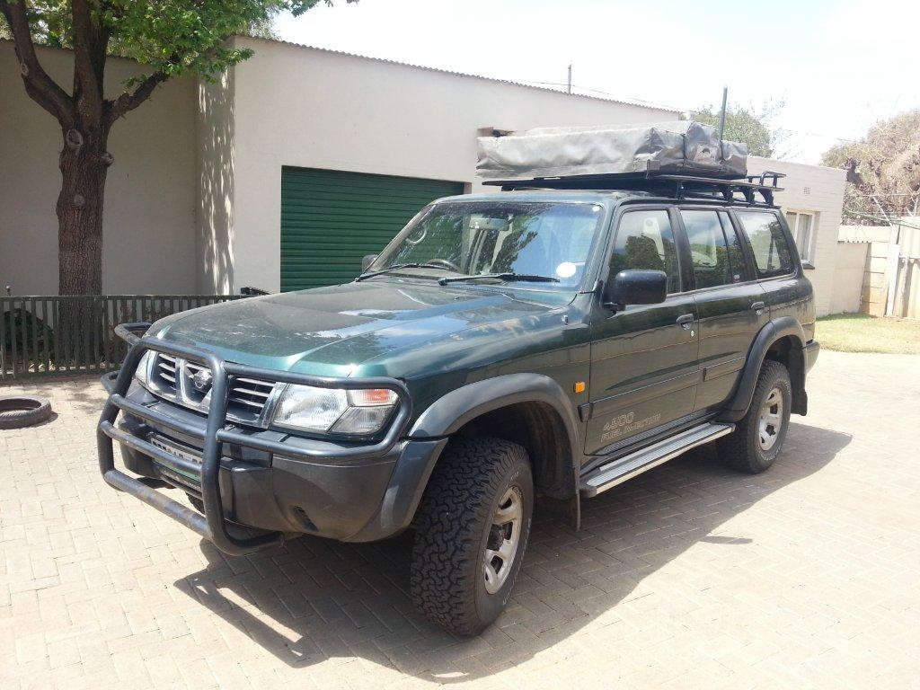

After Fitment
After Fitment
The roof rack cost about R2200 with labor. The material was: R340 for the 25mmx2mm pipe, Feet was R65 with the nut and thread bar, Powder coating was R520 for everything. That is R1380 for material.
I climbed onto the rack yesterday and it seem strong enough. I weigh about 100kg and I could stand on one brace and it did not bend. I am fitting the rooftop today. Will post some more photos. :thumbup:

Chris Skinner
Posts: 852
Joined: 26 Nov 2009 12:58
Full Name: Chris Skinner
Nickname: Chris
Has thanked: 10 times
Been thanked: 53 times
Re: DIY Roof Rack
Post by Chris Skinner »
Looks good, well done!
Is it steel or alluminium, and what is the weight approx??

Hi
It is steel. It weighs about 12.5 kg after the powder coating and welding.
