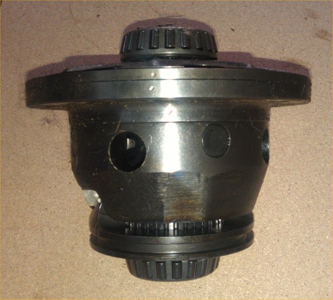

Here are the locker bits that came out of my diff:

@ Christo: thanks for posting the picture. That is the center part of the diff, so it definitely looks like the ring and pinion (the parts that I need) are re-used when the ARB locker is installed.
