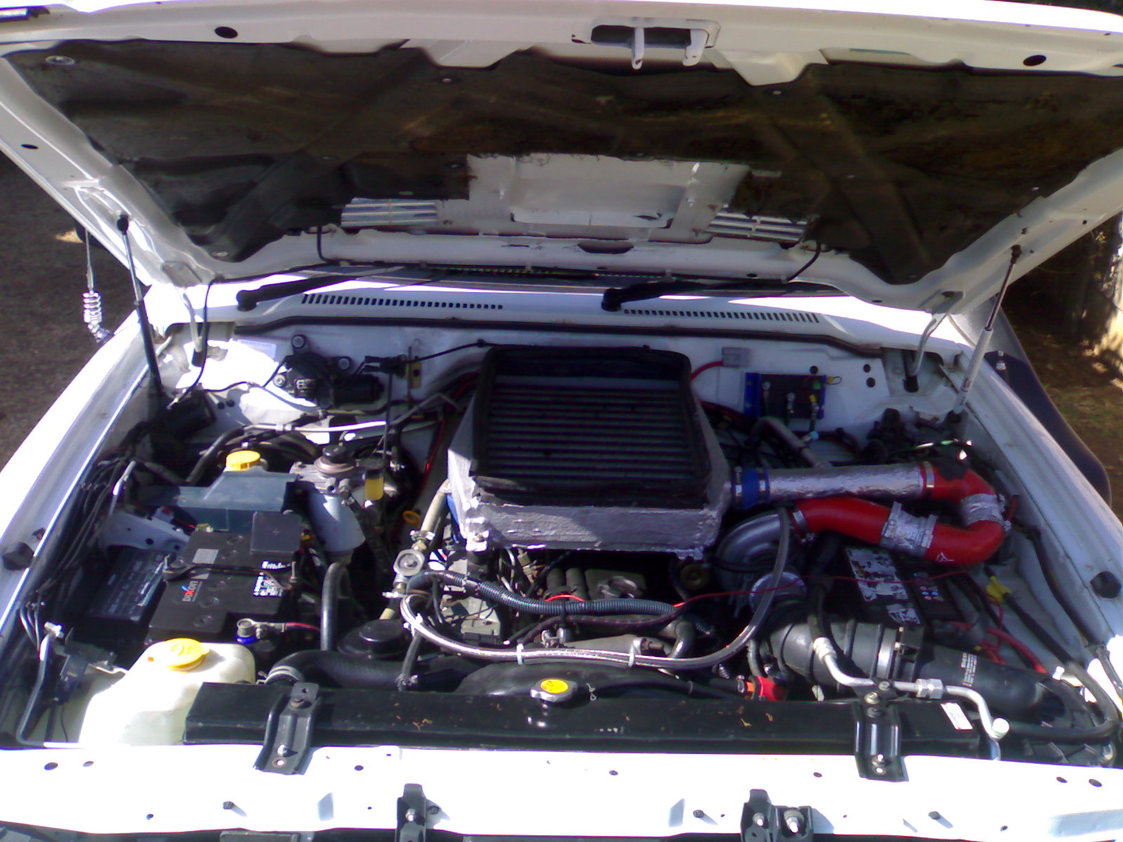

On mine the fan is mounted underneath the IC, which is top mounted. The previous owner also had the whole IC ceramic coated.... looks like crap but I'm sure it assists in keeping the heat soak down. I do however need to add heat shields as mine has exhaust branches and a shield is going to be a tricky thing to make fit as my turbo sits quite high up in the engine bay.
This is an old photo of the engine bay the day I brought the Iron Maiden home. That horrible red piping has since been changed to a shorter and more curvy air inlet pipe to get rid of those sharp 90 deg + bends.
