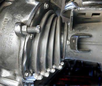

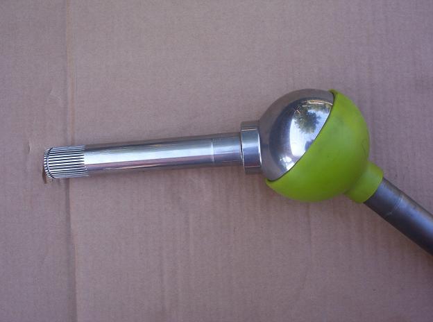

After the leak stopped on mine, on the left wheel (long shaft), I thought my problems were over and it was nothing more than the diff being transported upside-down on the bakkie from Cape Town. The past week or two, I have noticed a fair amount of moisture on the driver side now. You can see it is "washing" some of the grease out of the burfield onto the ball.
Something I did see the other day on the web, was a boot to close up the entire ball. It was for a landcruiser, and searches do not get me anything for the Patrol. It could be nice to seal off that area from mud and sand, but then again, you will never see when this seal problem starts up, and can be diluting your grease with diff oil.

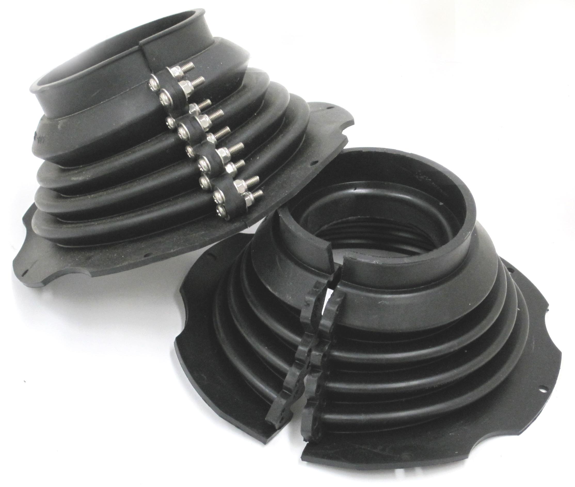

Dave,ja, i've seen those boots before on JohanTyres Land Cruiser. Whilst they are cheap to buy and look very sexy, i believe they can hide any issue that may arise, like an early warning sign of oil leak,... also, i dont belive they will seal 100% so any water crossing / mud slinging and that stuff is going to be trapped in there grinding itself into a paste, and very very quickly destroy that knuckle seal / otherwise.
I'd rather keep them open.

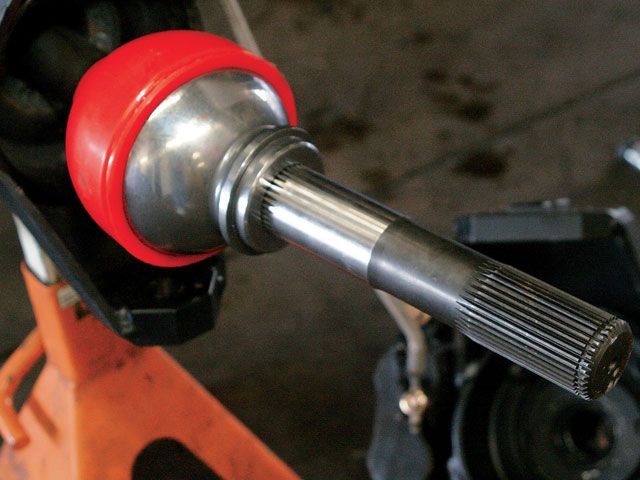

birfield boot
So 'n ding?
- birf boot 2.jpg (95.94 KiB) Viewed 3218 times
- dana60birf22.JPG (42.32 KiB) Viewed 3220 times

No, these.
- splitboot.jpg (234.3 KiB) Viewed 3099 times
- Boot.jpg (14.62 KiB) Viewed 3099 times
