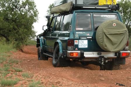

- Checked suspension
- Atriculation.jpg (66.86 KiB) Viewed 3024 times

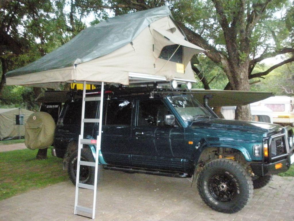

- Roof Top Tent
- Roof top Tent.jpg (162.25 KiB) Viewed 3024 times

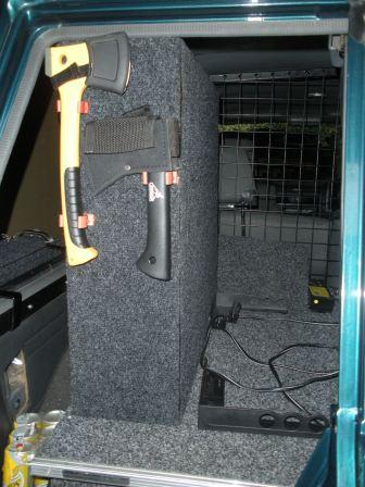

- Axe Brackets
- Pic4.jpg (47.78 KiB) Viewed 3024 times

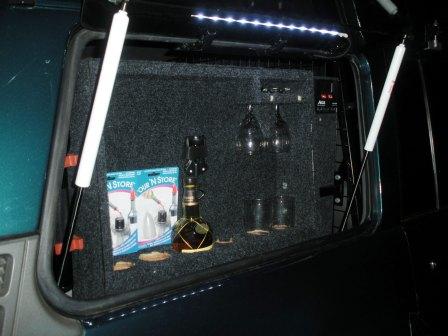

- LED Lights
- Pic 7.jpg (41.4 KiB) Viewed 3024 times

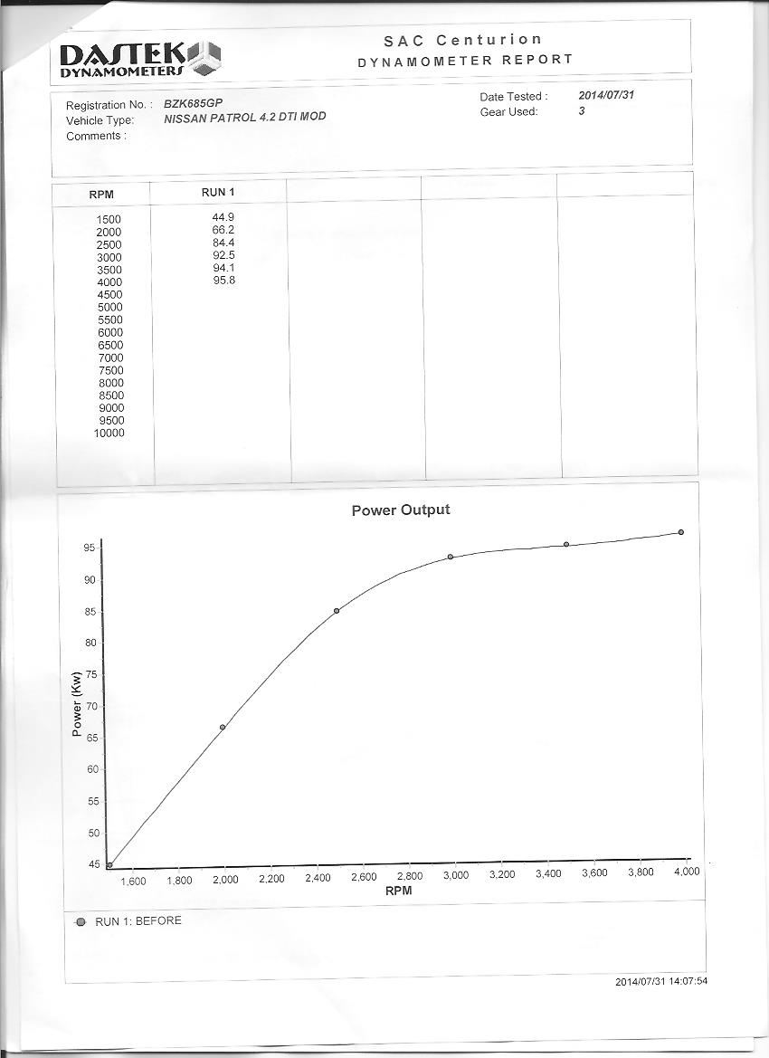

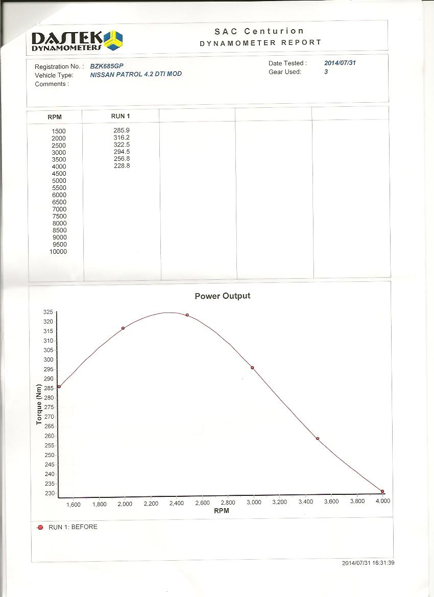

Just took my troll for it's 405 000 km service and all is well.
Compression in spec, injectors in order, and power and torque as normal. Tx very much to SAC Centurion for ensuring my Troll's reliability.
- Torque.jpg (75.57 KiB) Viewed 2953 times
- Power.jpg (74.21 KiB) Viewed 2953 times

Impressive and interesting to see the figures to RPM.
