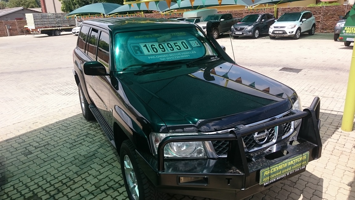

Saw this on for sale here in Alberton at Raceview Motors
I have no idea what it is, but I'm pretty sure it isnt a TD42 ....hahaha, or a 3.0 for that matter.

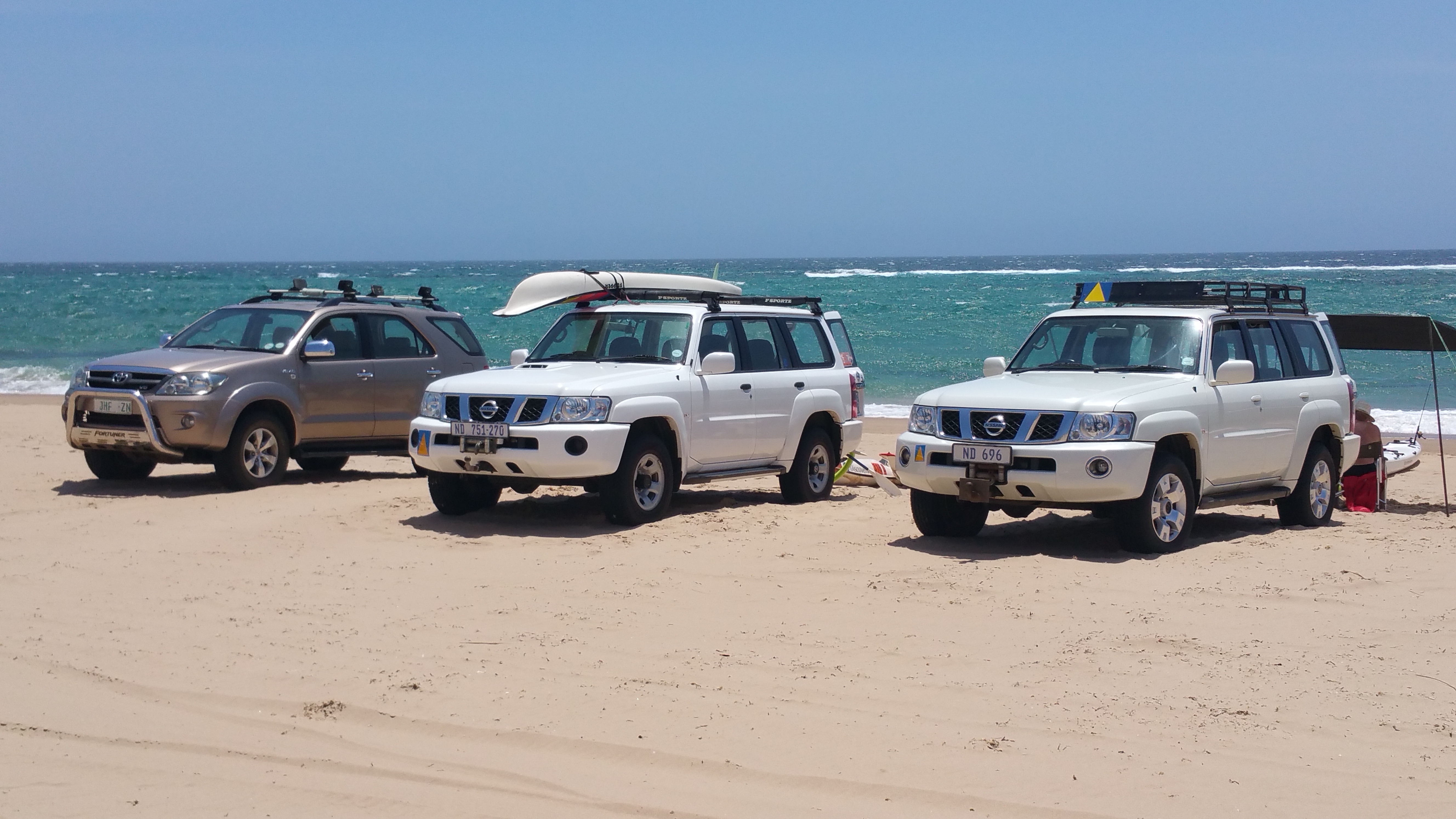

Saw a member at Legogo beach the dad drives the 4.8

Cedric would you mind checking this one out proper for me. Servics history all odds and ends. It is on my short list. Do not care much for the colour. But if all else is good I can overlook the black.

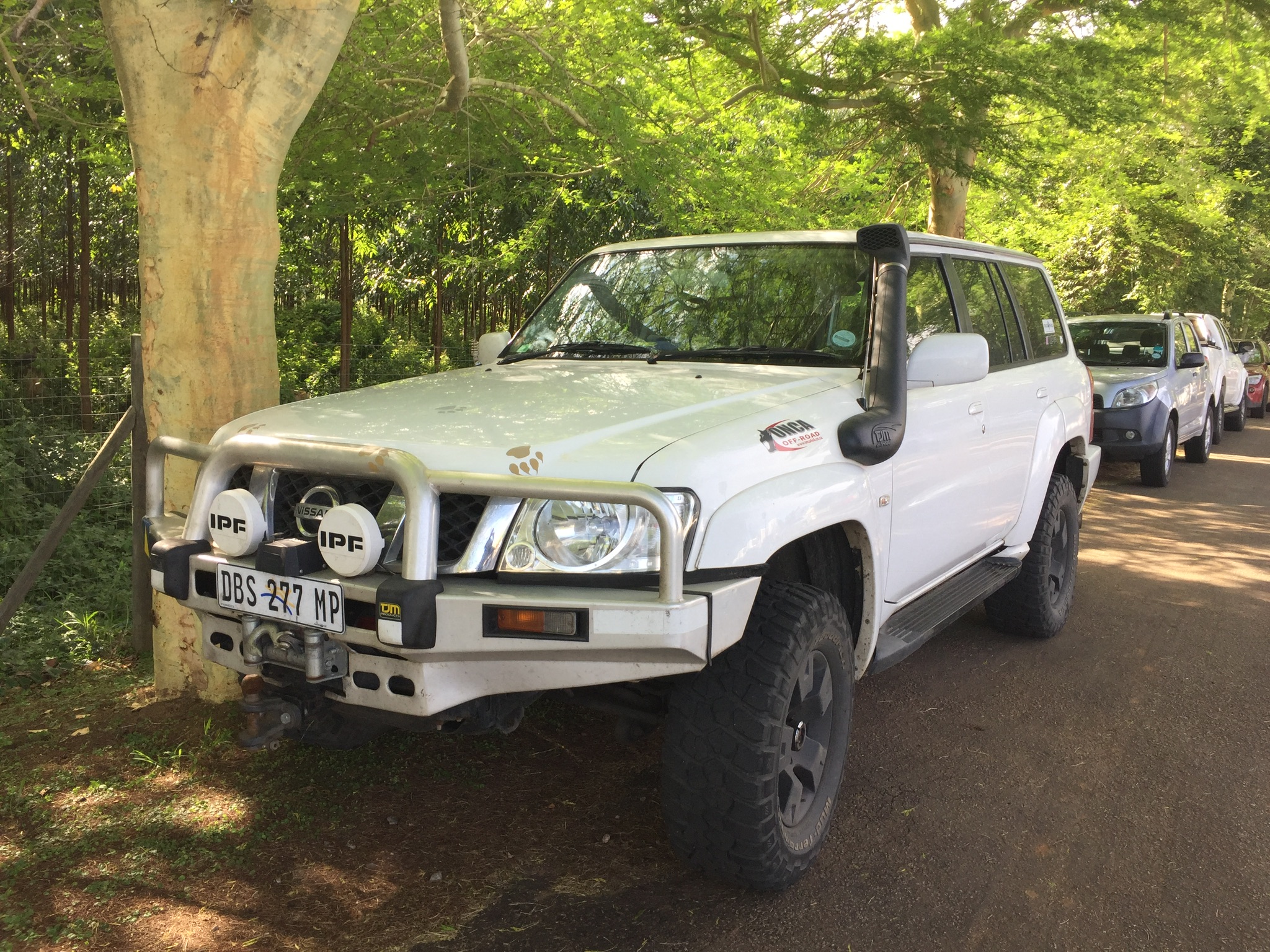

Saw this one at our school in Zoeloeland

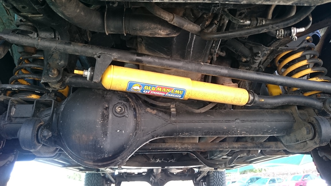

Josh, it looks quite low on mods, other than the bullbar.JoshJ wrote:Cedric would you mind checking this one out proper for me. Servics history all odds and ends. It is on my short list. Do not care much for the colour. But if all else is good I can overlook the black.
So that means two things:
1) It will cost you to mod it up again, compared to you current vehicle;
2) The car may have had an easy life so far. So no hard work on the drive train , clutch etc.

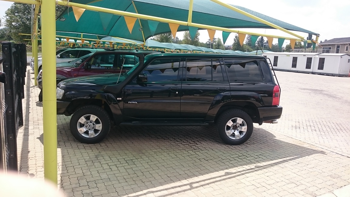

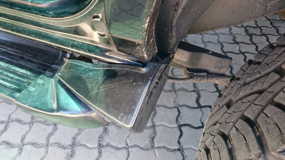

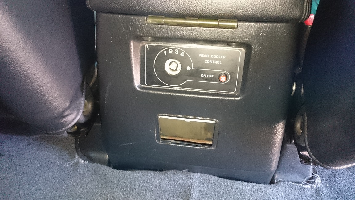

Josh, I took a spin past that black Patrol. They will look at dropping R10K after I mentioned a few things that need attention. But i'm sure there is room to negotiate further with them still.

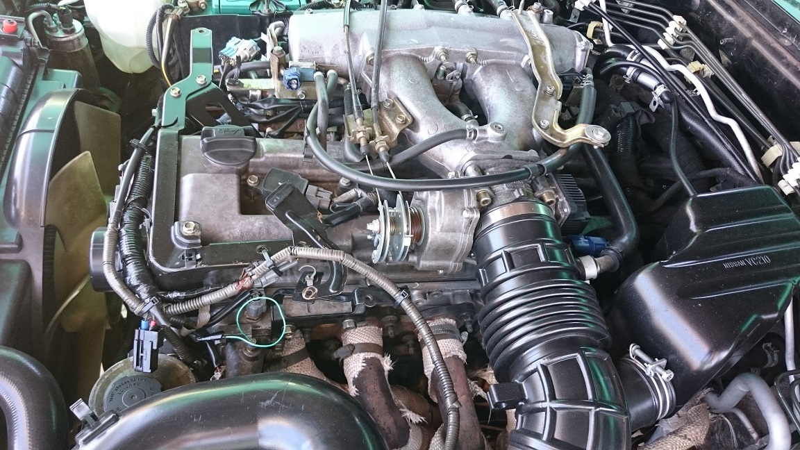

Its a 2005 model 4.8GRX with 221000 Km. By the way that motor sounds Beeeeeeautiful !!!.... very smooth and very quick rev response when in "Park" and sounds good with the exhaust branches. They will find out regarding service history. But lets say no for safety sake....
I took 33 photos of the Patrol and cannot sit and post all of them up, so will put up a few. Send me a PM and I'll e-mail you all of them.
Here is what I picked up:-

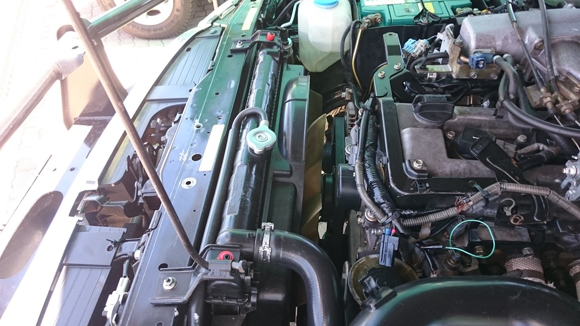

2) Bonnet gas struts to be replaced - there has been some rod fitted to the radiator bracket to hold up the bonnet....
3) Something tells me that that radiator is not the correct size for the 4.8..... guys please correct me if I'm mistaken. - Check last photo

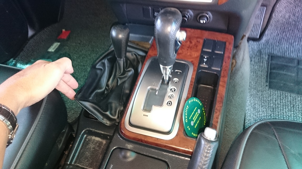

6) 4x4 lever leather boot needs attention

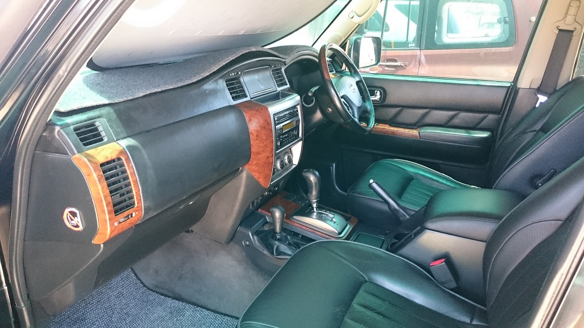

7) Interior looks ok but one can see it is 11 years old

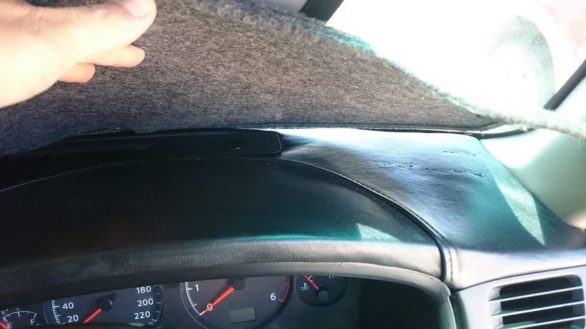

8) Dash looks like it has been re-vinyled and not replaced by Nissan

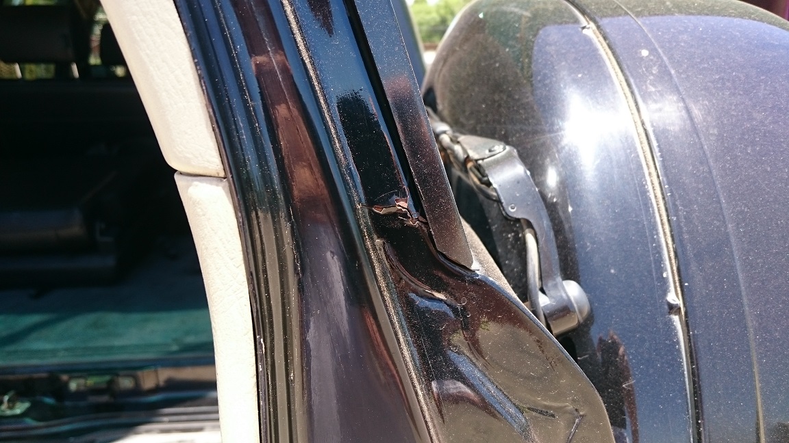

9) Rear barn door cracked at the post

11) Trim on one of the side steps loose
12) Someone put those Midas stick on letters to spell out PATROL on the doors, and a crappy looking 4.8 on the rear door that doesn't look good to me.
13) Body looks like it is in pretty good condition ( car was a little dirty from rain so couldn't quite see 100%, but didn't notice any dings and dents. I cannot see any "panelbeating" influence either.

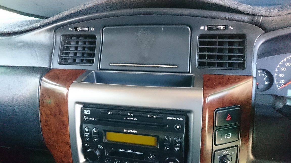

15) Center console climate control knobs and ashtray missing and on passenger seat
I quite liked it. Interior is fairly clean for 220 000 km.
I think this was used as a tourer, as there is duel battery wiring in the back with an Isolator in the engine bay, but no battery. I can also see that there was a roofrack fitted at some stage.
