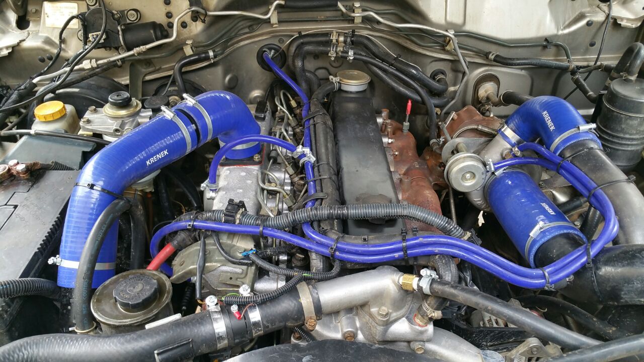

My motor noudat al die klampies op is
- IMG-20160612-WA0015.jpg (196.57 KiB) Viewed 5495 times

Dit lyk baie netjies Dude. Eks inpressed.

Hmmm... blou siliconeTinus lotz wrote:My motor noudat al die klampies op is
Michael, Ek sien Chuck het ook bietjie roes in sy water. Wil jy kom aanwysings gee?

wel gedaan julle twee koorstene ..dit lyk baie goed
Michael waar het jy daai blou air intake pyp met die buig gekry..

Christo, draining and flushing the system isnt actually that hard.
The big problem was getting the water out of the engine block. Under the turbo just above the oil preasure relieve valve is a bolt that uses a size 12 spanner, once you have removed that bolt you can flush the whole system with a hose pipe.
Errol, all the pipes come from MrTurbo in JHB
