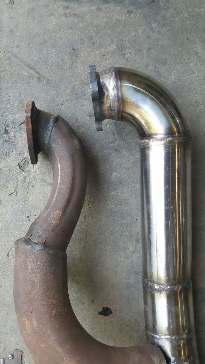

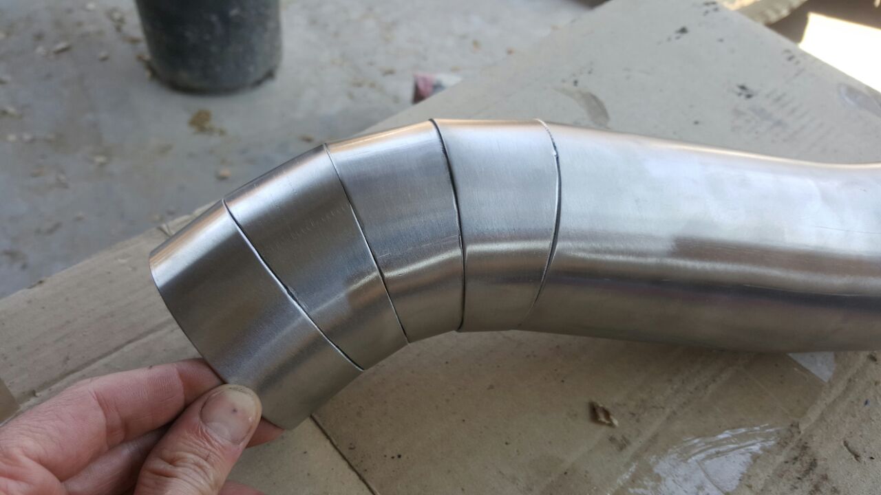

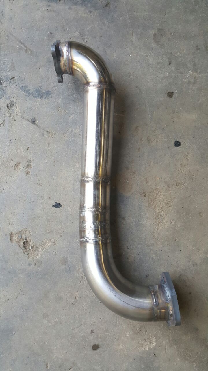

Ok so FINALY got my patrol going again and struggeling to drive it slow as it feels really smooth. I can really feel a huge difference in vibration insude the car with the balanced engine, it revs up much easier and cant wait to give it beans
I settled for only balancing the engine, building a new downpipe as my old one was very sad and not nearly what I have in mind for making power, and doing the precom mod as the excersize was not cheap.
I will also get my newly built intake manifold tomorrow, but will fit it a bit later.
I have also done some lobster bending on my intake pipe which looks very cool and will be doing all my boost pipes as well

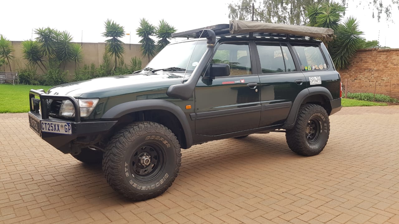

Jo! Its been more than a year since I have posted anything new on my Patrol...... been so busy with work that I could just not find time.
Anyhow, There are some exciting things in the pipeline so will be sharing them soon.
But before I start on the engine mods, I managed to swop my 33" wheel & tyres for a set of 35's and I am very chuffed
