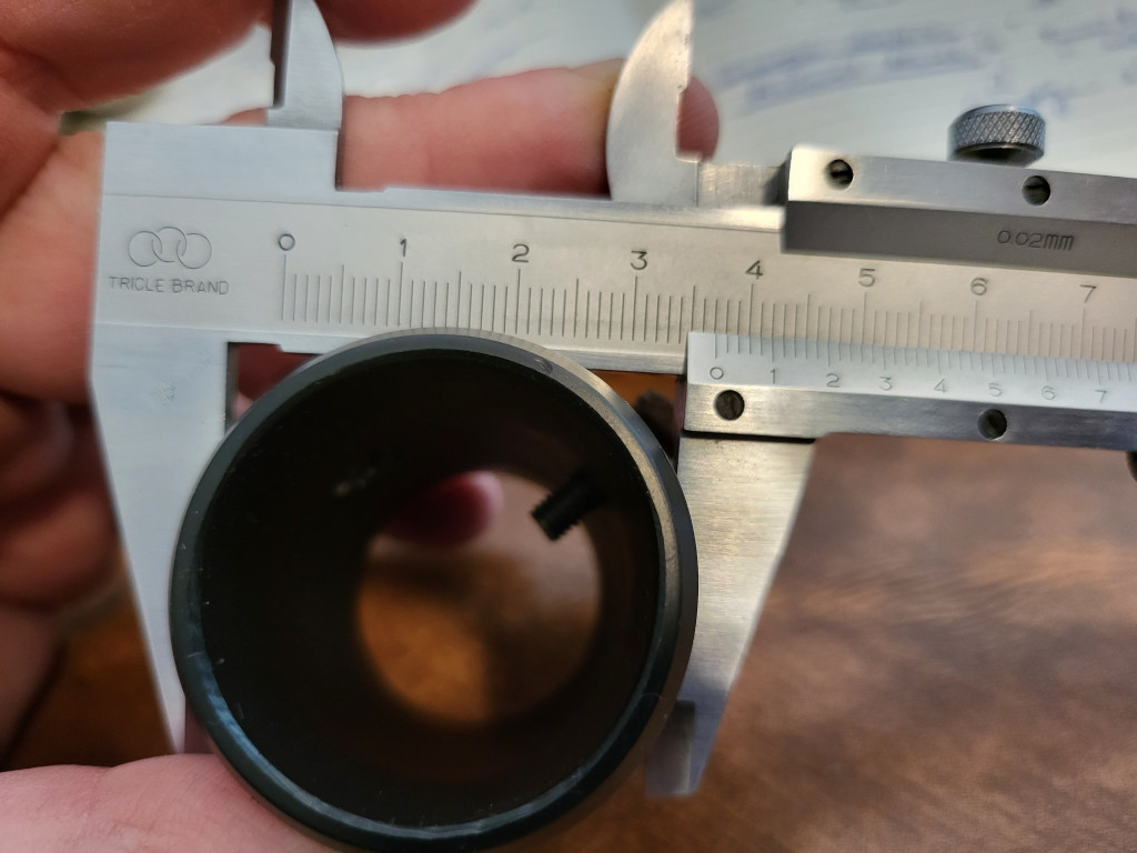

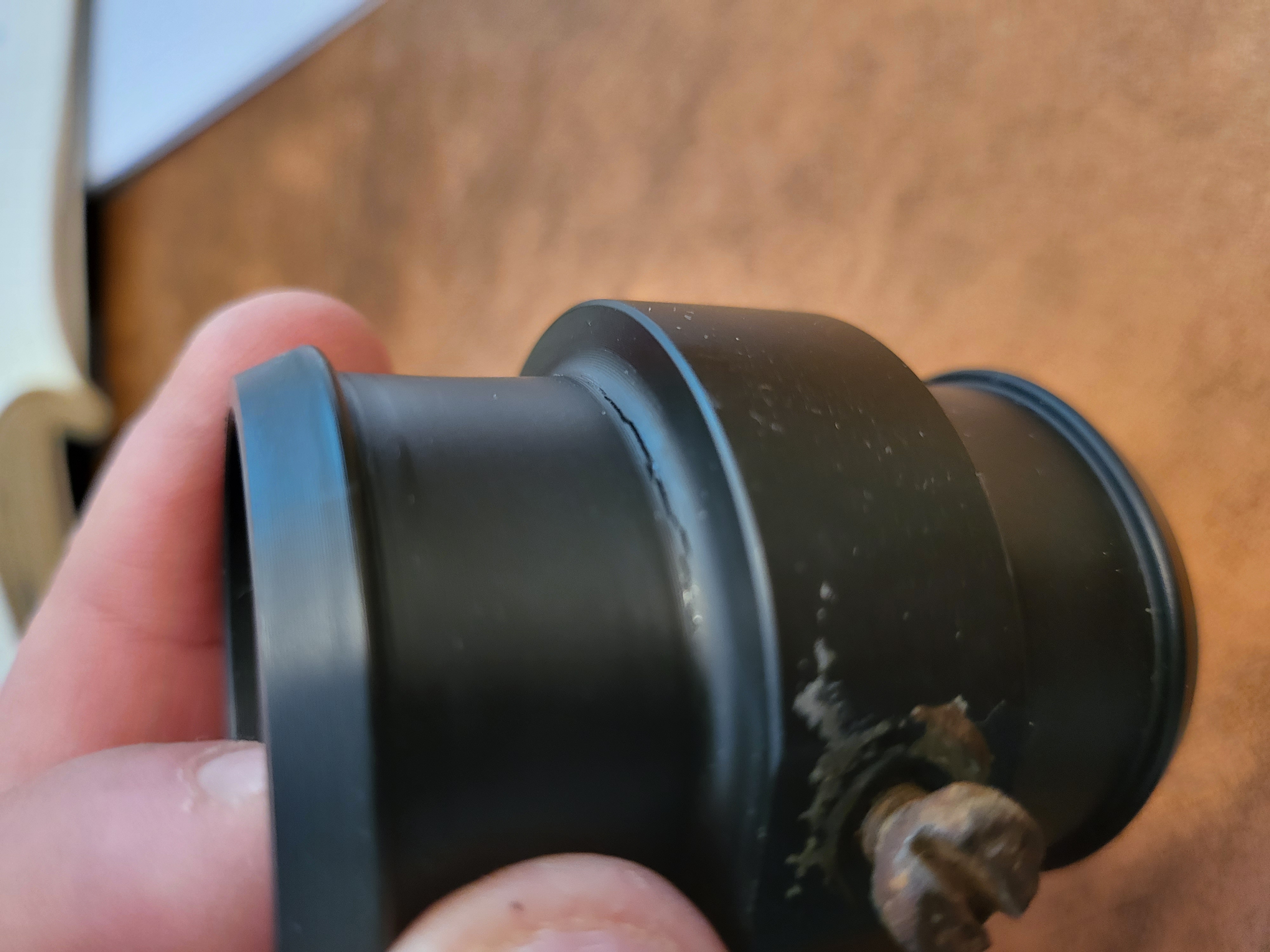

Hi guys,
Okay. Issue identified.
Second pic shows the crack in the coolant loss sensor adapter housing. Crack is also visible from the inside. The crack is consistent with the leak.
The likely cause of the adapator cracking is apparent from the first picture. The hose ID is 33mm. Must have taken some force to push it all together. I stopped using the mechanic in question after my first experience with him when several items had been (very) shoddily carried out. This would seem to be another such instance, though I admit that it is debateable.
Looks like fitting a new adapter should solve the issue. I have the new hose as well but may just keep it spare for now.
