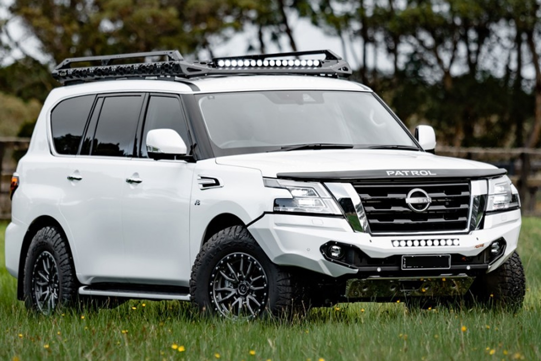

I got the RHINO EVOLUTION 3D bar in johannesburg. It comes with a led bar which is incorporated in the bar as well as a bash plate. The Bullbar should be in namibia next week. I also got the 12000lb winch from them.

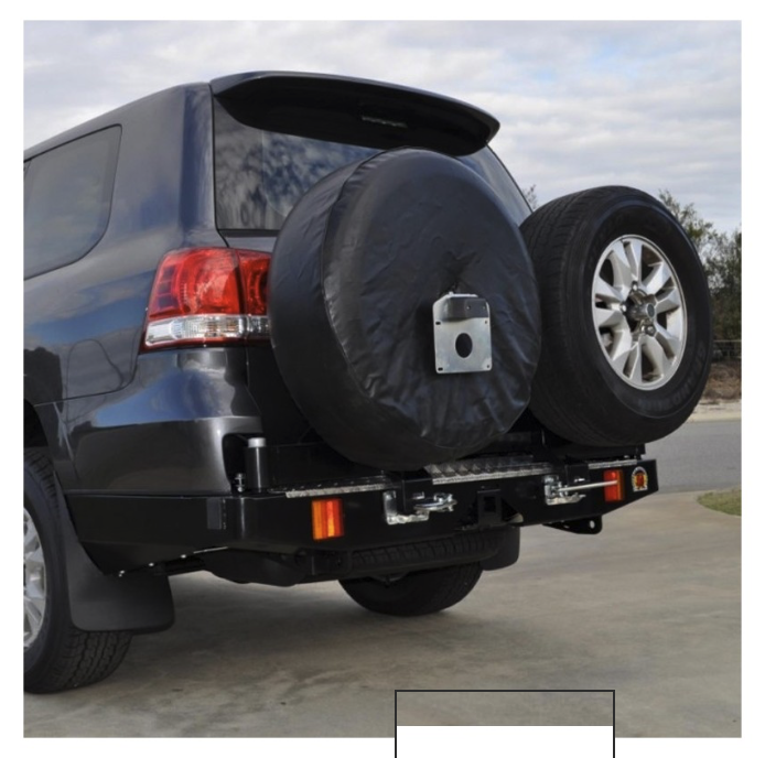

For the rear i am looking for a twin spare wheel carrier since i want to fit an additional 120lt tank under the car where the spare wheel currently sits. For this i will get the outback accessories rear carrier which can take up to 2x 35" tires.
Roofrack i am getting the Frontrunner.

So I installed the rhino winch and bullbar. Other parts are purchased and on their way from Australia.
