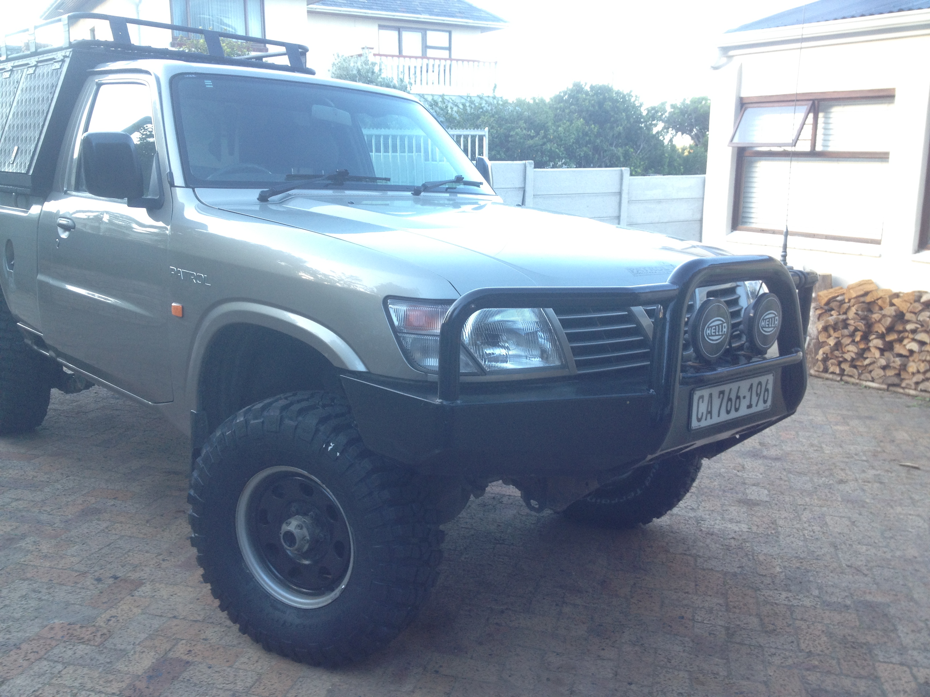

Re: Patrol Pickup 4.2D Tyres......advice?!
285x75x16 on my Nissan Patrol Rims 16'' 6.5j. 0 offset.
ok thanks. I see you did mention your rim size in an earlier post. I was not paying attention.
Does the bigger diameter not effect the gearing in a negative way with regards to power.? I see the land cruiser guys recon that they loose too much power with this size.
I have also read that the cruiser 4.2 is more of a donkey than the patrol 4.2, is this true?
Ps you got a good looking bakkie. What bumper do you have there?
That bumper is to high on top if you have a turbo and intercooler because the air will not get to the intercooler hole - Ricster had to change his hole cover because of this bumper issue!
