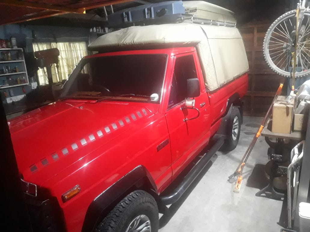

Those pics belong under the Patrol Porn thread. That is super nice.

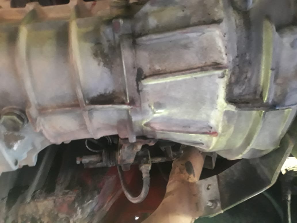

Tinus lotz wrote: 28 Jan 2020 06:17 Jip is coupled to a 5 speed cresida box .
So only 4x2?
Re: RD28 Turbo options
Nee ou het mos n los transfer case mach net prop op

Tinus lotz wrote: 28 Jan 2020 07:57 Nee ou het mos n los transfer case mach net prop op
Ja ek het na my post besef ons praat van 'n Safari...... :rolleyes:

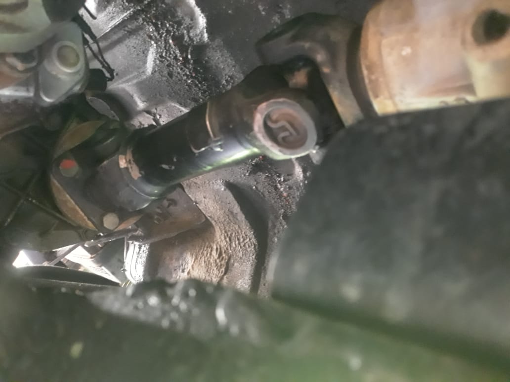

Its a cressida box belhousing welded to a zd30 box belhousing so that the td27 can bolt straight on . And then the propshaft to the transfer case one side toy one side nissan
