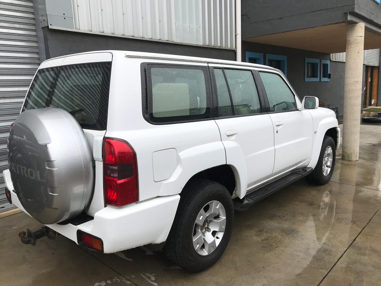

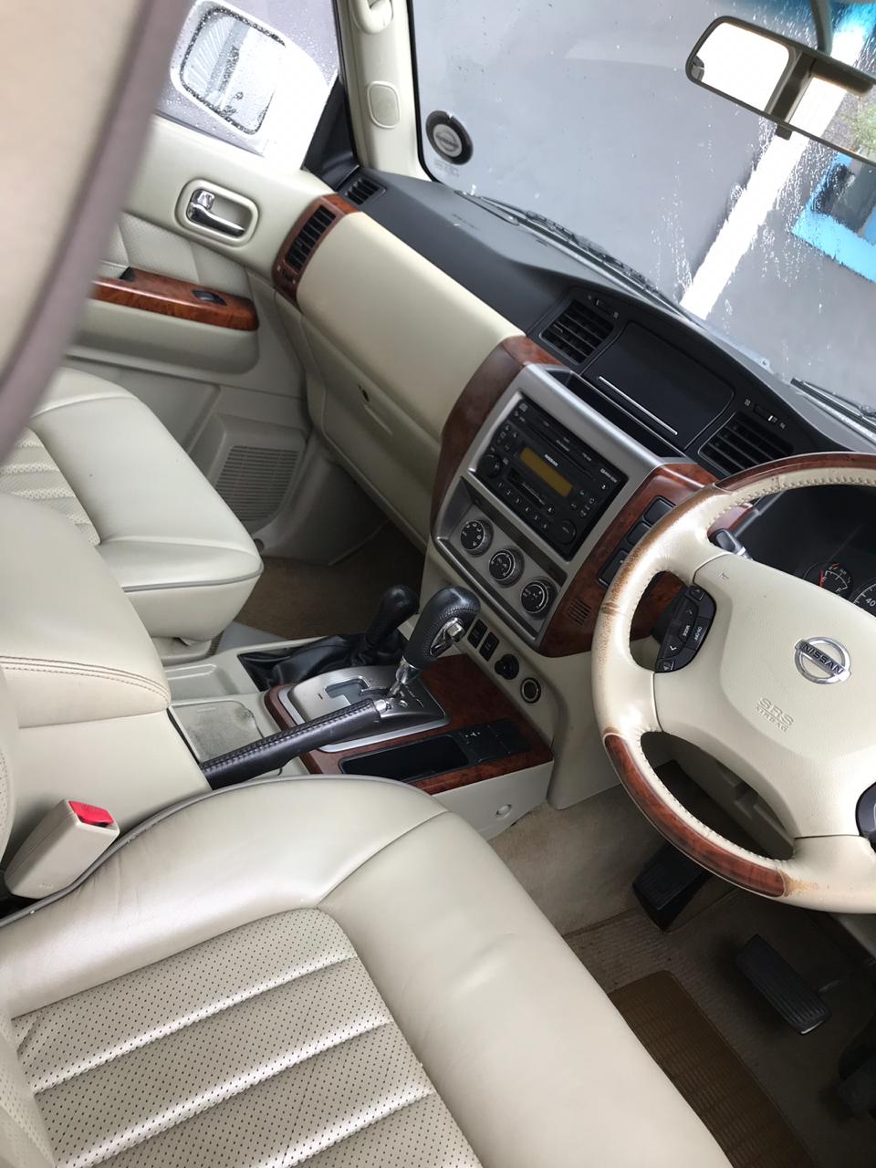

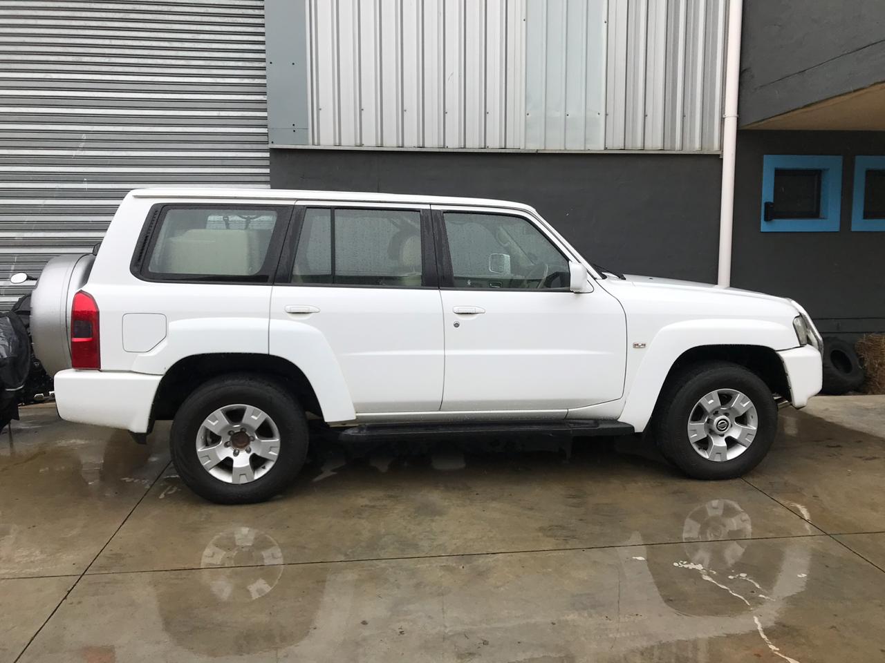

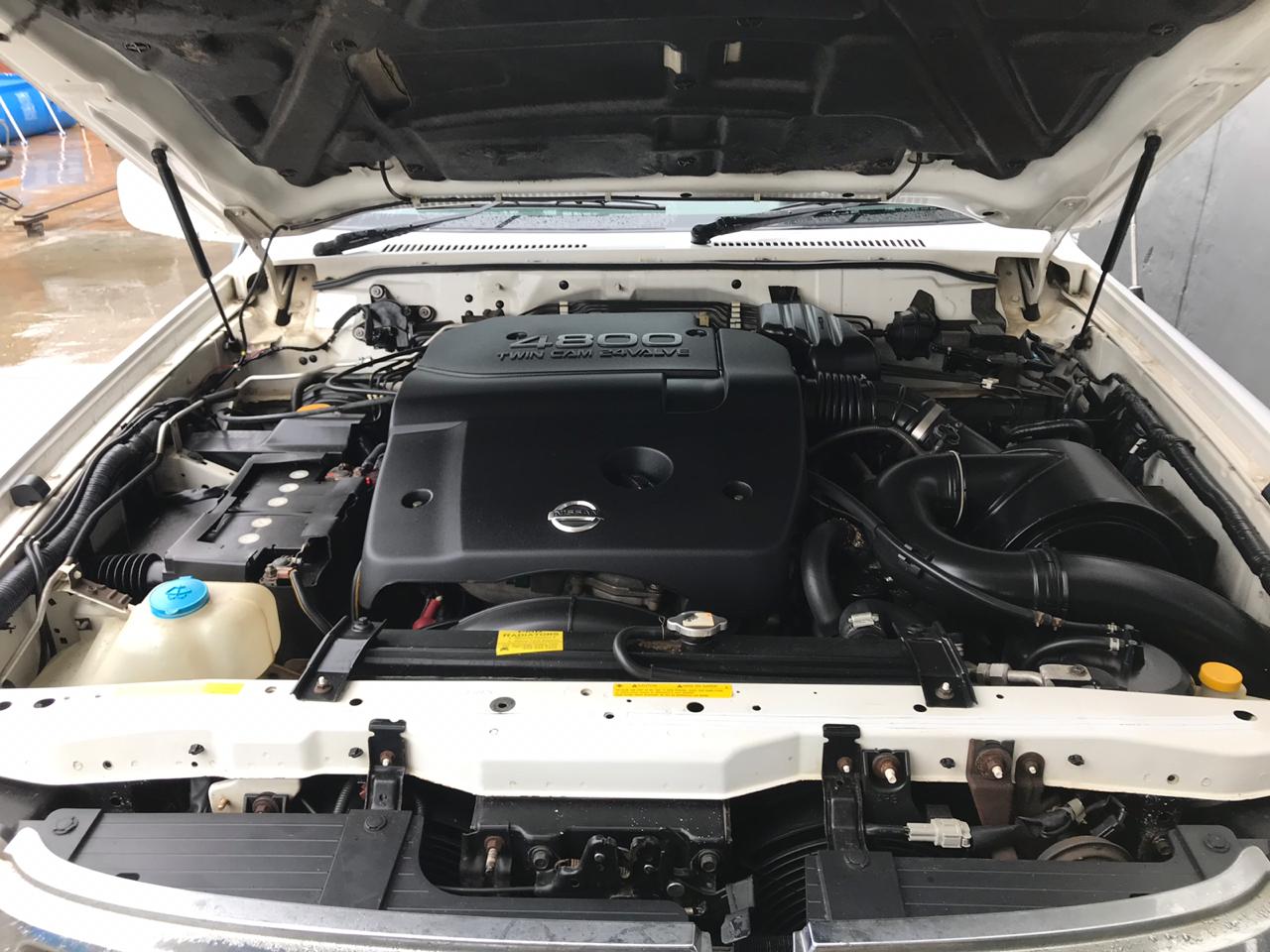

These are some photos of the 4.8 I’m looking at
- 0E738C93-F4E0-4940-B906-250C00FC04AE.jpeg (155.2 KiB) Viewed 5895 times
- FE9DB154-A257-4C52-A687-568F051038C5.jpeg (135.91 KiB) Viewed 5895 times
- 9DDBAAD1-24E6-4019-8793-F856CCAC11E6.jpeg (143.14 KiB) Viewed 5895 times
- 79BE7FDF-55BA-4C75-A3AA-759DD880E61E.jpeg (130.19 KiB) Viewed 5895 times

That one in the pic looks standard with auto hubs.

In the pics you posted, I can see that somebody moved the rear hub caps to the front wheels, hiding the hubs.
It should, as Cedric mentioned, have auto locking hubs. These hubs do have a "manual override", IE you can (using the wheel spanner) lock the hubs manually, although you cannot un-lock them manually. The fact that this one's hub caps are swopped makes me believe it probably has the auto hubs, as one can't access the hubs to lock them now.

The water must be blue or green. There must be no sign of rust in the radiator or it's expansion tank. If the water is brown from rust, walk away. As for the gearbox oil, if it has a dipstick, it's easy. Pull it out, look and smell the oil. It must be red, not black, and it must not smell burnt.
If it doesn't have a dipstick, then unfortunately one has to either un-screw the drain plug (carefully, so as to get just a couple of drops of oil), or release the hose between the gearbox and it's oil cooler and get a little bit of oil from there. Not sure if they will let you do that.
