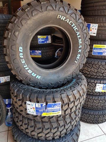

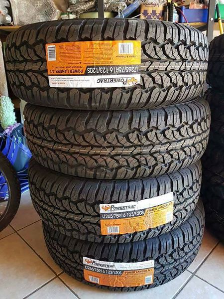

It's the first I have heard of them but they look like they are gaining traction (Kagiso II wrote: ↑09 Jan 2018 11:36 Dis n FACEBOOK Advertensie wat Martin gereeld plaas:

LT 285/75R16 M/T PRACTICALMAX R 1990.00 ex vat
225/45ZR17 SPORTMAX R 800.00 ex vat...
Apocolypse of 4x4community is serious offroader and swears by them:
Off Topic
yup.
very happy with them - very very good in fact.
I'd rate them over some of the far more expensive makes. Good road traction, good wet weather performance, very good on dirt , deep water and mud .
So far they seem to be wearing well too.
the only catch is that the sidewalls seem softer than heavier muds - but it hasn't been an issue to date.

Anthony got a set, he has had many punctures and lost a sidewall on the river trip (goedkoop is duurkoopbiggles wrote: ↑09 Jan 2018 13:30
It's the first I have heard of them but they look like they are gaining traction () on the 4x4community forum.
Apocolypse of 4x4community is serious offroader and swears by them:Off Topicyup.
Anthony Forgey;3760565 wrote:I've had the powertrac MT's for 7500km or so now.
they have very good grip both on and off road.
I've had a lot of thorn punctures though. They are like thorn magnets. I think I'm on at 10 punctures or so, all in the bush. Plugged with snotty's and carry on. The one tyre with the torn sidewall from the river trip has been repaired by a vulcanizing place and is the spare at the moment.
