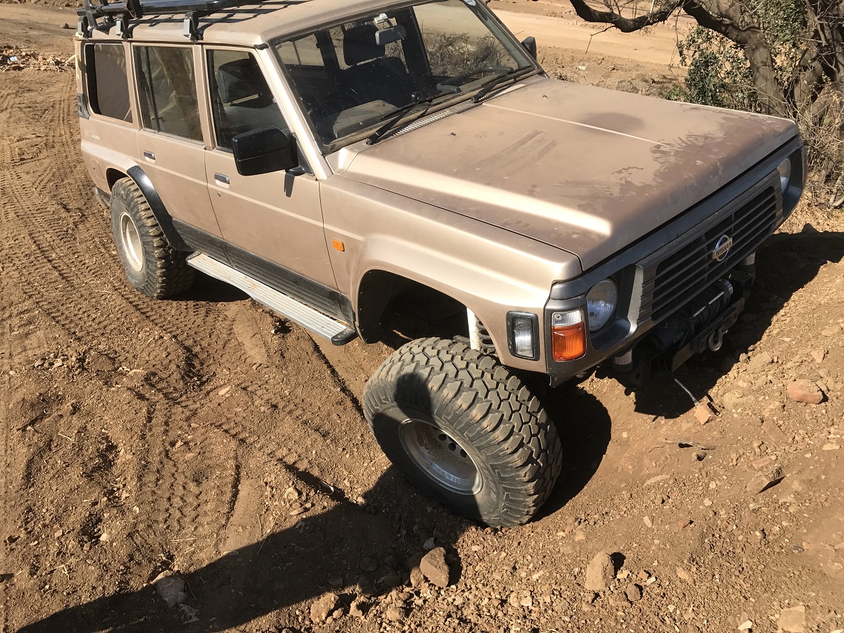

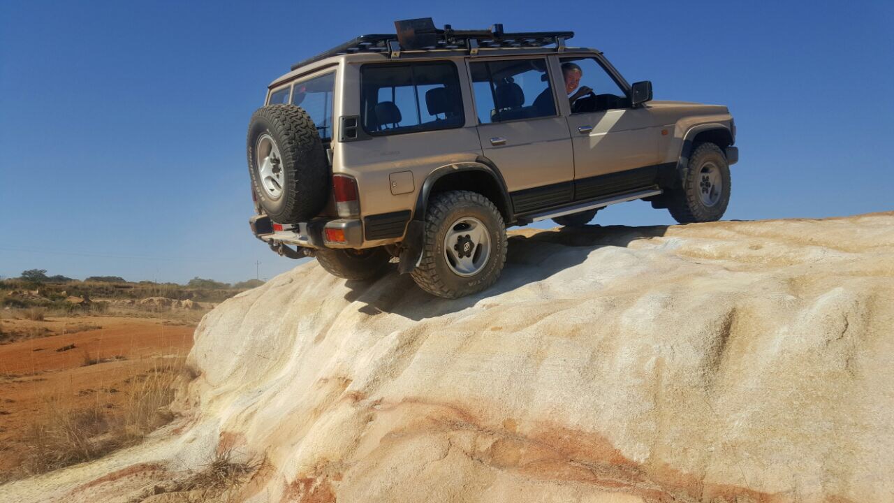

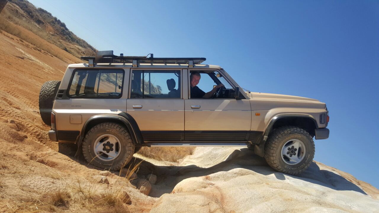

So a few things have happned in the past few weeks, not a lot but enough to justify an update. Firstly I bought some 33" from Tinus.
Sandwane Klip
Sandwane Klip
For the moment 33" are awesome, a huge improvement offroad from the 31" road tires. 1st and 2nd gears are much more usable due to the increased rev range in them but 3rd gear onwards you start to feel the big tires. I had a diff hum, changed oils and it improved a bit but when I checked my old tires I had different sizes on the back which caused the diff to permanently work an one could immagine with a LSD that is not ideal. Since putting on the same size tires the hum has almost completely disappeared, so much so that anyone other than me who knows what noises to listen for at what times would not know of it. But unfortunately it has developed vibration from 100km/h onwards. I am still not sure if it is the tires or some other bush or component. Since the previous owner drove it so little for so long and suddenly it falls into my hands and has clocked a few km already maybe some rubbers or buses are tired, I am not looking forward to just keep replacing parts and hope the shake goes away.

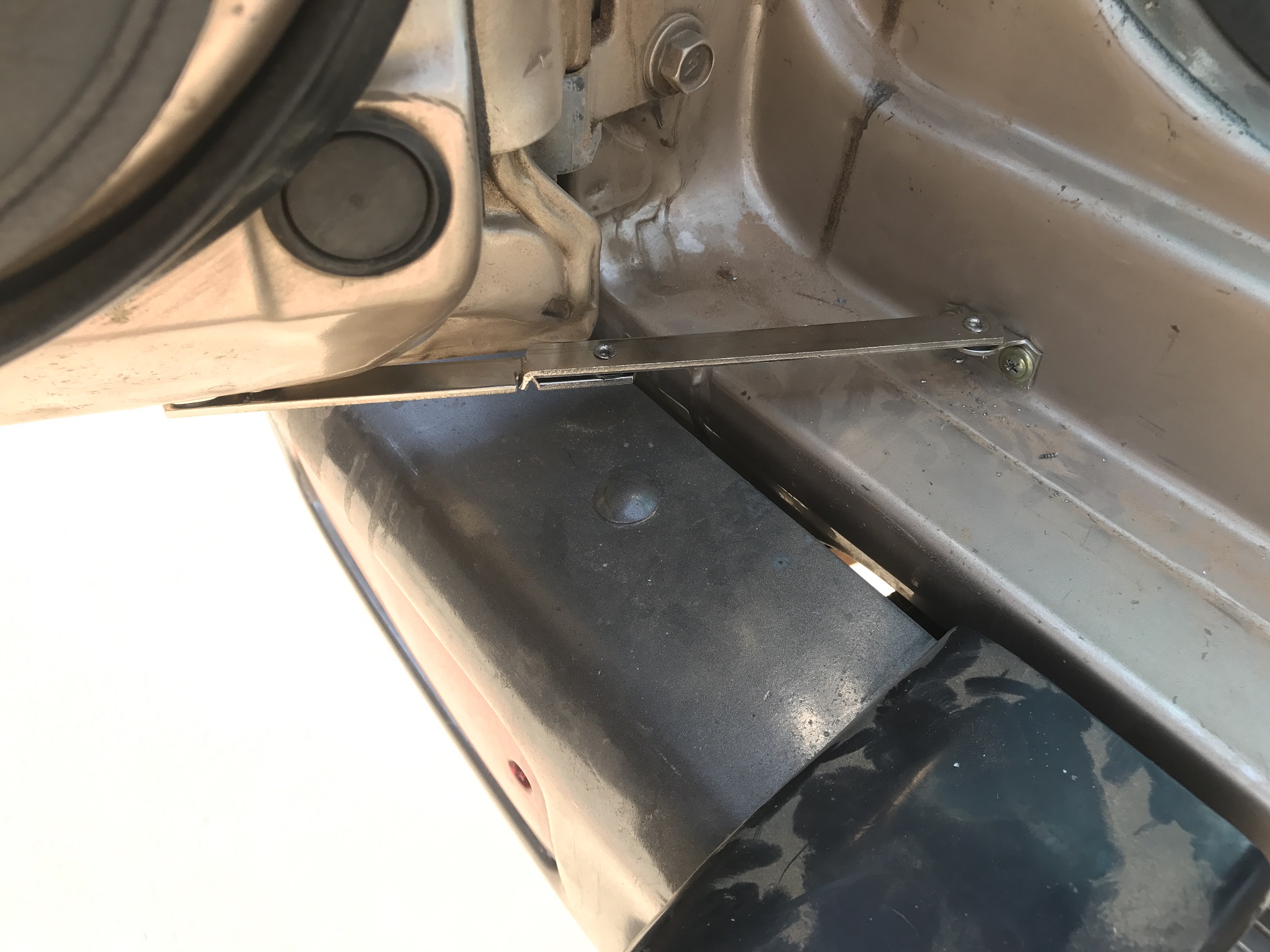

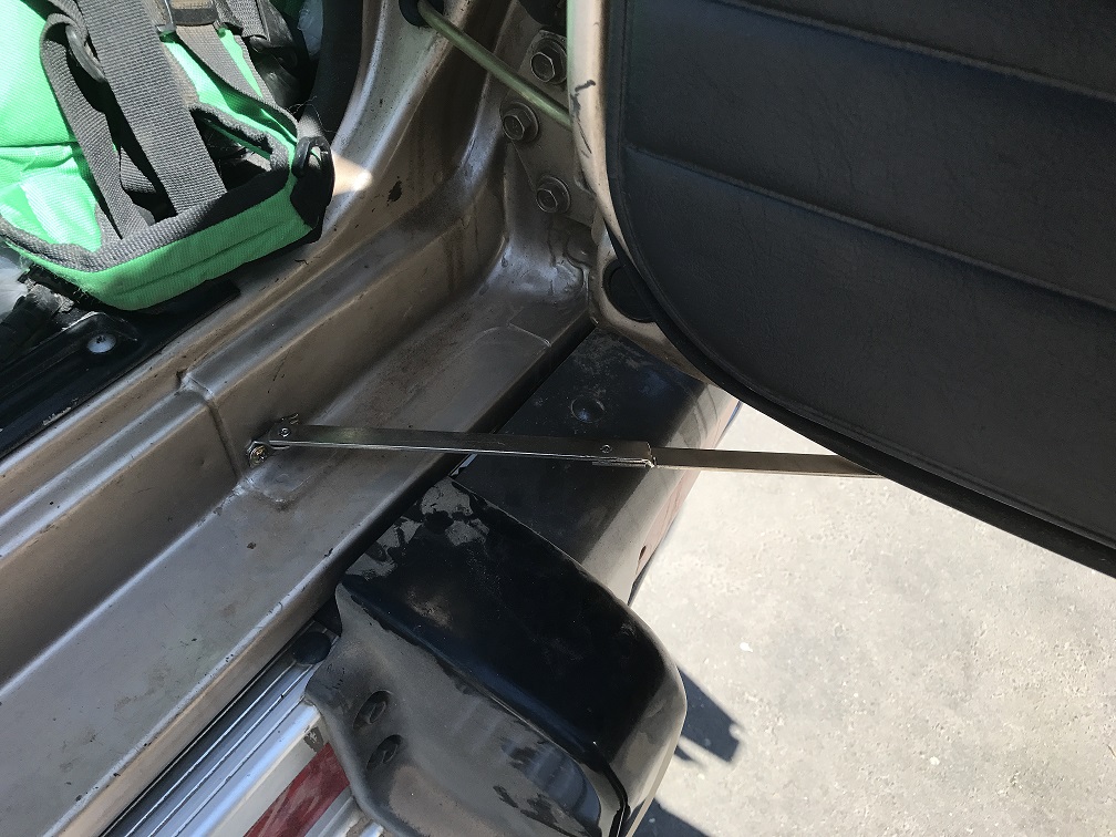

Yesterday I made a few modifications just for comfort and ease of use.
The first being some struts for the rear barn doors. The GU's have a lockable strut on the open position but he older GQ's have no such function. On my previous GU installed a gas strut on the smaller door but the strut I had was very strong and surprised a few unwilling participants.
Small barn door
Small barn door
Big barn door
Big barn door
All I want is for the doors to stay open in wind or on an incline. Just remember to release them if engaged otherwise the will bend if you forget and force the doors (Dis maar wat ek hoor :doh: )
Parts required:
Acquired from Canopy center Silverton
1/ Stay-Folding Stay (115mm)
1/ Stay-Folding Stay (152mm)
8/ Self Tapping screws
10 minutes
If someone requires dimensions I will post it but I found just make sure both mounting points are more or less the same distance from the pivot point of the door.
I also bought some of the center console and dashboard switch blanks from them, Fits GU and GQ

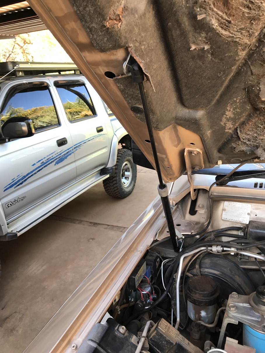

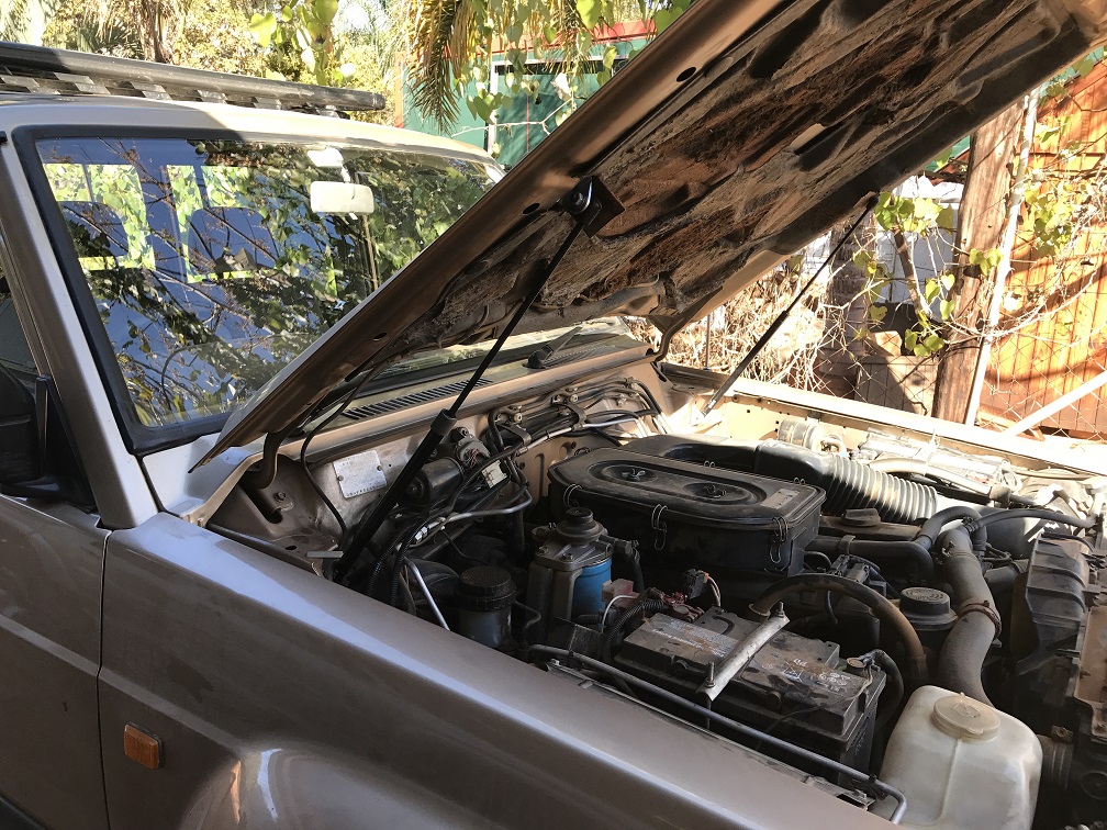

I also installed some gas struts in the bonnet because I enjoyed them on the GU. Parts and Dimensions will be in a separate thread.
http://patrol4x4.co.za/viewtopic.php?f=56&t=7250

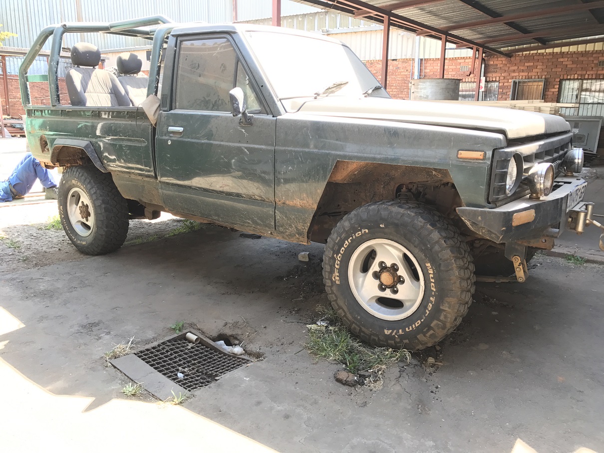

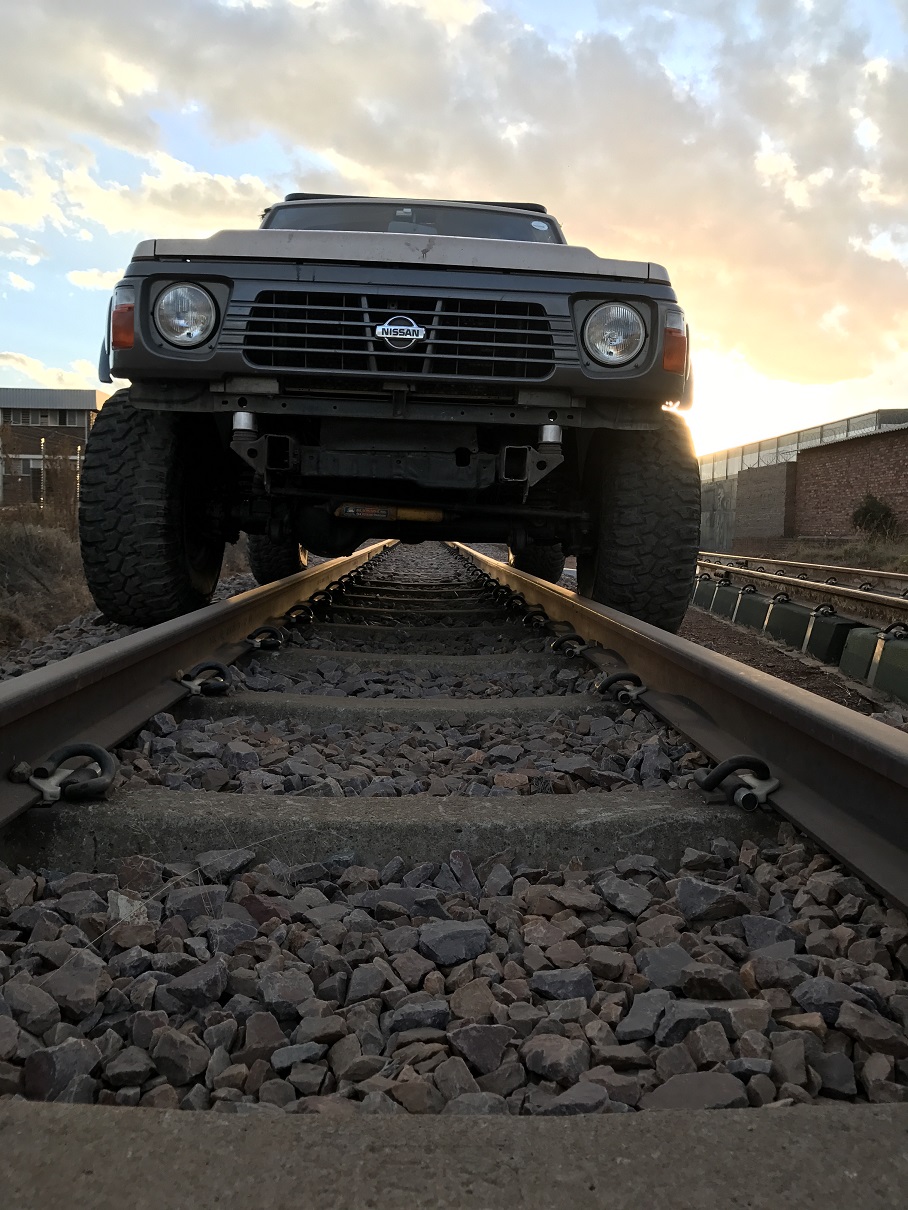

So after the river trip there was a few things I wanted to change and start preparing for December. Had a few incidents on the trip but luckily noting incapacitating: The back of the vehicle slid into a tree branch and broke only one of the rear widows, so first on the list is gullwings :blonde: .
Had a problem with a tire puncture that turned into a delamination and exploded, Luckily while trying to repair so nobody got hurt (get a Tire pressure monitoring system :mytwocents: ) So I "Libertated" some 35" tires from my Dad's Safari and because of the 2" suspension lift and 2" body lift made it work by removing some tupperware and spacing the front diff at the rear of the radius arms forward by 14mm. I also fitted the winch but stil have to do the wiring. I am very glad to have traveled with the Patrol guys because if I was alone I would have had to put my dodgy spare wheel on and would have driven home at 20km/h. Thanks Tinus, Dave and Oom Etienne for the help :salute:

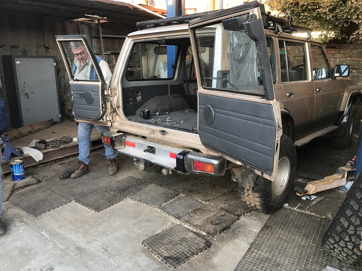

I removed my rear doors to modify the hinges so that they can open 180 degrees in preparation for the drawer system. Hopefully I will be able to install the hinges within the next two weeks and hope it works but still have to figure out some kind of open lock so they don't swing around and damage any body work.
Wider Opening Patrol GQ Barn doors test

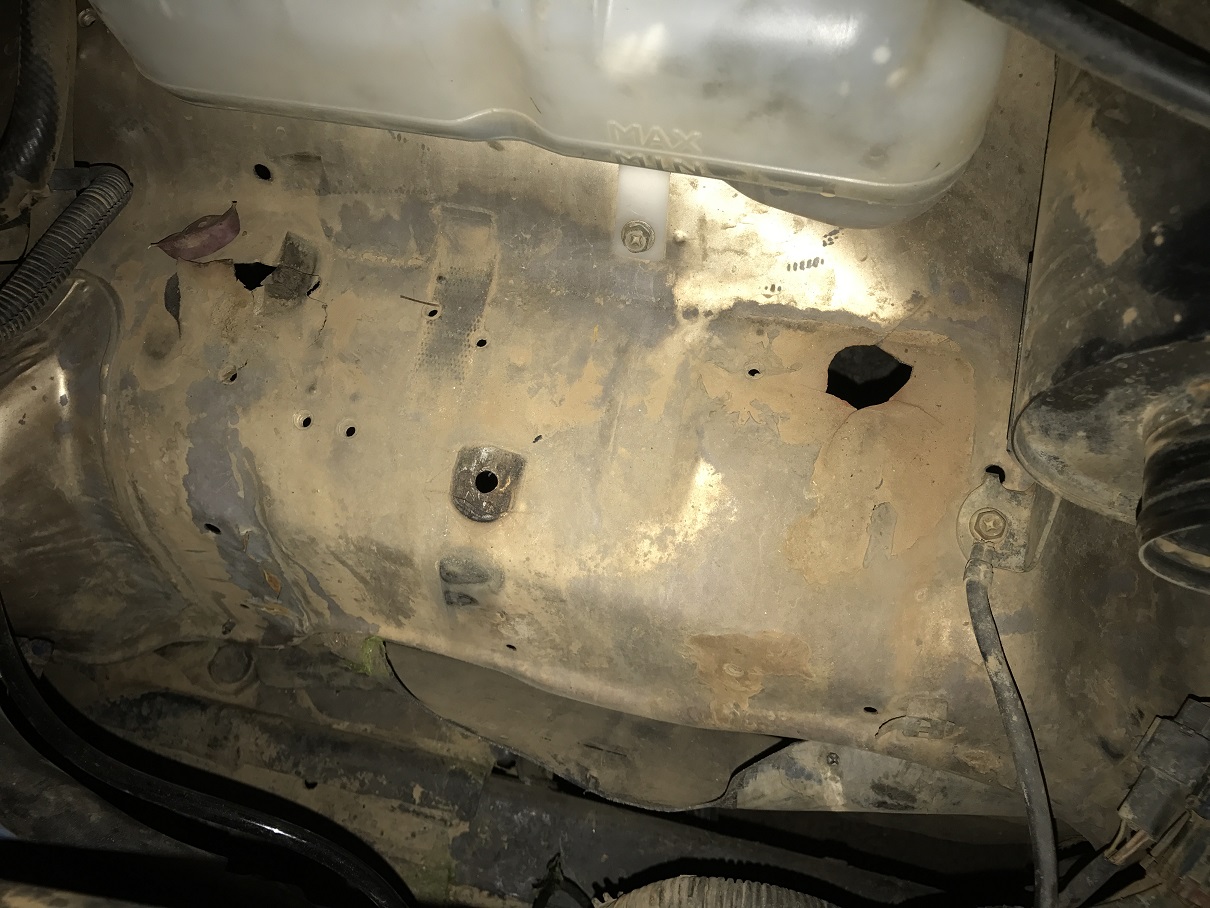

Also, if you have a badly mounted second battery just remove it because it can cause some serious damage to the wheel well. :mytwocents:
Second Battery wheel well damage

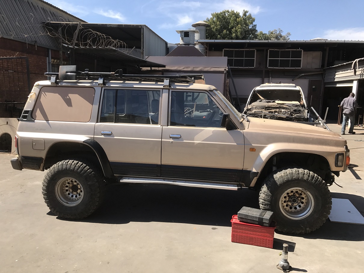

Dankie, Hy het die oorspronklike vere vervang met jeep vere en die shackle mounting punte op die chassis verleng met 100mm. Ongelukkig mes hy die voorste venders chop.
Die arme Safari lyk nou bietjie sad met my 33" op en is bietjie verwaarloos, hy sal eendag weer aandag kry maar op die oomlik is daai lexus nie n mens se maat nie.
Arme Safari op 33"
