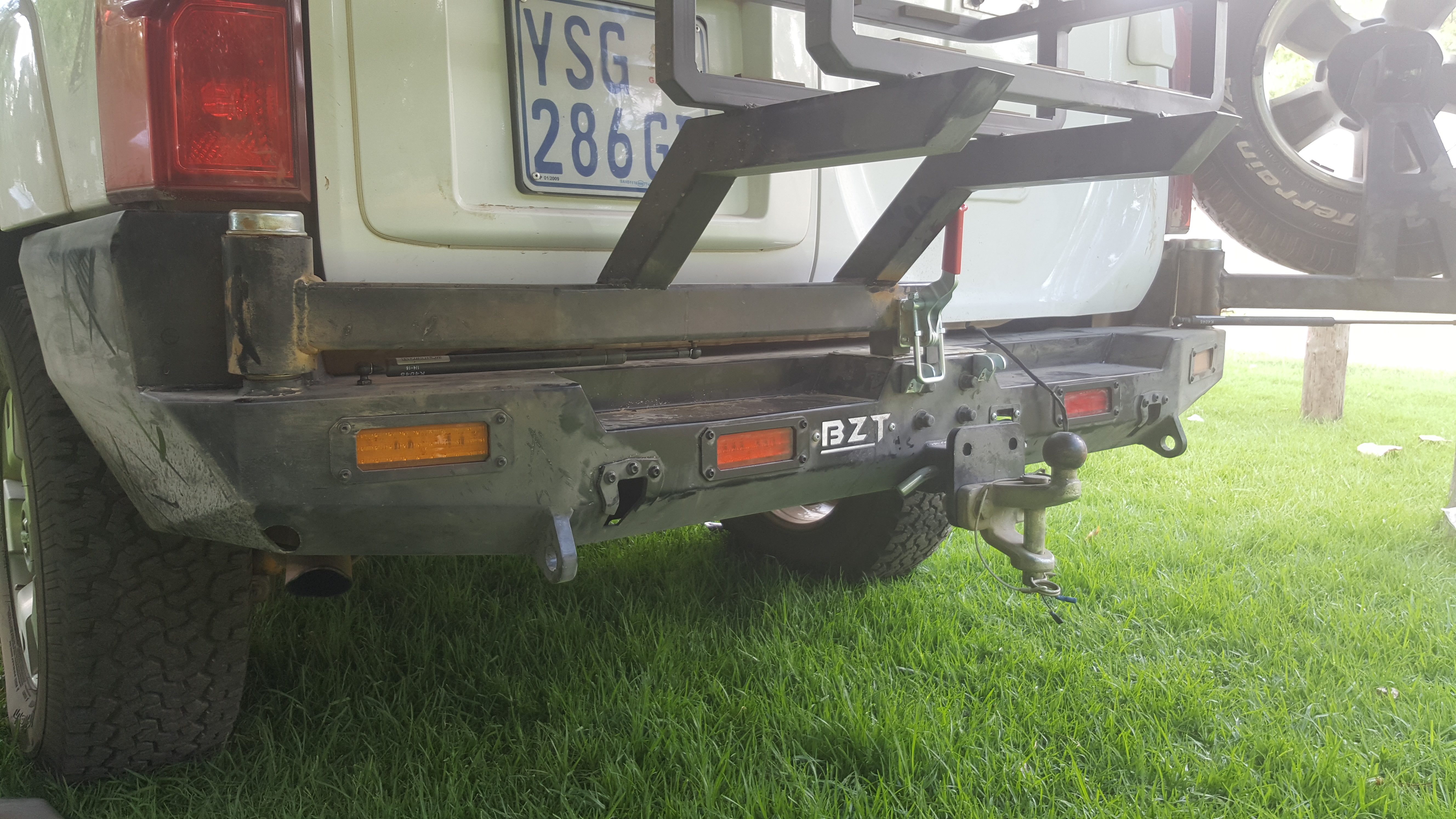

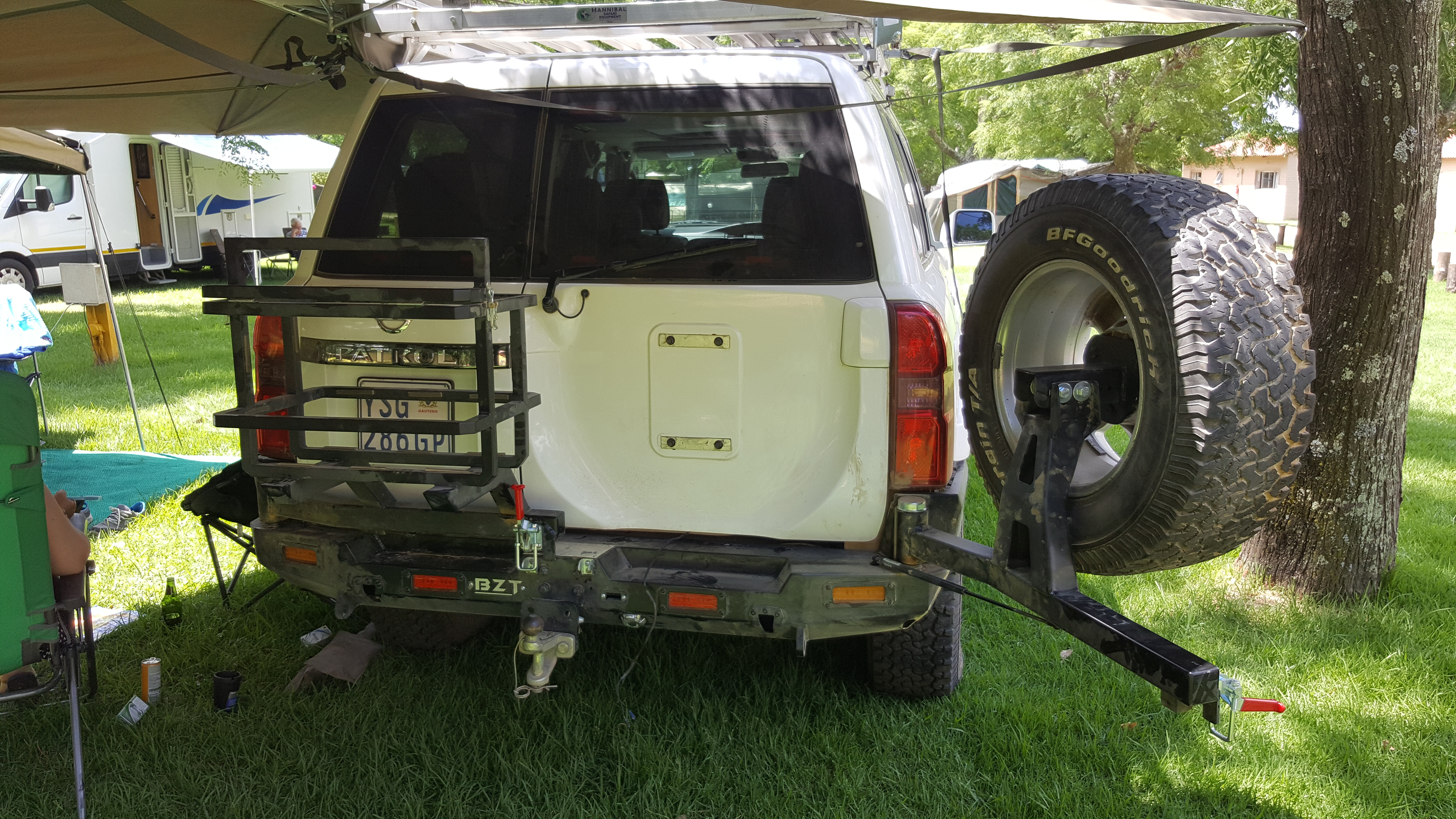

Re: Patrol Rear Steel Bumper
Summit fitted the bumper for me and very HAPPY
Things I like:
It uses the 4 chassis mounted bolts to hold the bumper and means there is very little flex on the tow hitch. With a drop plate there are huge forces on bumper integrated tow hitchs. Usually requiring gussets to be welded in, not with this one.
Bearings for the swing arms.
Recovery pionts are opposite the chassis bolts.
Openings so stones, and mud dont collect in the bumper
Gas pistons holding the arms open and limiting the travel.
It looks good.
Built like a brick s^% house
Things I like:
It looks good.

- Been thanked: 432 times
Very nice!
Personnally I do not think the recovery points are strong enough. But it is my opinion. I fitted Tinus' recovery point in the centre to make sure but would still like PC to check it out before I will attempt a recovery.
