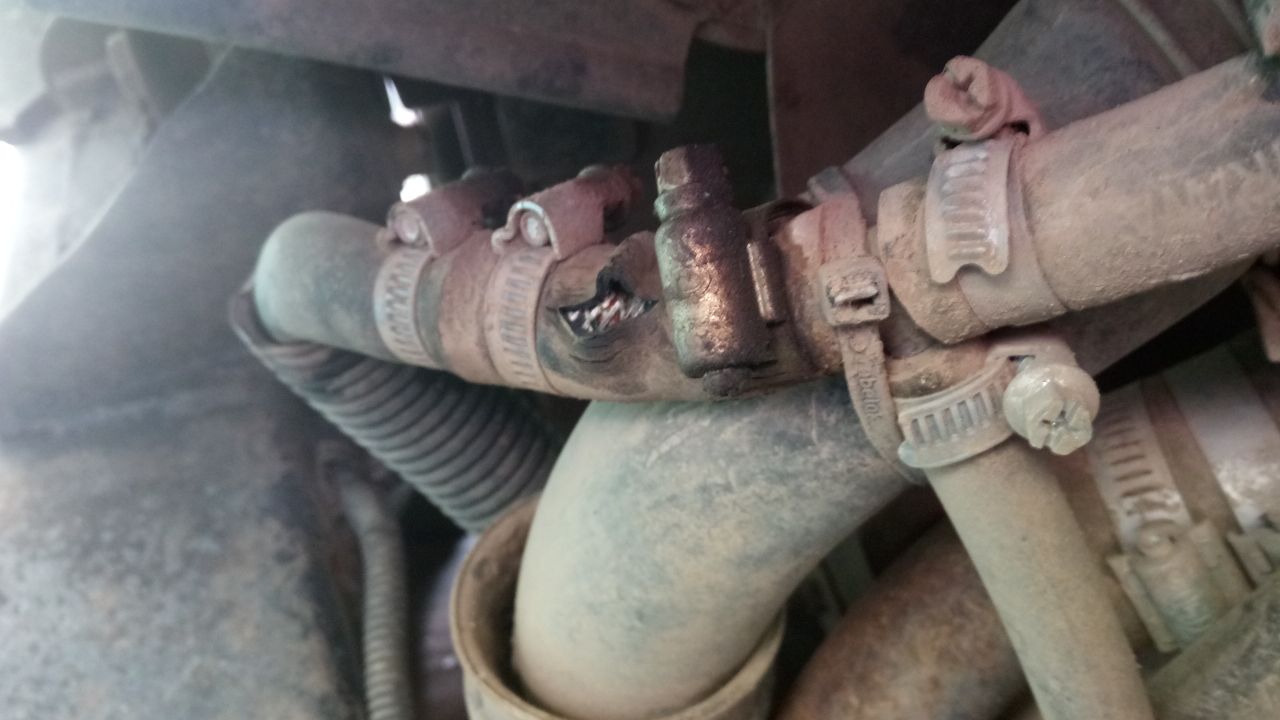

Aux tank.jpg (85.77 KiB) Viewed 8974 times
Warning for the guys with the aftermarket 60/65 L tanks.
No idea if they all came from the same place or store chain but the quality and fitment of the piping on mine is not good and we do not want our Patrols to do "a Kuga".
Have done a temporary fix for the dune trip and will be redoing everything after.

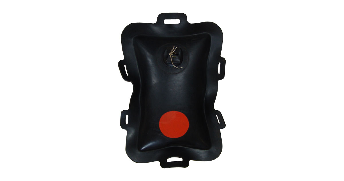

So hier is die outjie waarna ek oorspronklik opsoek na was....
https://www.southafricanmilitarysurplus ... -tank-new/
