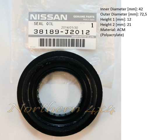

Today the guys at Autozone eventually got back to me on the replacement of the pinion seal...
H260 rear seal with text.jpg (58.75 KiB) Viewed 4406 times
All of R50 and the order is in, should be here next week Wednesday.

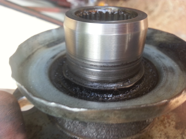

This weekend I got to pull the pinion Flange to find this..
I checked it with a straight edge and vernier and don't see that it has got any "smaller", but it is rough and will probably eat up my new seal. I took to it with a bit of fine water paper, but I can't make a mark on it.
What is the chance that someone has something like this laying about, or know where I can pick one up. Can I have this it turned on a lathe, and how much have I got to work with before it no longer seals to the oil seal? Am I going to weaken it too much by turning it down slightly and adding a collar to get it back to the correct diameter for the seal?

Rather weld up up.and re-machine than sleeving, but use guys who do this stuff for a living, as it will have to be re-heat-treated...
