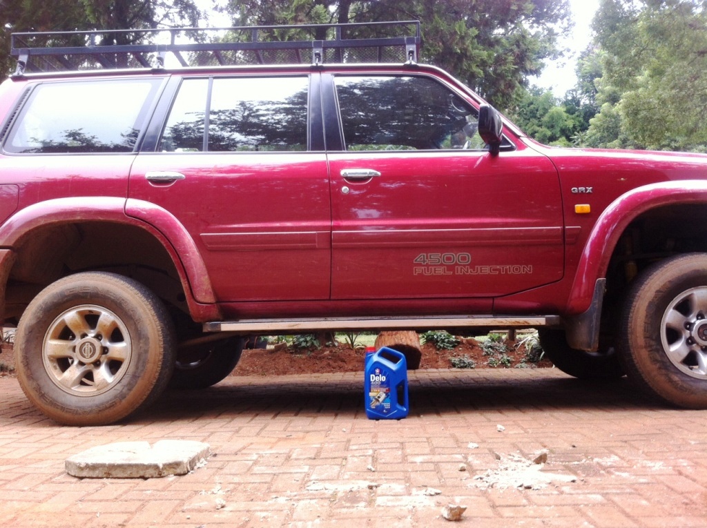

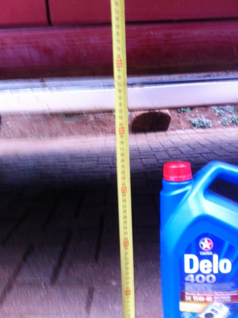

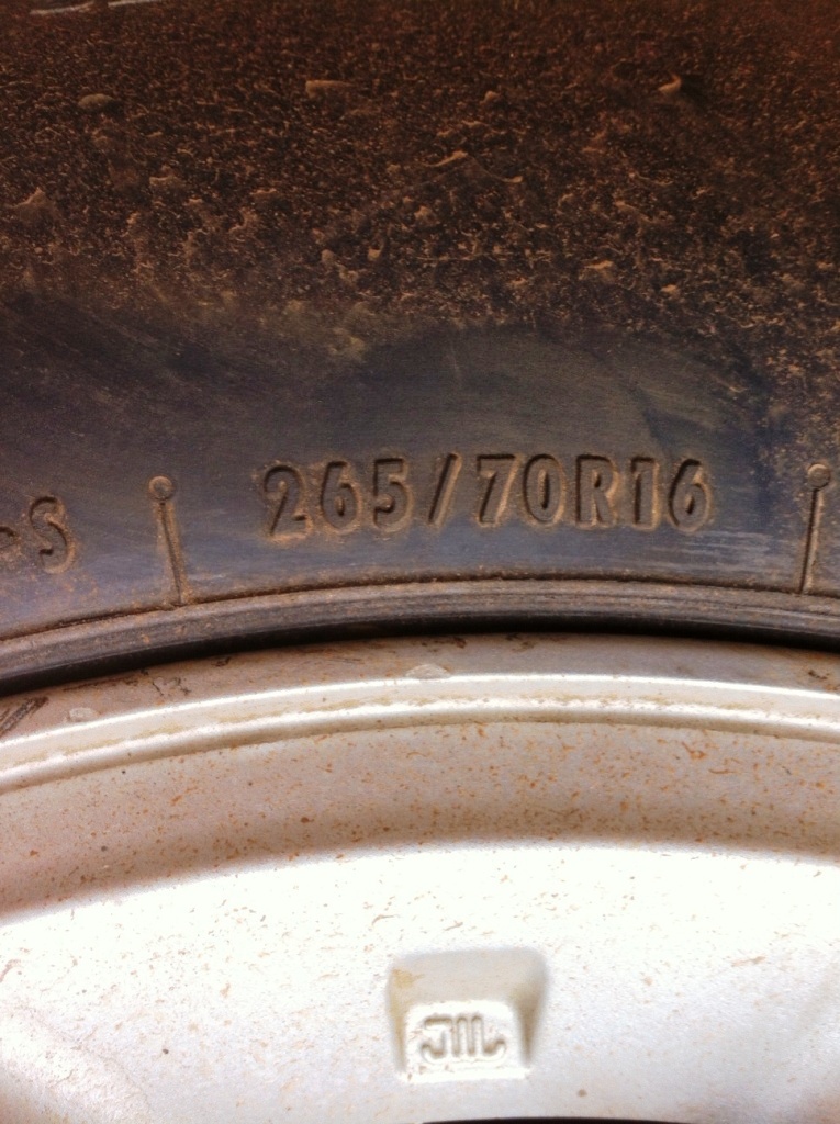

Hoeveel skat julle hierdie lift(Old man Emu), lyk vir my na meer as 'n 5cm lift? . Dis met 265/70r16 bande op.
43cm tot by die side steps.

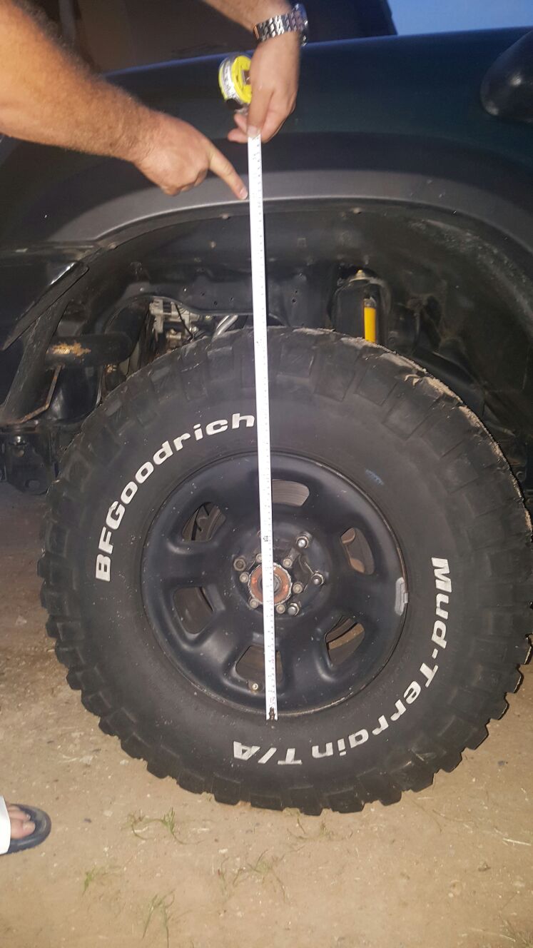

Fanus ou, n mens meet lift van die onder punt van die mag. Deur die centre van die hub. Tot waar die wheel arch begin. Op die manier maak band grote nie saak nie.

So.......
En as dit n 17 duim rim later raak of n 15 duim dan tel jy net 1.75cm by of trek 1.75mm af

Hahaha, ja dis seker so. wou nou nie te tegnies raak nie, is maar net beindruk met die "break over angle" en die hoogte van die voertuig. My bakkie lyk verskriklik plat langs die nuwe trol... sal plan moet maak.JoshJ wrote:Fanus ou, n mens meet lift van die onder punt van die mag. Deur die centre van die hub. Tot waar die wheel arch begin. Op die manier maak band grote nie saak nie.
Sal die wiel/arch meet en terug rapporteer.

I guess that Fanus thinks that the OEM suspension gives him quite a bit of ground clearance without being sure what a comparable measurement of a standard vehicle would be.
Joshuas way of measuring is the way it is done in order to determine the suspension height before and after new springs/ shocks have been fitted.
To Fanus:
Mine is a standard 2001 / 4.5
I recently fitted 4.8 oils (which had about 80 tkm on) + Rancho shocks (meant for standard vehicle heights)
So... all fairly standard. Same tyres than yours / 265 / 70 / 16; Tanks 80% full no other extras.
My measurement on the same spot were you measured is 36 cm.
This would mean that your Patrol is approximately 7 cm higher than my standard vehicle.
give or take...

SJC wrote:Hahaha, ja dis seker so. wou nou nie te tegnies raak nie, is maar net beindruk met die "break over angle" en die hoogte van die voertuig. My bakkie lyk verskriklik plat langs die nuwe trol... sal plan moet maak.JoshJ wrote:Fanus ou, n mens meet lift van die onder punt van die mag. Deur die centre van die hub. Tot waar die wheel arch begin. Op die manier maak band grote nie saak nie.
Tinus se bakkie meet soos ek meet 860mm met n 2inch lift......................................sonder n motor. Haal net jou motor uit

Thanks for the info.Picasso wrote: Mine is a standard 2001 / 4.5
give or take...
Bottom of rim to wheel arch varies from 83-85cm.
(Front 83-84, rear 84-85)

My bakkie meet 80cm agter, 75-76 voor.JoshJ wrote: Tinus se bakkie meet soos ek meet 860mm met n 2inch lift......................................sonder n motor. Haal net jou motor uit![]()
instant mega lift.
