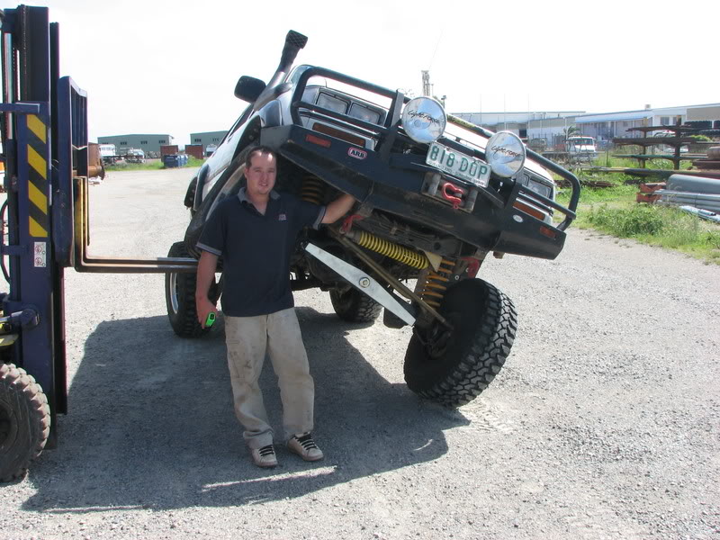

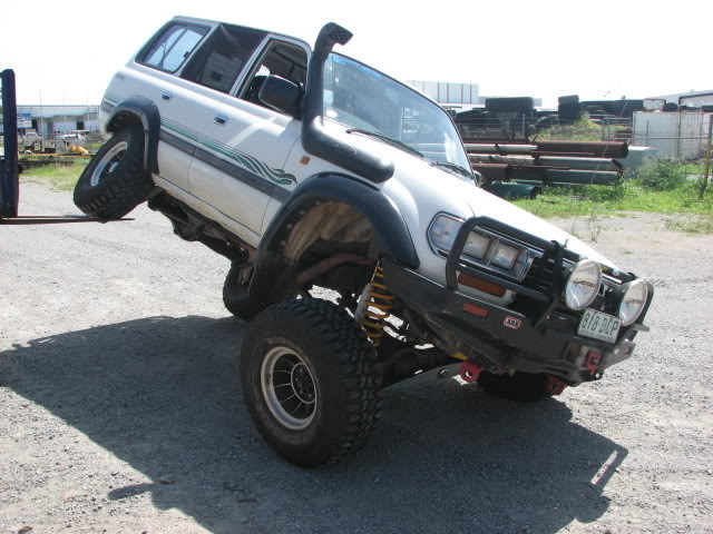

Ek hoop ons eindig op met hierdie tipe flex
- afterxlink7.jpg (119.05 KiB) Viewed 11796 times
- afterxlink5.jpg (81.1 KiB) Viewed 11796 times

Peter - jy moet begin "develop" boet - die manne soek nou serious flex

Re: My guilty secret
I wonder if martyn knows how far back in the qui he ismartyn wrote:Peter. I volunteer my Patrol as a test vehicle. Except I haven't driven her for so long she tries to kick me when I walk past her.
This is incredible! Please put me in the queue for this mod too. This would take the GQ shorty to a next level.
Queue?
For these things okes will be swinging handbags to get paws on parts!
I'm sure it'll be worth the wait.
I'm in for sure...
I'm in for sure...
