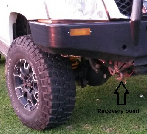

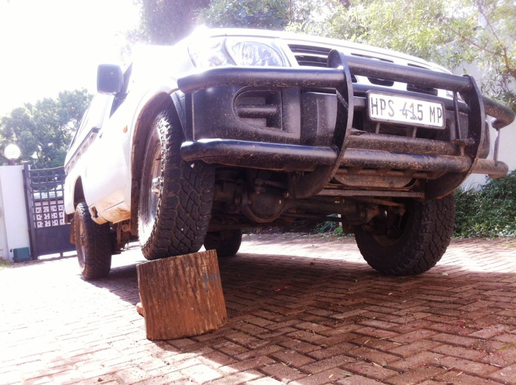

I noticed that there is no recovery point on front of my vehicle. Not sure what the standard setup is, but I'm guessing that they used the recovery points to attach the wrap around bull-bar to. I'm actually considering removing this bullbar as it does nothing for the approach angle....alternatively I must attach recovery points to the bullbar, but I dont know if the bullbar would be strong enough?

Ja eish, the recovery points must come on to the chassis other wise you will risk safety when recovering. The bullbar does decrease aproach angle but it helps for bumps. Best of both would be a full bullbar then you can have aproach angle, bump stuff and just bolt the recovery points back onto the chassis. :mytwocents:

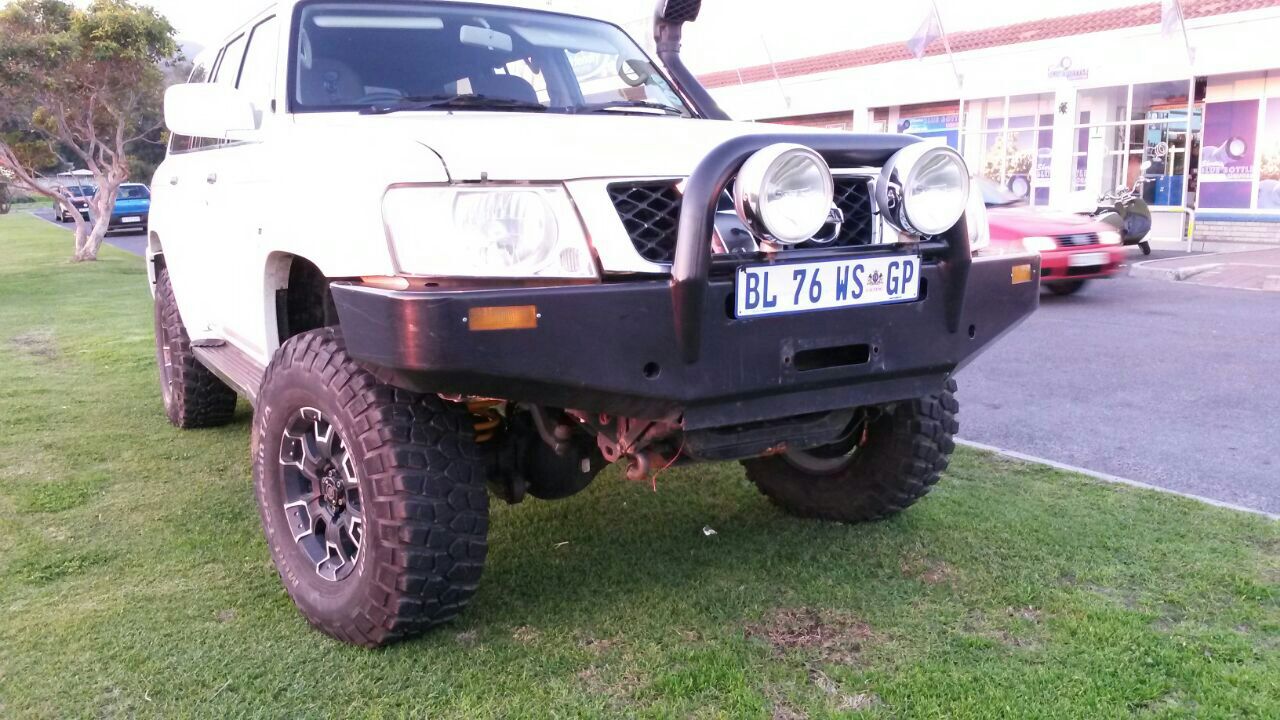

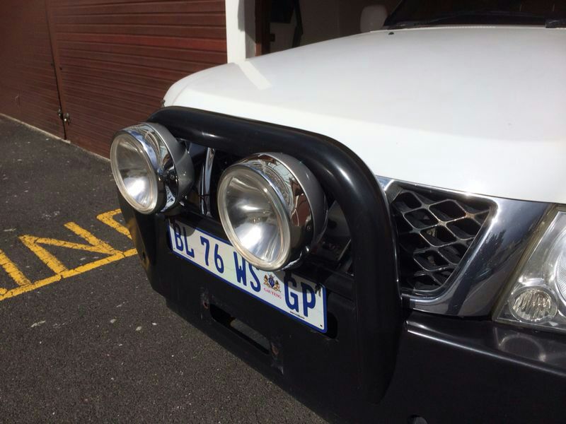

This bullbar is availible for 6.5K. Speak to Tinus. Its a nudge-m bar. The spots and winch plate is included.

Re: My Patrol Pickup thread...
Jip i am will send you some more pics. ..lets look a your gril
Put some more pics

You will need this recovery point.
