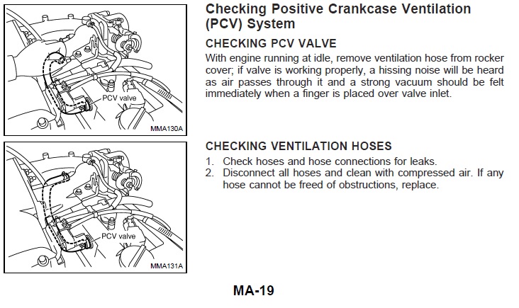

Vir die manne met 4.8's
TB48 PCV.jpg (115.05 KiB) Viewed 6789 times

Dankie David.
Re: My Patrol het beter petol verbruik
Dawid jy is n yster met al daai mooi manual prentjies ....dankie man :salute:

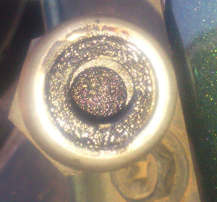

Ek haal die valve uit, spuit hom met die engine cleaner vloeistof en spuit hom dan met water skoon.
Dis baie maklik om te doen en dan maak jy net seker dat die spring in die valve maklik beweeg. :thumbup:

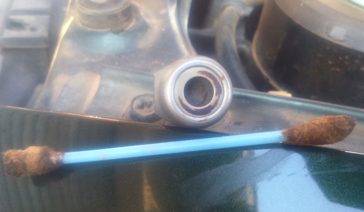

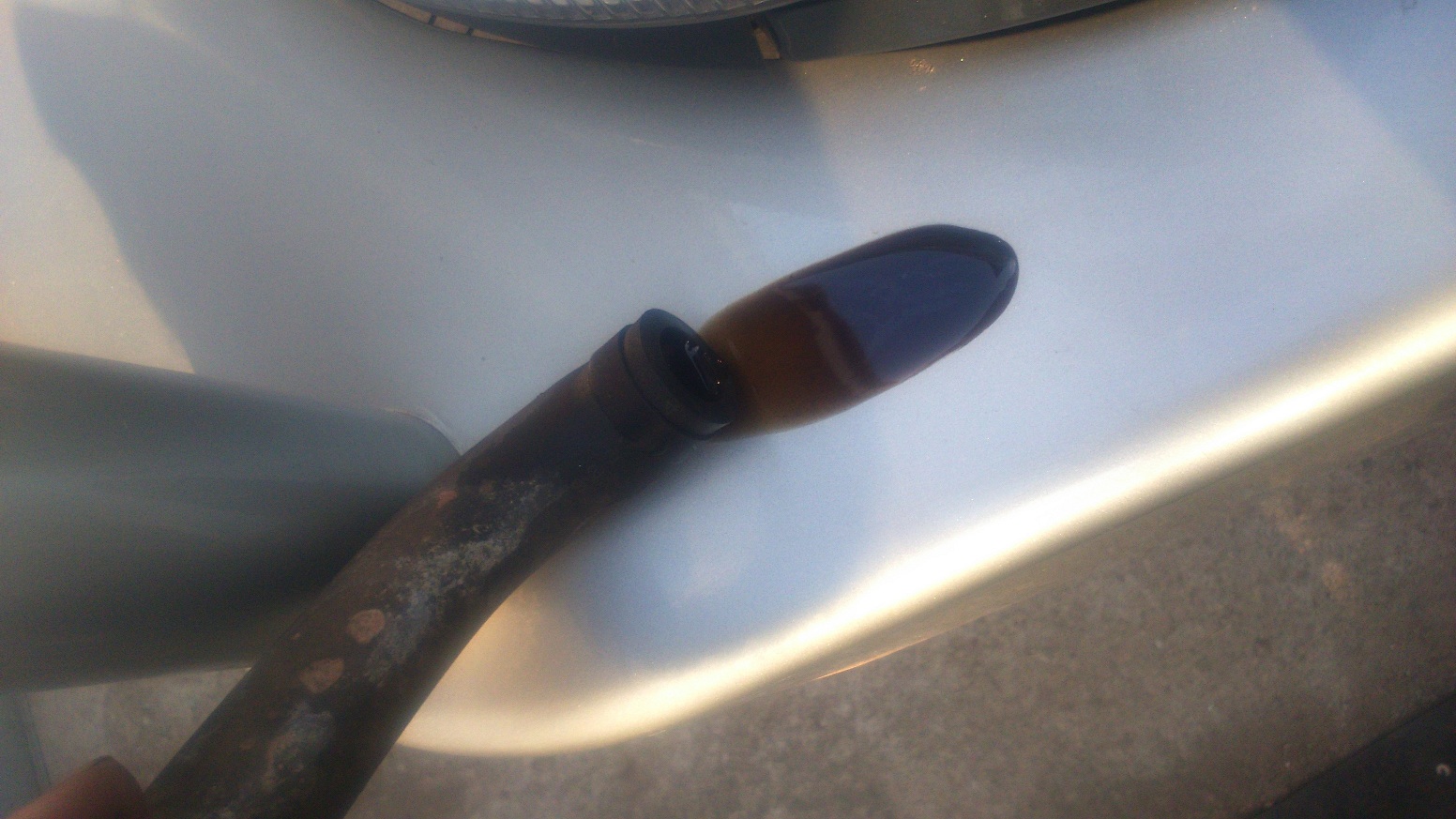

Omdat ek na die Bridgestone Challenge minder as 5km/l brandstof verbruik gekry het, het ek die valve weer uitgehaal en gesien hy is klein bietjie vuil.
Ek het hom en die pyp skoon gemaak.
Been thanked: 473 times
Why does it get dirty so quick? I assume this valve and pipe are connected or linked to the air intake somewhere along the line??? :think: :think:
Could this be due to air filter not cleaning the air properly?? I hear that the K&N type filters are not as efficient at cleaning the air as paper filters for example. Would an oil catch can, like for the diesels, not help collect the oil residue and indirectly some of the "dirt"??
Mabe you have to clean pipe and valve together?
