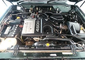

Huh??.... there is a fuse box there on the right and some other funny stuff like a battery and something with a black Coke bottle top on...... :rolling: :rolling: :rolling:
But yeah I think that could be the one. Is your turbo high or low mount?

Mine is a low mount turbo, going to have to do some serious puzzle building when it comes to a new air box installation.....

This is the 4.5 setup.
The box is parallel with the front axle.

Without measurements, it looks almost like the 4.5 petrol airbox size is very similar to the ZD30 airbox. On mine I would basically only need a 90 deg bend into the turbo.

The stoichiometric ratio for diesel and for petrol is very similar (14.6 and 14.7). Therefore, the optimal amount of air to generate a given amount of power will also be very similar.
The standard output for the ZD30 is about 118KW if I recall, and thus if your 4.2 delivers that or less, the ZD30 airbox should be OK. The standard output of the 4.5 is 145kW, and I doubt any of your diesel engines are producing more than that (don't m$%r me if I am wrong though), but I would believe that this should on this basis be adequate for the 4.2 diesel. On the other hand, if you can fit something bigger, it should still be advantageous, even if only a little bit. Certainly, if you could maintain the cyclonic velocity of a ZD30 but double the area of the paper filter element, you should gain engine life, service interval and possibly even a little performance.
