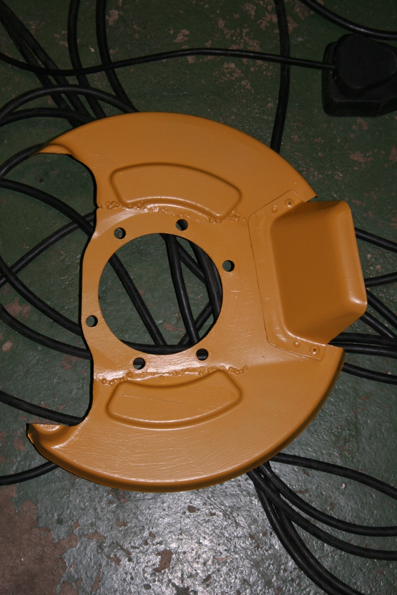

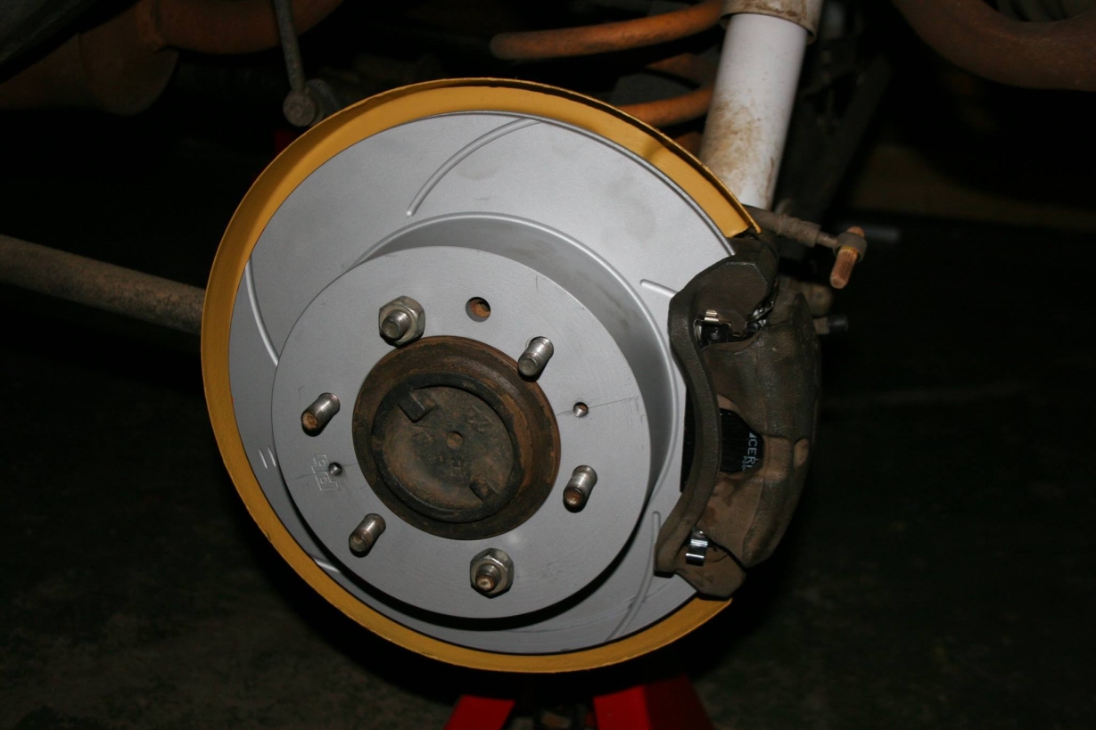

The rear cliphers has been rebuild and the discs replaced with powerbrake discs. Fitted the missing backing lates / Disc shields with a paired I liberated from a rusty Natal Patrol standing at the Volschenk Salvage Yard. Had to repaint them.

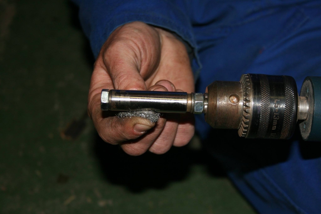

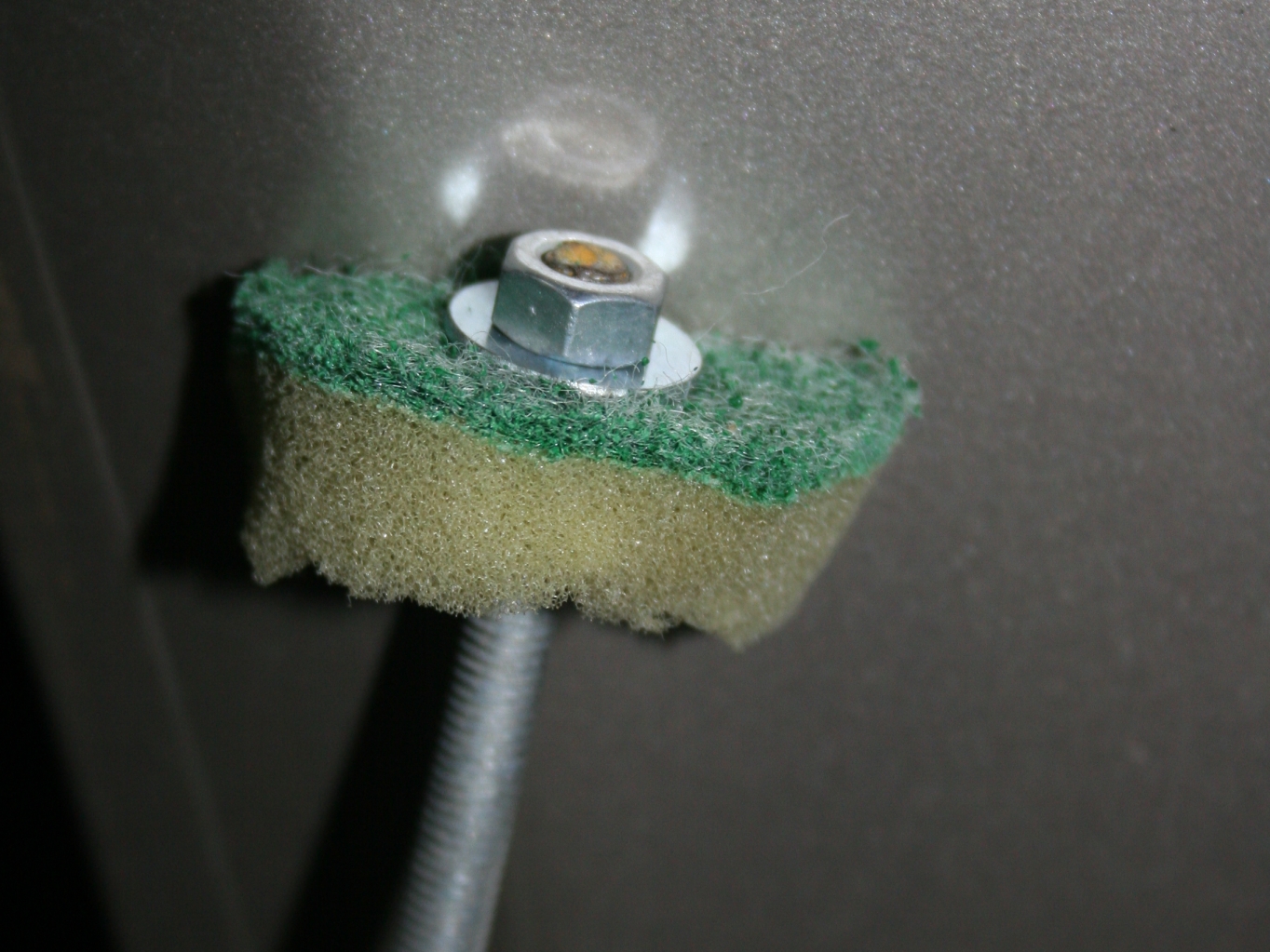

Fixed the sliding bolt's holes with some sandpaper on Peter tool fixing to the drill:
and fixed the pitted rusty slider to the drill:
When assembled:

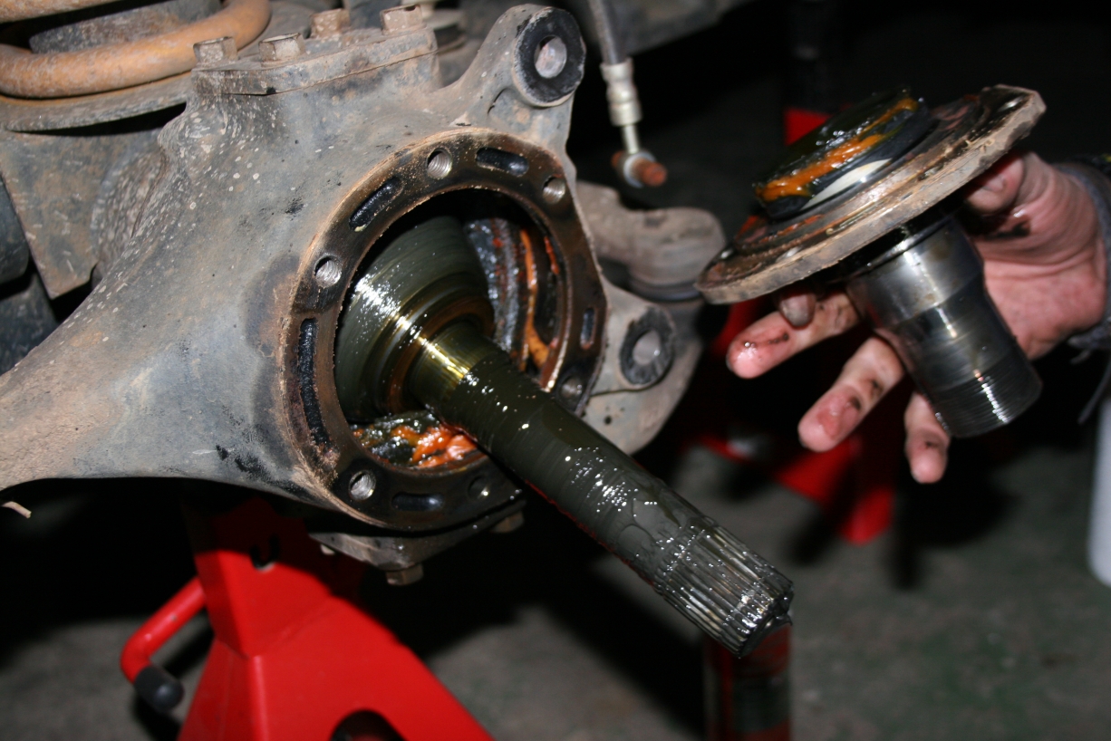

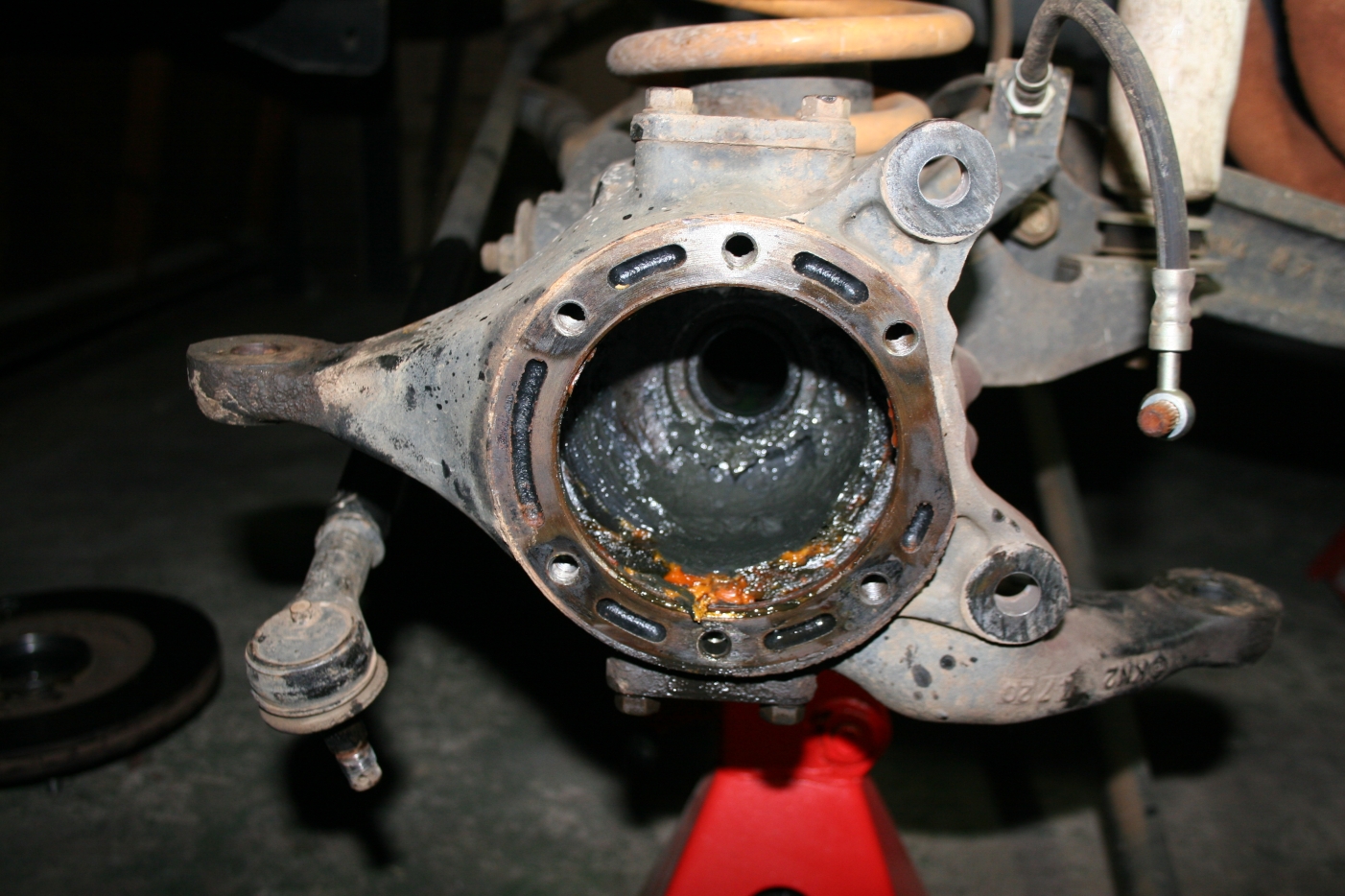

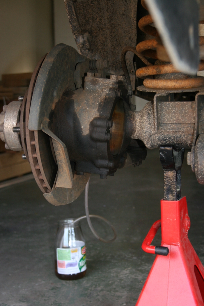

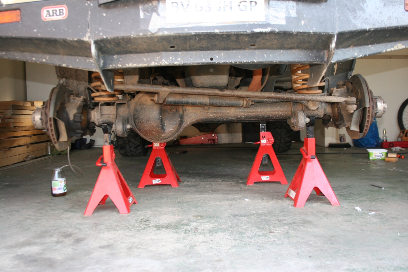

Then started with the front axle. You can see the oil leaks due to the broken seal:
When assembled:

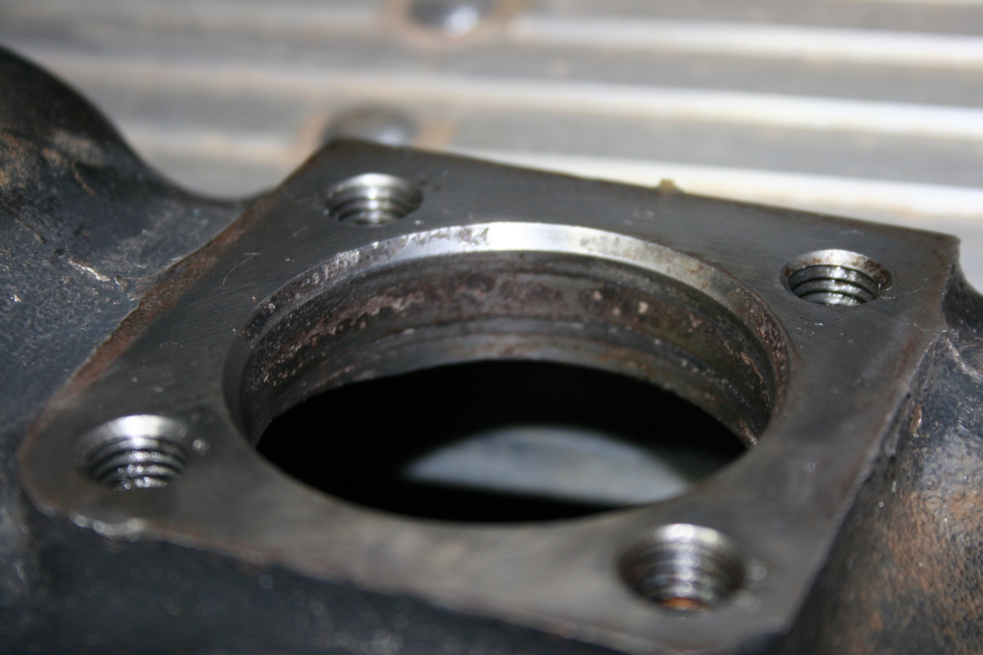

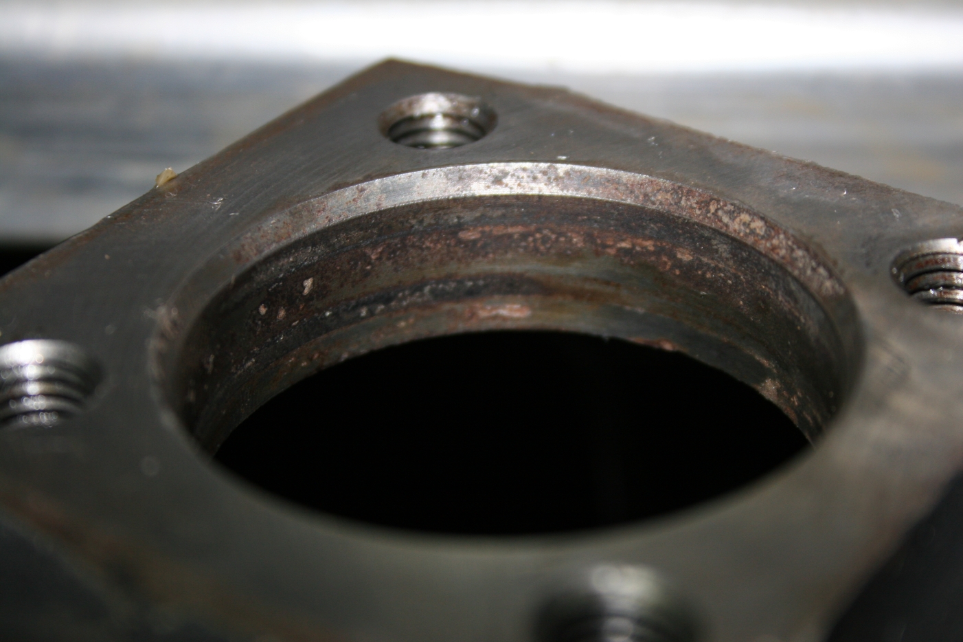

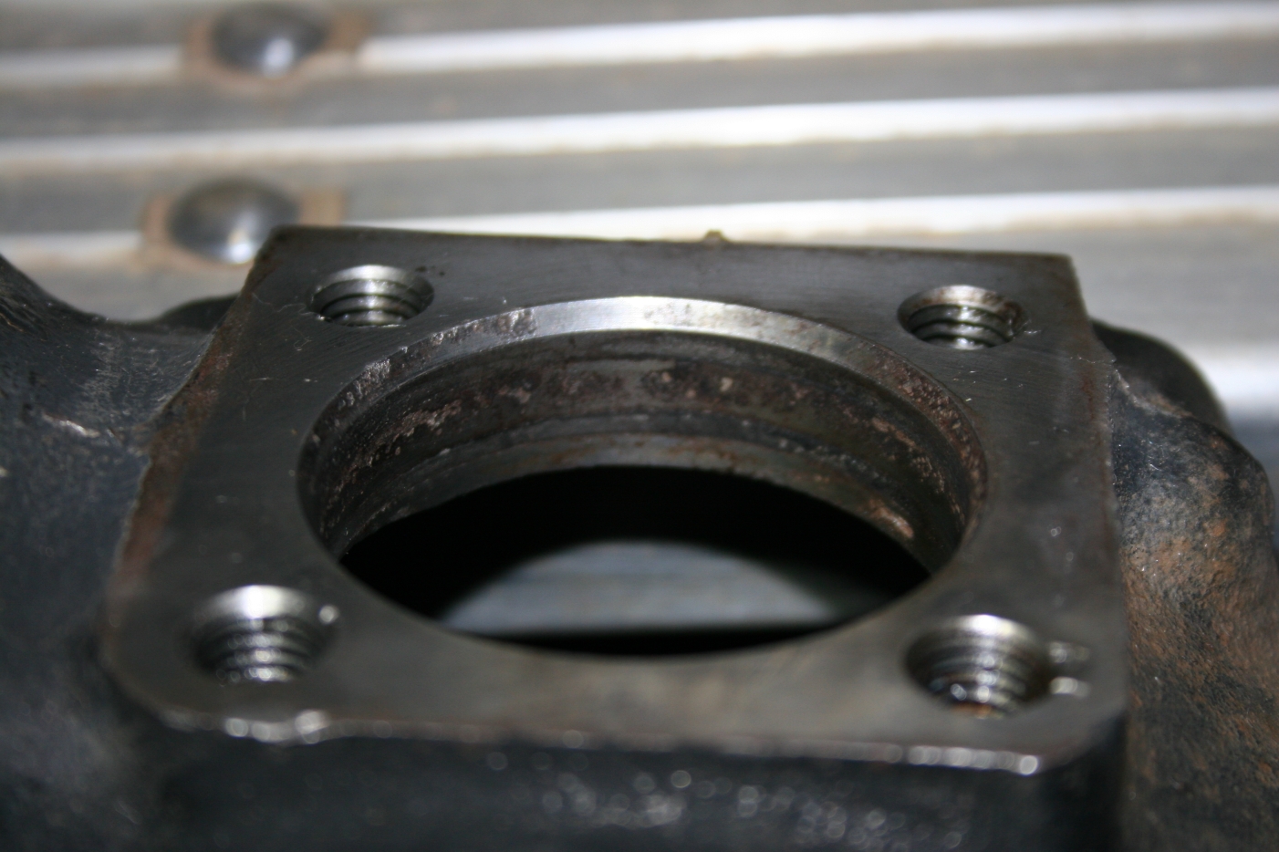

Front axle bearings:
there was very much nothing wrong with the bearings, and I was almost at the point of deciding not to replace the king pin bearings. Though the bearings seams fine, there is a lot of pitting in the king pin bearing "seat" Not sure what it is called, but the place on the trunion socket where the bearings run. Can I ignore and refit the bearings or is this a bad problem?
The grease was fine and I did not see any evidence of water causing this rust and pitting, so it may have been a occurrence prior to a previous bearing replacement. But I could see no evidence of the king pin bearings ever been replaced.

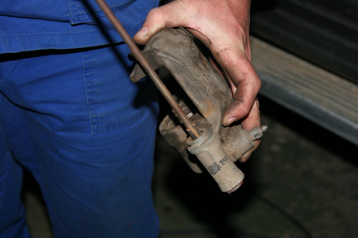

The tool for cleaning the axle inside, there was some gunk in the axle: Pitting on the trunion: Also discover the front calipers are in a horrible condition. They have two pistons - the rear caliper kit was R1500+ from Nissan - any ideas where I can get these seals and grease and rubbers at an affordable price?

Christo, you are right, it is powerbrake.
But only the discs. Powerbrake shoes are intended for racing, so for me pointless to use on a patrol.
But the discs are steel and i am not so sure if they contribute to the effectiveness at high temps only.
BUT, it was the cheapest discs I could get. The pads are ferodo. Also note the jacking bolt-hole that PC put in, as powerbrake reckons their paint makes it easy to remove. I opted not to trust them.

There is some granular gunk in the axle - but the axle narrows towards the end with a collar, so not that easy to get it out. If I flush it with petrol int the pumkin an drain out - or rather leave as is?
