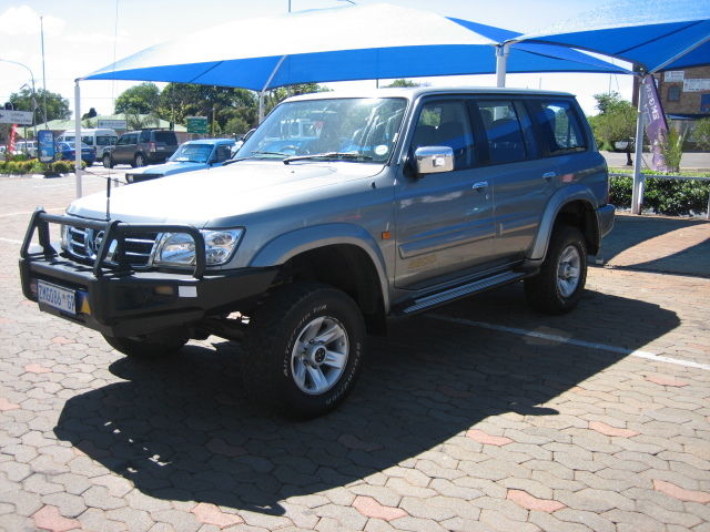

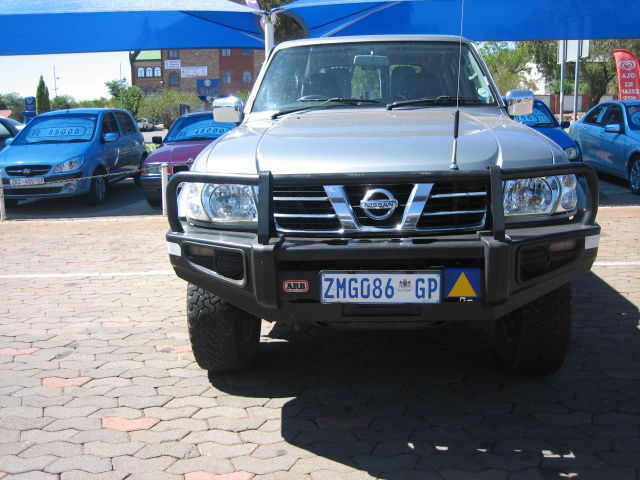

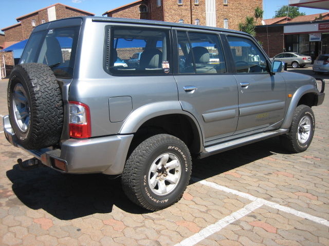

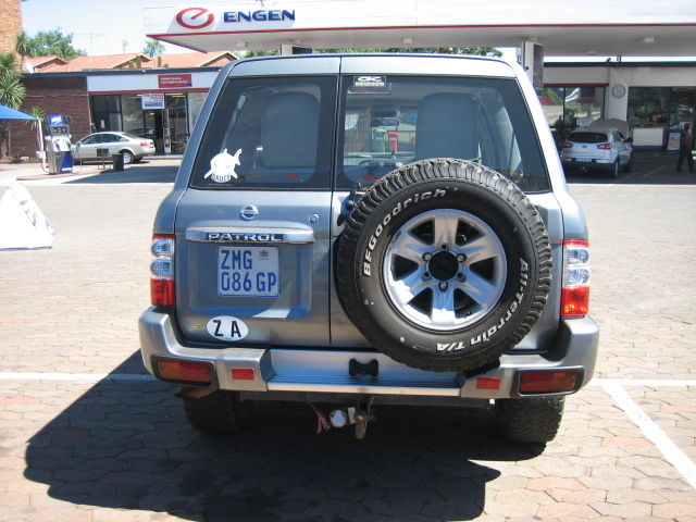

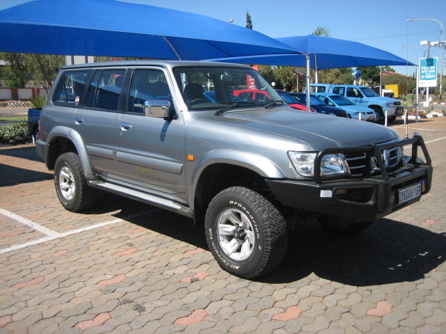

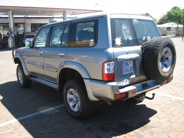

Morning all
As mentioned earlier, I had a look at this vehicle on Saturday and mailed details to Gerrit as he had FRF. He doesn't feel this is 'his', so I am posting this to the rest of the forum. Copied from my mail to Gerrit:
Niggles:
- CD player not working.
- Aircon fan has vibration noise on Speed #2.
- BFG AT's might need to be replaced soon.
- Small crack on windscreen in bottom RH corner running for 20cm from R to L.
Apart from that, this is a really nice example. She's done some work, but no leaks underneath that I could see apart from what looks like a minor sweat at the T/case. Body has some bush blush, but no major dents/damage that I could see. Inside has Escape Gear seat covers and 7 seats still there. All electrics are still working, engine sounds good and 4H/4L still works. Only had a quick test, but didn't get difflock to engage. Pricing is not fixed; owner is looking ideally for R195k (advertised on Gumtree for R175 by a friend), but I suggested that we ask Graham for a realistic price once he's seen the vehicle.
Verdere punte uitgewys deur Graham:
• Dis 'n 2004 model maar in 2005 geregistreer, het dus die plastiese dash; volgens Graham 'n goeie ding.
• Die arm rest cover is missing.
• All moving parts are OK, i.e. diffs, engine, gearbox.
• Might need to be replaced soon: 2 rear shocks.
• Steering box needs adjustment.
• Small leak in piping for Auto gearbox, not major leak.
• CD shuttle not working, radio working. (korreksie op my bg punt)
• Difflock works, but difflock light switch not working; to be replaced.
• Squeaky rear doors
• Overall good condition, well looked after
• Seen a lot of dust conditions, but not rocks. Overland dusty travel, in other words.
• RF window sensor needs to be replaced; window closes, but not correct height.
Voorgestelde prys:
- R165k to R175k; Raka sal kan finansier teen geringe fooi.
Ek is ook uit omdat ek kyk na 'n ander voertuig.
Foto's deur Gert vanaf Gumtree advertensie hier: http://www.gumtree.co.za/cp-cars-in-cen ... -539095259
Eienaar: Derrick
Tel: 082 570 3597
