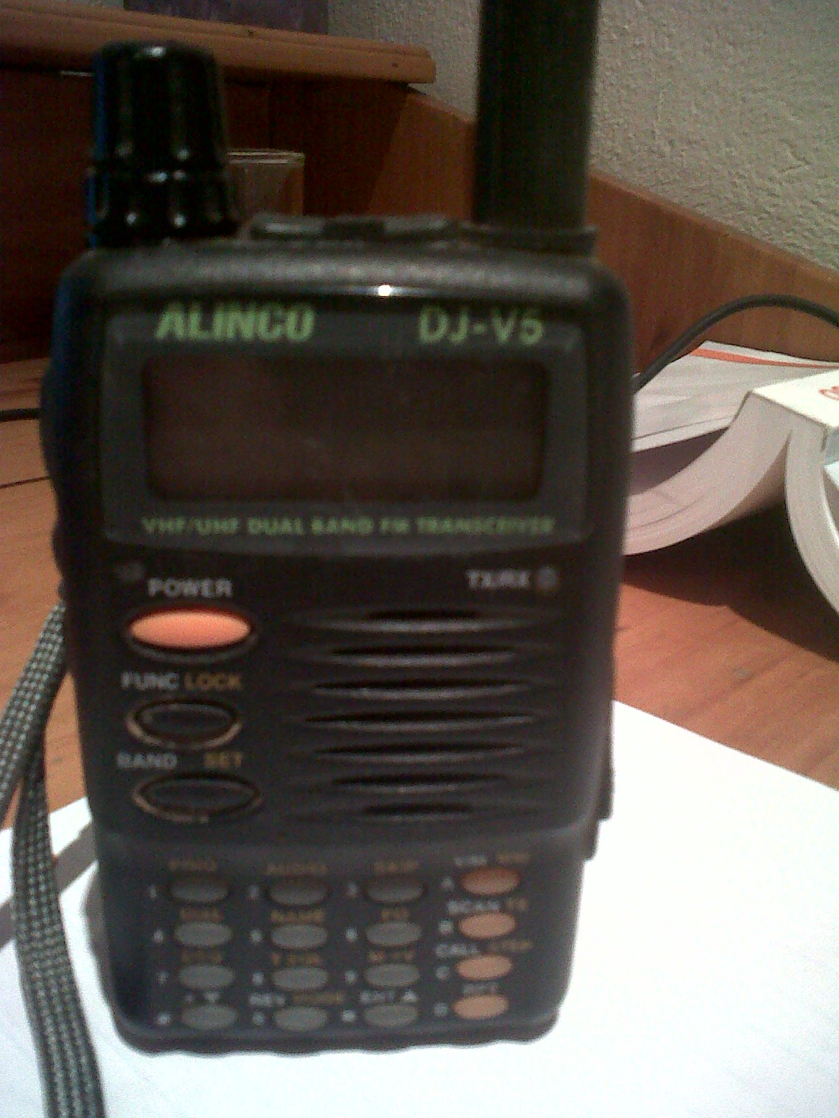

I however need some help. My uncle who was a HAM passed away sometime ago and left me he's landy. Inside the landy was a ALINCO DJ-V5 VHF/UHF Dual Band FM Transceiver. (pic attached) Can I use this for communicating when joining a club or expedition?

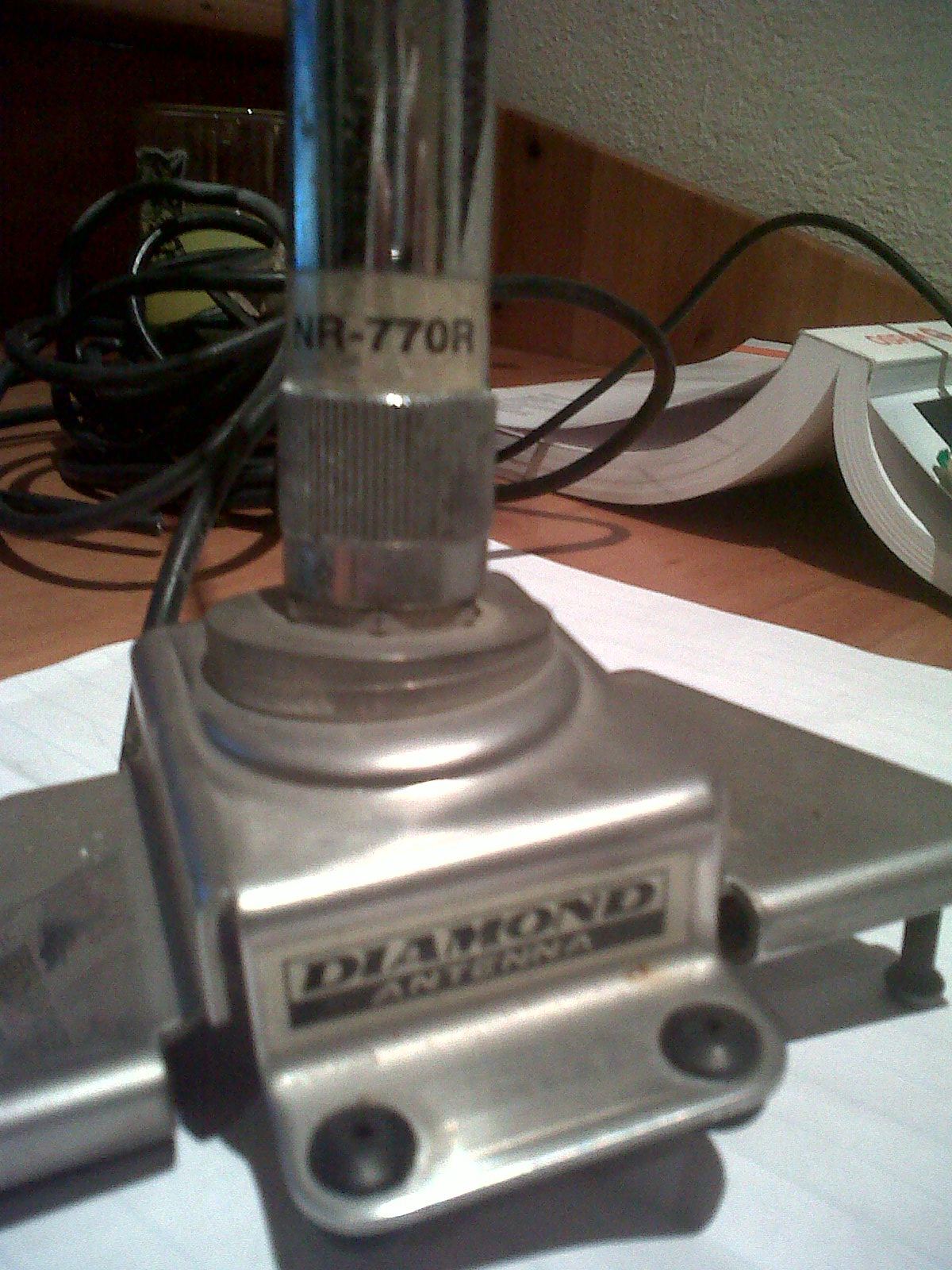

Also attached to the bonnet of the landy was a Diamond Antenna NR 770R (pic attached) - what is this for?

Unfortunately not. The Alinco radio is designed to be used by Radio Amateurs - Hams - and as such will only operate on the Ham bands. Note also that is is an all-bander, commonly used by Hams as it covers more than just the VHF Ham frequencies.
The radio cannot operate on the Commercial VHF frequencies, which extend way past the Amateur frequencies.
Likewise, tha Diamond Antenna is a dual-band antenna designed to operate on the VHF & UHF Ham frequencies, but will not be effective on the Commercial frequencies.
Not what you wanted to hear, I know.
