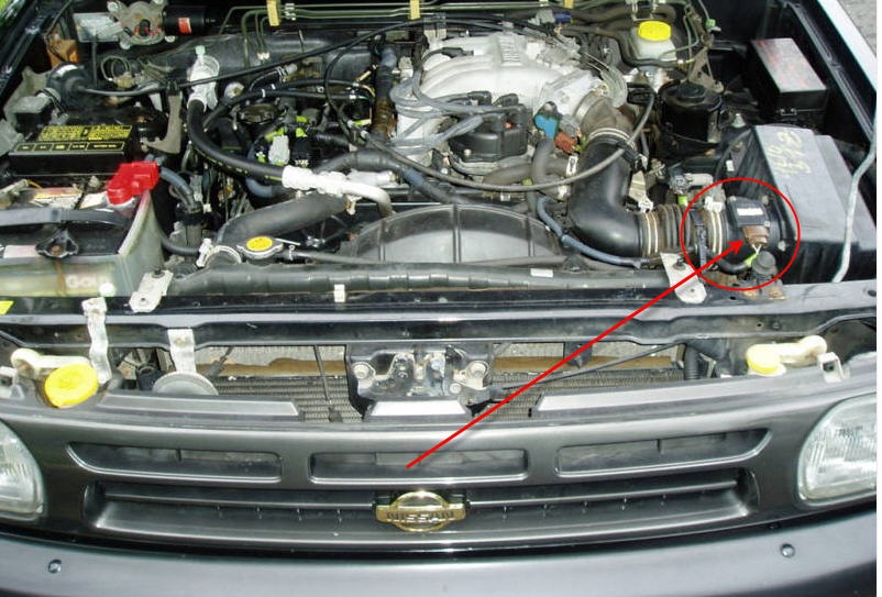

More almal,
Baie interresante praatjie :thumbup: Maar..... wat is die MAF sensor, wat doen hy en waar sit hy :confused: :think: ???

Hi Dawid
Dit is die Mass Air Flow Sensor. Dit is in karre wat Fuel injection het.
"A mass air flow sensor is used to find out the mass flow rate of air entering a fuel-injected internal combustion engine. The air mass information is necessary for the engine control unit (ECU) to balance and deliver the correct fuel mass to the engine. Air changes its density as it expands and contracts with temperature and pressure. In automotive applications, air density varies with the ambient temperature, altitude and the use of forced induction, which means that mass flow sensors are more appropriate than volumetric flow sensors for determining the quantity of intake air in each piston stroke."
Hy sit gewoonlik in die pyp wat van die air cleaner kom.
Hoop dit maak sin.

Re: Patrol Fuel burn....
dawid
kyk ook na die plug se konneksie as dit verweer is gee hy verkeerde lesing jy kan hom skoon maak met n 3sek spuit met carb cleaner start en herhaal so 3 keer
moet nie aan die punt vat nie en moenie laat val nie dan koop jy n nuwe een !!! ek spuit sommer gewoonlik van aircleaner se kant af in posisie
