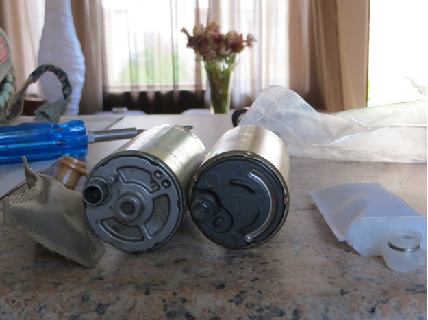

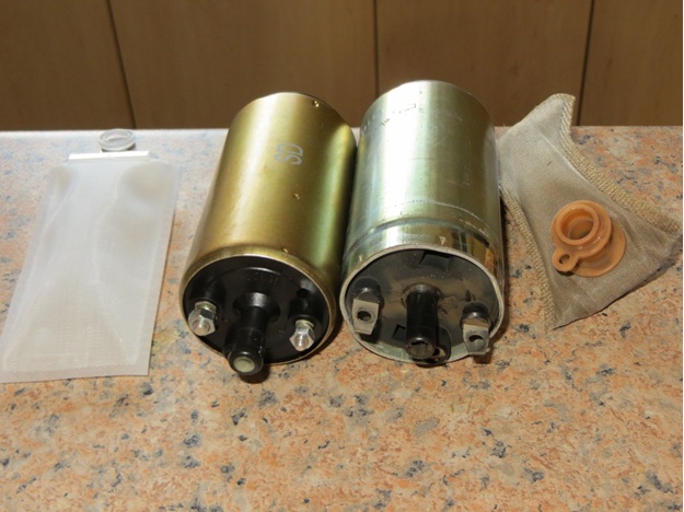

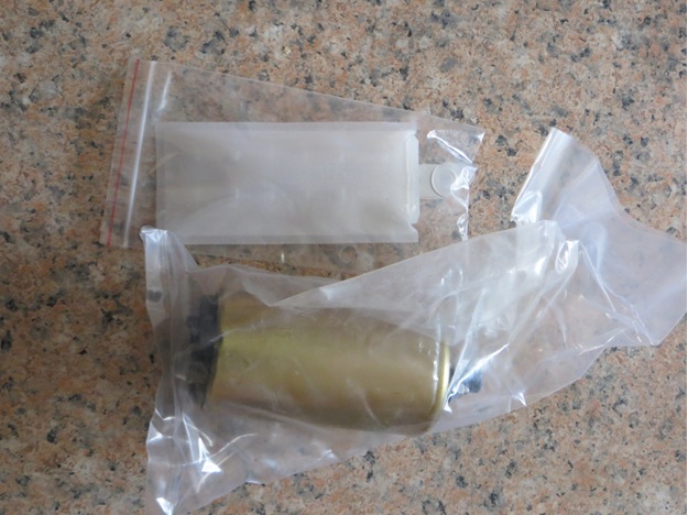

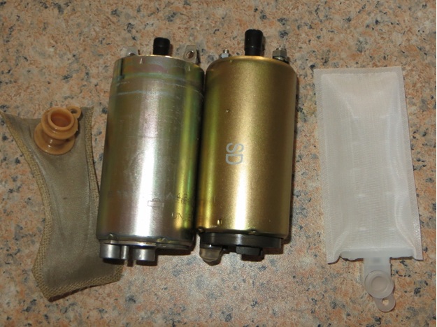

OK, this has taken some time. I installed a new petrol pump for my 4.5 GL 1998 last night. Due to finances I kept on moving it on, until I decided to do it myself. I cleaned the petrol tank over the weekend. Removing it and removing all dirt on the inside and outside. I found a petrol pump at one of the spares shops in Bloem that are quite close to the original for R450 (Stealers quoted R3200 for the complete unit, R3600 just for the pump, not my maths, Nissan SA
VAT must still be added
Some picks of the old pump and new pump:
The connections differs a bit. It is the same size as the old pump, so it fits in the pump cage very nicely. You can feel a definite change in power in the car. Makes a huge difference!!! There is a bit of a hum as you start the car from the new pump that runs louder than the old one. That get droned out by the 6 horses in the front.
