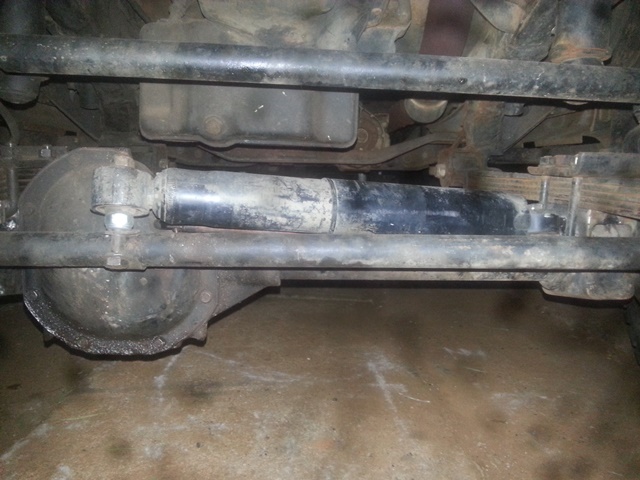

OME part no: SD01SJC wrote:Het nou gehoor dis 'n "eye-to-eye" damper....
(nie naby my patrol(s) om te kyk hoe hulle lyk nie, maar ek vermoed hulle is alby pin-to-pin)

Hier is die advertensie indien iemand 'n patrol het wat so tiepe damper gebruik:
http://www.gumtree.co.za/a-car-replacem ... 0023816009

Re: Steering Damper (stabilizer) replacement
Looks like the one on my GQ

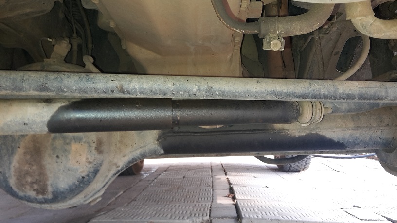

After traveling on some bad corrugated road this week, I noticed this dark patch this morning.
Any recommendations on replacing? After market or original Nissan?
HEHE, looking at the prices of these things with my very limited budget, I had my old damper from the Sani go FUBAR on the SFA.
I got DW and needed a damper to get the vehicle over 70km/h. My solution was the rear shock from a Disco2 that I had laying around spare. Steering is not much heavier unless you want to try and do and lock to lock in BIG hurry. I just had to trim the one eye to fit into the bracket we had built for the original damper, and replace the bolt on the tie rod with a longer one.
