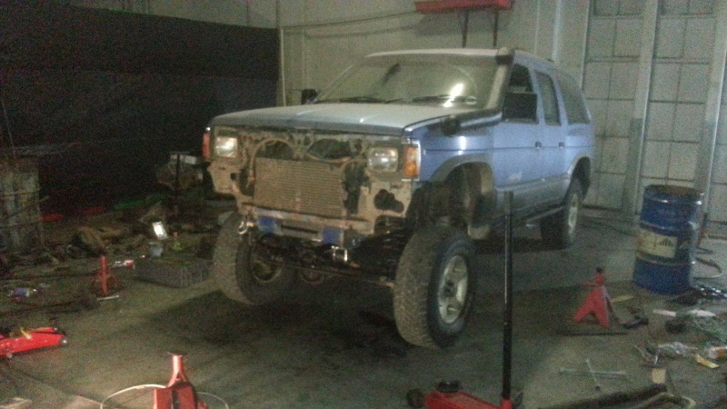

I resurrect this thread to ask the pro's on the forum about the same leak on a diff for a 83 Safari MQ. Looks like the C200 diff, but I am not sure. Mine has started leaking on the workshop floor before it even got into the car.
Anybody know if the parts are the same as mentioned in this thread for the newer patrols...
And if you are confused about why someone with a Sani is asking about this.. Here is where it fits...

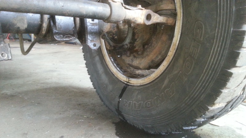

Right guys, I've got the same problem and have had for a while. Firstly thanx for all the posts above.
The story. Because I'm in Tanz for most of the time, I don't drive the Trol often enough and my wife prefers her plat-kar. Last year whilst on site she called to say she observed an oil leak near the front tyre. At that stage my vehicle was still serviced by Nissan (Imperial) and I asked her to take it in. About R10000 later the bearings and seals were replaced on both sides. Not by Imperial, but by one of their specialist workshops. However, not long after I noticed the leaks again.
This time I approached Frans Fourie, also on this forum to assist with servicing. Wow, what a breath of freash air. Reliable and knowledgable. During the service and checks he picked up the leaks and immediately reported it to me. Long story short before I knew it he had convinced Imperial to redo the job at no cost - replaced the seals again. That was great and an excellent and thorough service followed.
Unfortunately, a few days later I noticed the leaks again. Now, obviously we haven't got to the root cause. Some reserach later and these are some of the potential causes/answers I quote:
1. Bent shaft/Damaged diff?
2. Could be pressure building up from a blocked diff breather hose usually the filter on top gets blocked with dirt over the years it might need replacing.
3. Do you adjust king-pin shims and preload correctly ? this is very important to hold drive shaft correct position. another case , little worn out drive shaft is occur oil leak I knew 2 peoples y60 change drive shaft assy and they stopped oil .
4. Mine and the brother-in-laws car both leaked. I rebuilt his one first and the side that was leaking leaked again. When I did mine I found that the drive shaft had a polished surface where the seal ran. I installed a speedy sleeve on mine and it didn't leak again. I then pulled his front left apart and the drive shaft also had a polished surface where the seal ran. I installed a speedy sleeve on his as well and it has not leaked again.
Anyway, will appreciate any further knowledge that can be shared
. I will say this, I love dune driving and have come down hard a few times on the front wheels.
Thanx
John Boy

Years ago I had the same leak - oil was dripping on the right wheel rim - on my Safari at Piet Retief when we slept over on the way to Sodwana Bay - that was in 1996.
I went to the Nissan agent and they checked that there is still enough oil in the front diff and I then went to Sodwana and when I got there, there was no more oil leak and even up to today these is no oil leak!
