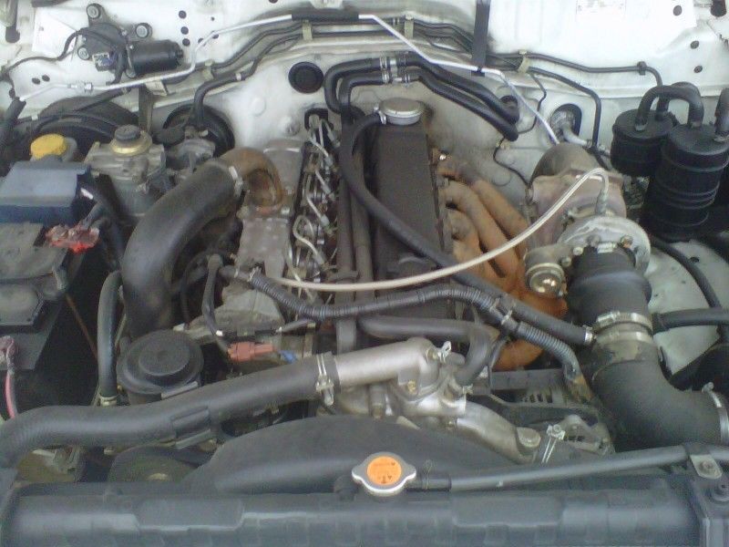

So a turbo without an intercooler is a disater? like this one: http://www.gumtree.co.za/a-cars-bakkies ... 0001968709
- 4.2.JPG (79.05 KiB) Viewed 3068 times
Re: Donkey 4.2 vs Donkey2.5 TD5
Looking at that, I think that there is a front mounted intercooler fitted. I assume this due to the way the pipes are running from the turbo to the intake manifold. I can't see if it is a water cooled turbo or not but looks like a neat installation, with exhaust branches that look identical to my set up!!.
The only negative with the branches is that there are no heat shields to stop heat transfer from the exhaust branches to the turbo. This can be remedied with a little cutting and grinding to make a plate/shield.
On mine I have a HUGE radiator ( bought it like that ) and NEVER had overheating issues. I would suggest a radiator flush and replace antifreeze with CORRECT percentage and fresh water and Bob's ya Auntie
Other than that ..... looks good
