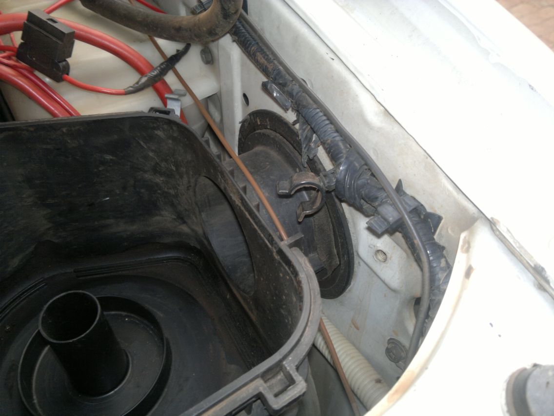

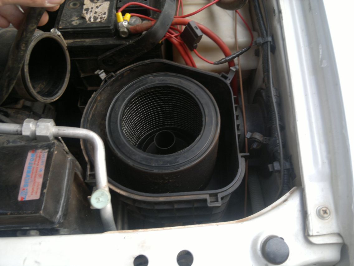

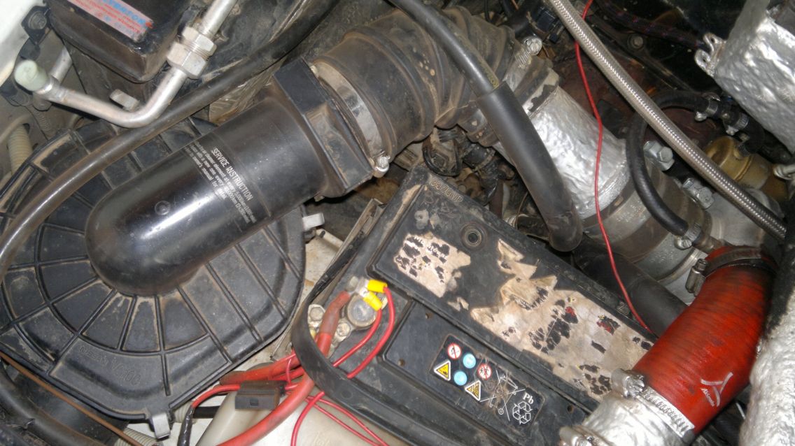

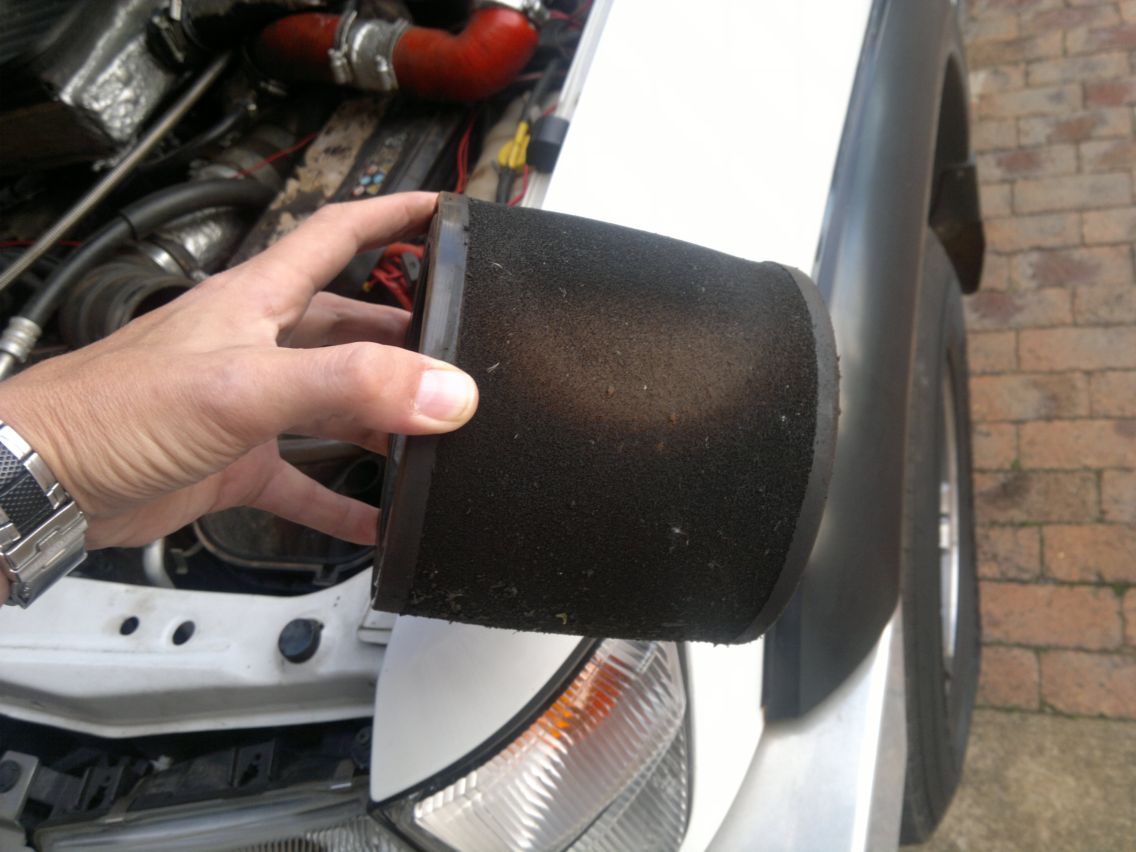

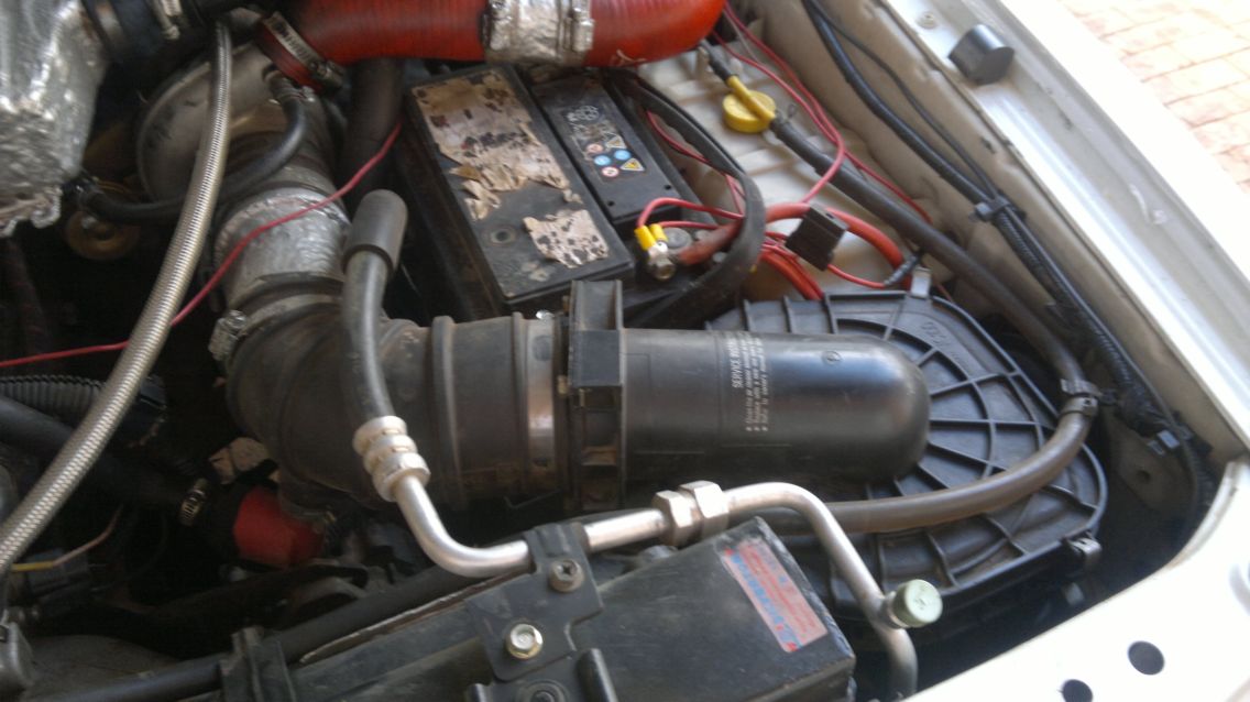

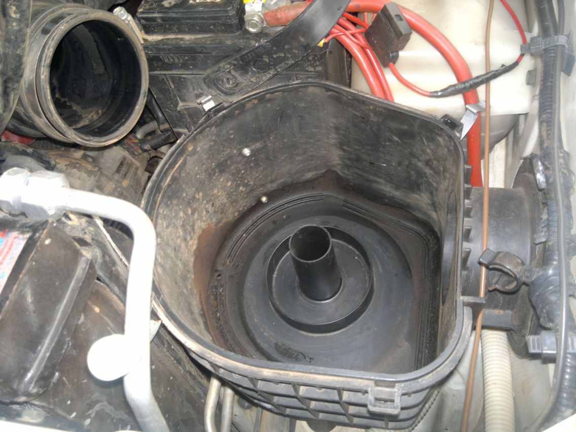

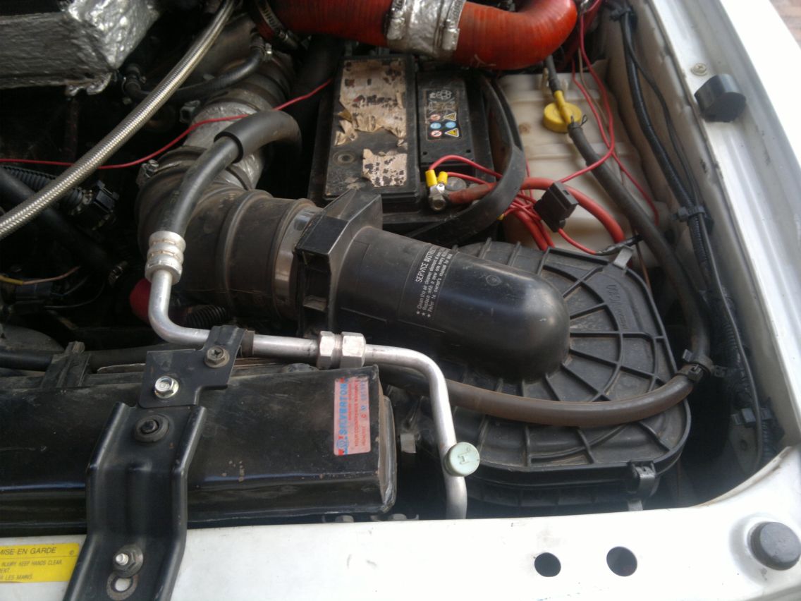

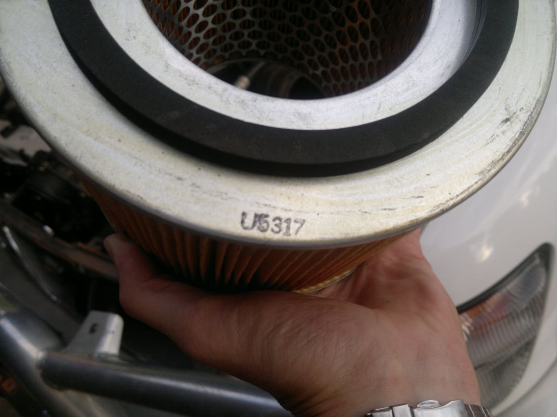

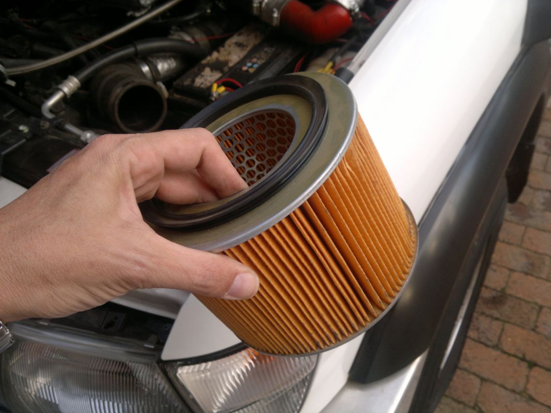

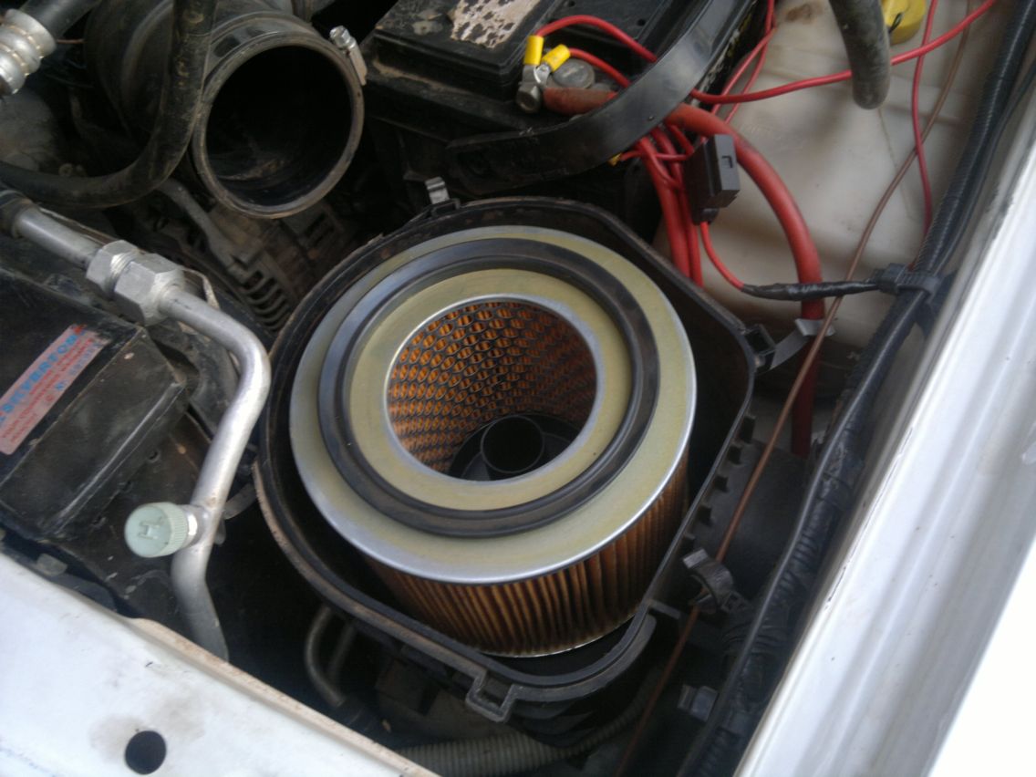

Ok... here goes...
Filter box setup
Showing sponge CRD filter element..... dirty after +/- 4000 Km
Inside of air box
Snorkel attachment to air box
Replaced the air filter last night with a paper type filter found in the drawer system when I bought the Maiden

I do also have a gut feeling that the system I have is not the correct size for a turbo 4.2 diesel.
I thought this morning that the maiden didn't cough and splutter for the first few seconds after starting. Normally I get a plume of smoke out her rear end... :rolling: ... I assume that the oil spray on the filter medium is cold and therefore tacky restricting airflow considerably, until the air breaks through or warms up the oil on the filter.... I'll monitor this

Pleasure mate.... but ...ummm maybe my blonde hair is showing up again.... will you not need to sort out the airbox prior to fitting the snorkel so the delivery point of the snorlel fits into the airbox housing the filter, or have you got a different idea in mind.... :think:

Dave,Cedric's filter is a std ZD30 filter setup.
