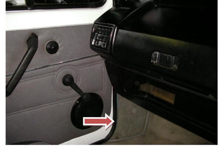

Gutter protection
Stefan
Try getting some Citi Golf door trim from a scrapyard. You slip it over the 'feet' of the rack so it protects your Patrol's gutter. It is cheap and works great - I have used it for all my roof-racks
