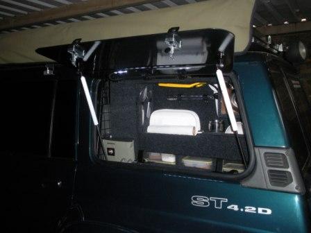

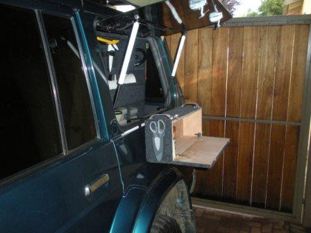

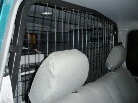

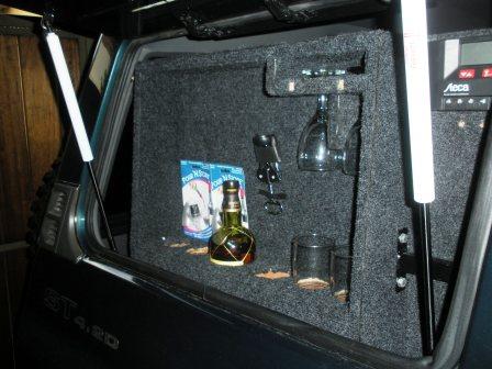

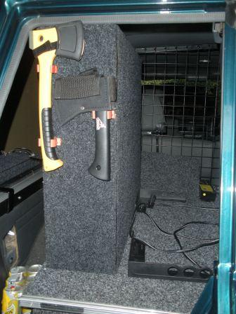

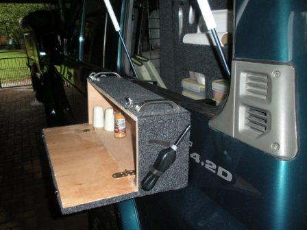

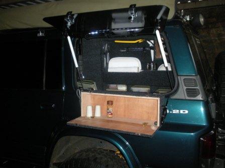

As Promised some pics of the "Gull wing" in place of the rear windows.
- Pic 9.jpg (39.89 KiB) Viewed 4072 times
- Pic5.jpg (42.15 KiB) Viewed 4072 times
- Protection for rear passangers
- Pic 8.jpg (41.03 KiB) Viewed 4072 times
- Bar unit of other side
- Pic6.jpg (46.99 KiB) Viewed 4072 times
- View from rear of car.
- DSCN2304.JPG (47.78 KiB) Viewed 4072 times
- Side view
- Pic3.jpg (40.72 KiB) Viewed 4072 times
- Kitchen unit with removable box that clips onto the inside of the car
- Pic2.jpg (36.85 KiB) Viewed 4072 times
- Kitchen Unit
- Pic1.jpg (36.03 KiB) Viewed 4072 times

Dit lyk baie netjies......water materiaal het jy gebruik vir die gull-wing deure.

I opted for 3mm steel. Reason for this is that I could weld the hinges to the wing. Tipicaly when using aluminuim the guys drill holes and bold the hinge to the wing. Also had them powder coated gloss black so the resemble the tinted windows.
