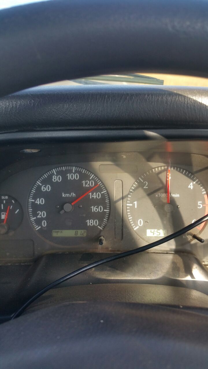

I noticed something interesting between the 4.2D pickup and Wagon ratio's
At 120km/h on the speedo Tinus's pickup does 2800rpm
At 120km/h in my wagon I do just under 2600rpm
Must be differant gearbox ratio's?
Re: Tinus se 4.2TD bakkie!!
or maybe different diff ratios??

ricster wrote:or maybe different diff ratios??
Cedric, I initially thaught this might me it, but some say the gearboxes have differant ratio's
Does anyone know if the ratio is stamped on the diff somewhere?
Post by Russ Kellermann »
There is no variations between models using the FS5R50B gearboxes. (as is your cases and all GU's).
Nor is there variation between Transfer cases. All models use the same gearbox and transfer box.
The differences always lay in the diffs.
The H260 in Tinus 's patrol pickup is a 4 Pinion, running 4.111 gears most likely, very rarely were Patrols fitted with 4.375 gears.
Micheal, is yours the H260 ? or the H233 ? You can check by looking on the firewall . it will be stamped within a set of other numbers and letters, which will include correlating numbers to the size of the diff, and the gearing within it from factory.
I suspect yours is fitted with 3.9Gears given the differences in revolutions at 120.
Mine does about 2800 odd at 120km/h as well.
Maybe the tyre size different between the Patrols will also have a different on the revs.
