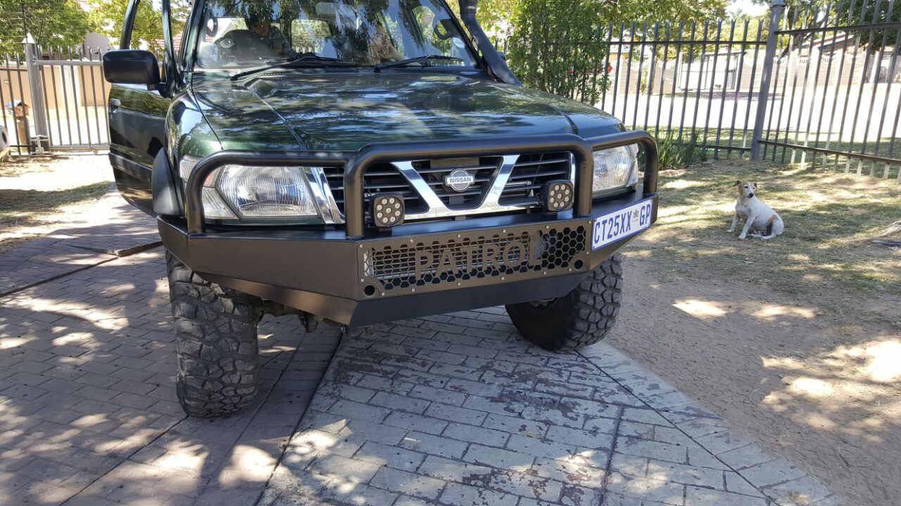

Altwee daai Patrollies lyk Bakgat ......well done !!!!! :thumbup: :thumbup:

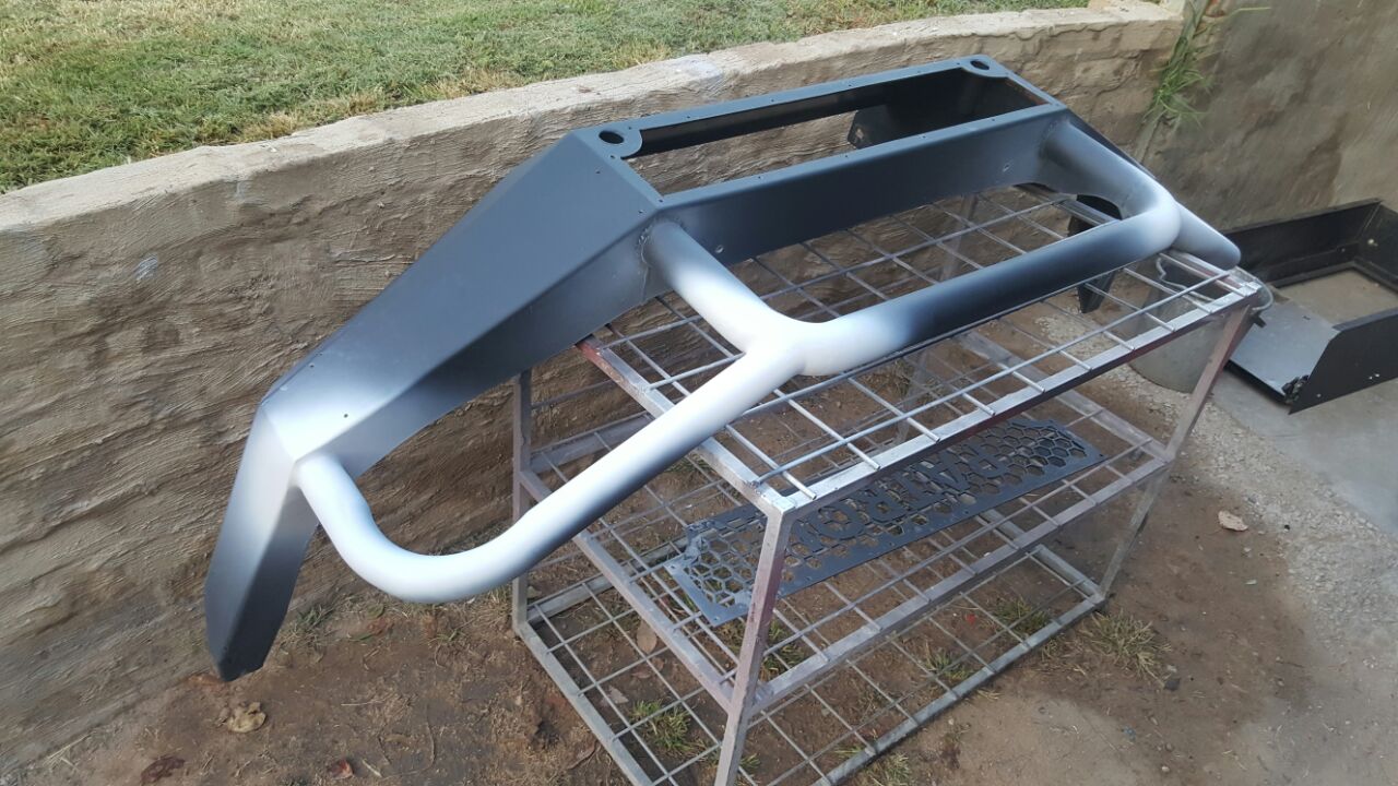

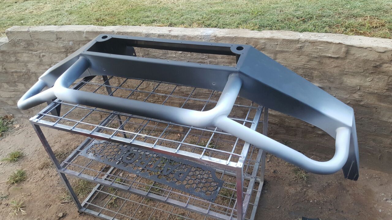

Almost time to paint

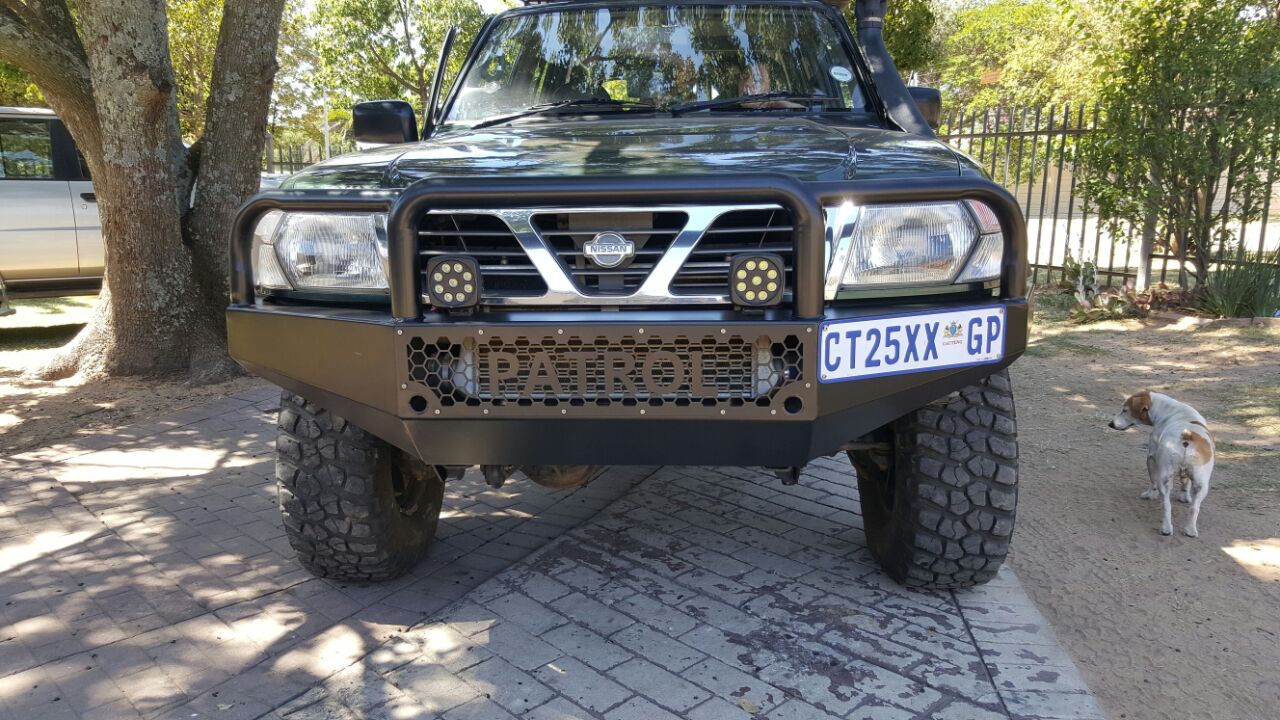

Done
Re: My GU 4.2 Turbo Diesel
Jip legit.....nou lyk dit soos n regte bumper .....yster is baas jy besef jou 0 tot 10 ga nou .1 sek stadiger wees van al die gewig.....lol :rolling:

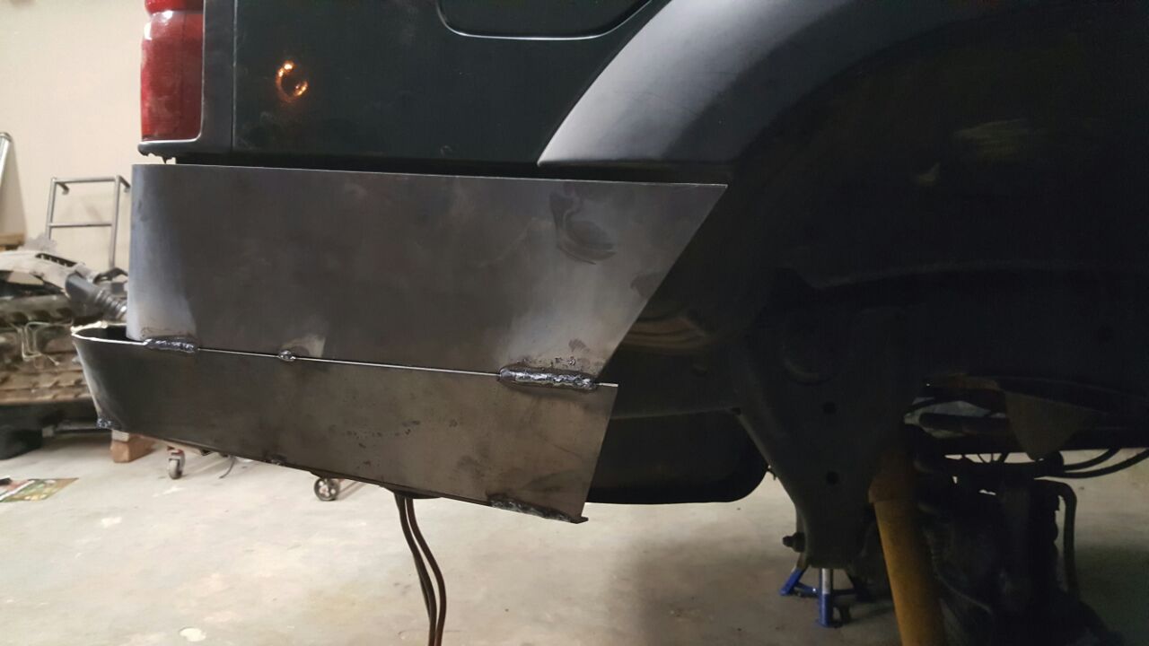

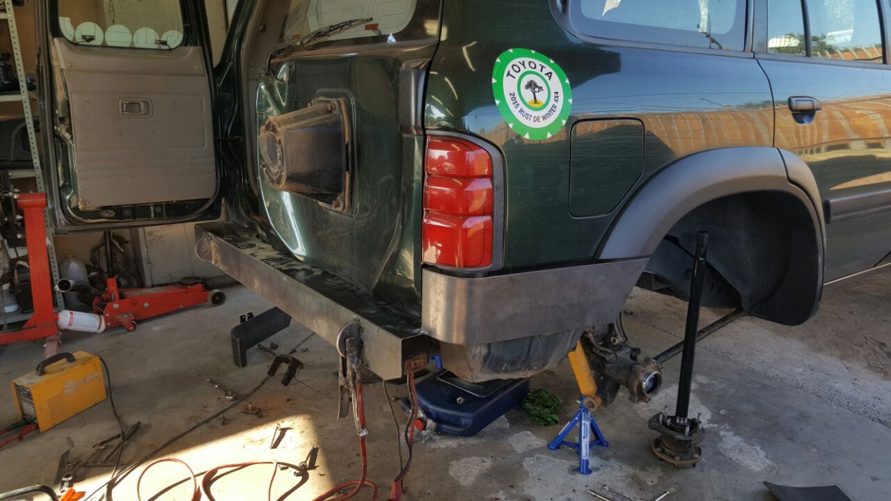

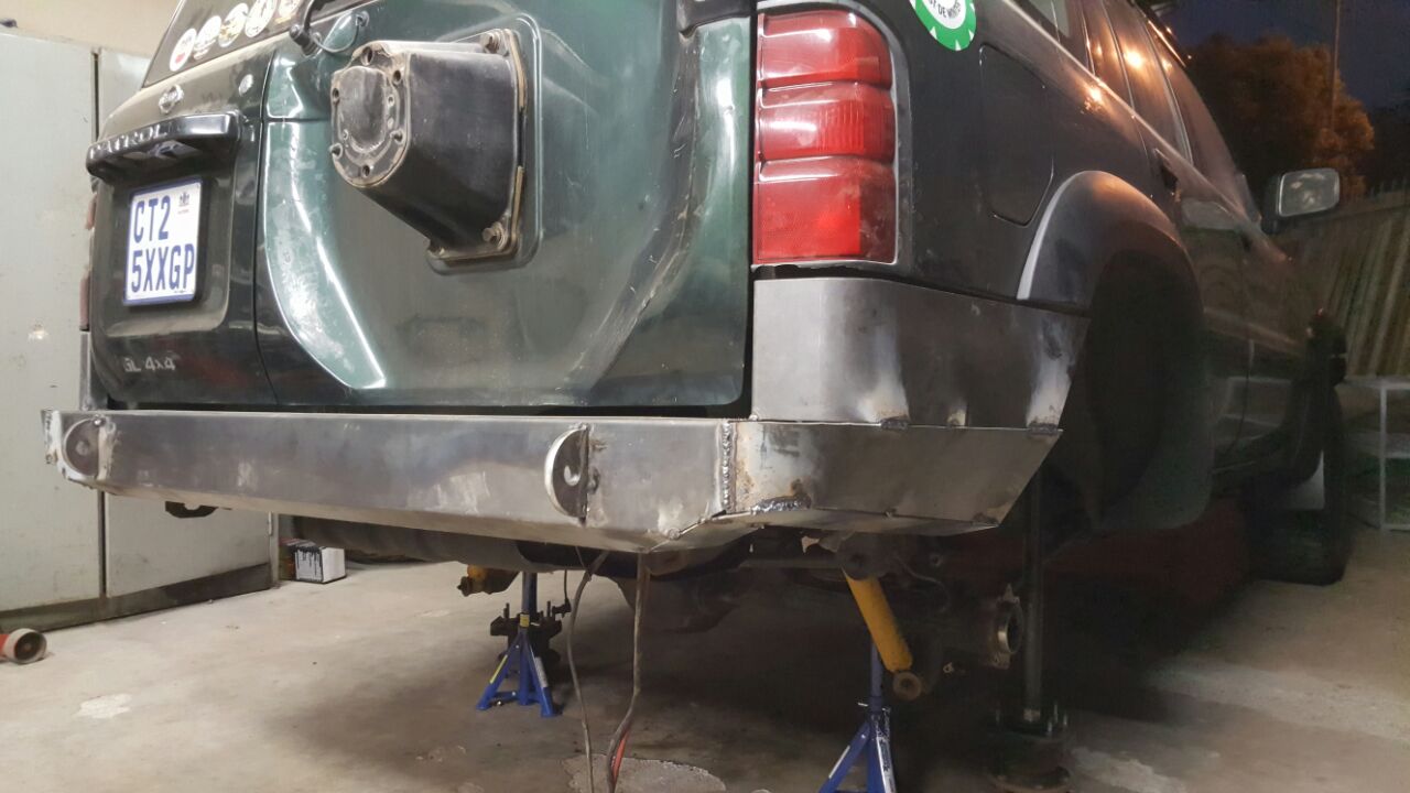

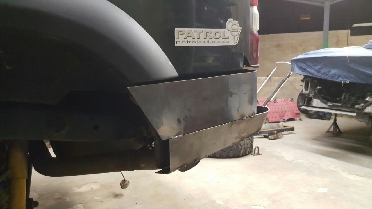

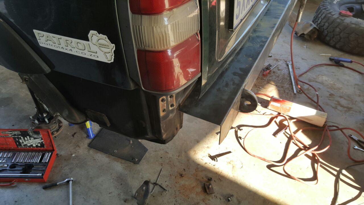

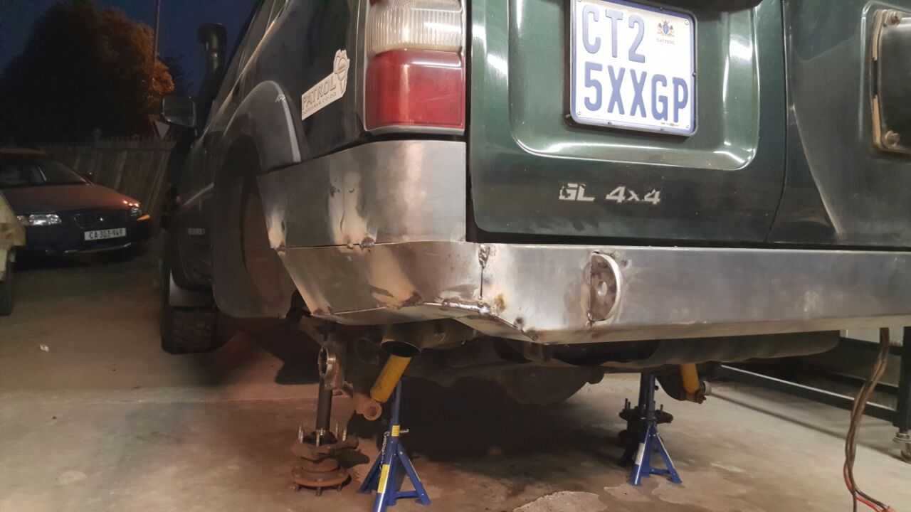

So finally I started building a rear bumper for my wagon......
Takes longer than I thaught, but Im sure its going to be well worth it in the end.
One question, the spare wheel sits very low from factory and I have seen many Patrols with after marker bumpers and the wheel sits higher than the bumper.
Do you modify the wheel carrier or what?

Michael wrote:So finally I started building a rear bumper for my wagon......

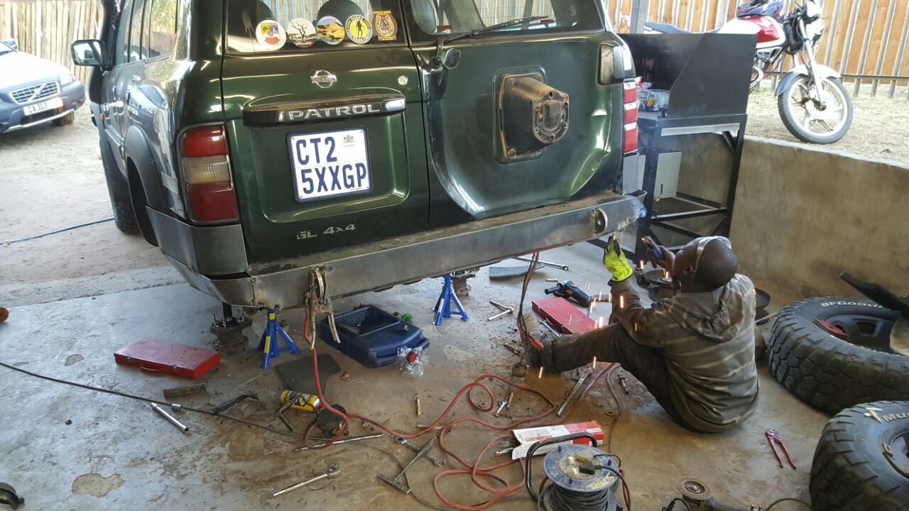

Michael, you've turned black by the looks of the photos! :rolling:
Some of the aftermarket bumpers have a nice, rounded cutout into the top of bumper for the tire to fit into. Mine does not :redface:
So... I modified my spare wheel carrier so that the rear tire sits about 5 cm higher (to clear the steel bumper) and 2.5 cm further back (to prevent the fat rubber from rubbing against the rear door).

Thanks for the tip Christo, I will also mod mine.
Ha ha yes, that is my trusty friend Alex :lol:
He has been working for me for many years and is a welder by trade....... and my welding scills are quite poor.
Hopefully today I will make some progress and maybe finish the job
