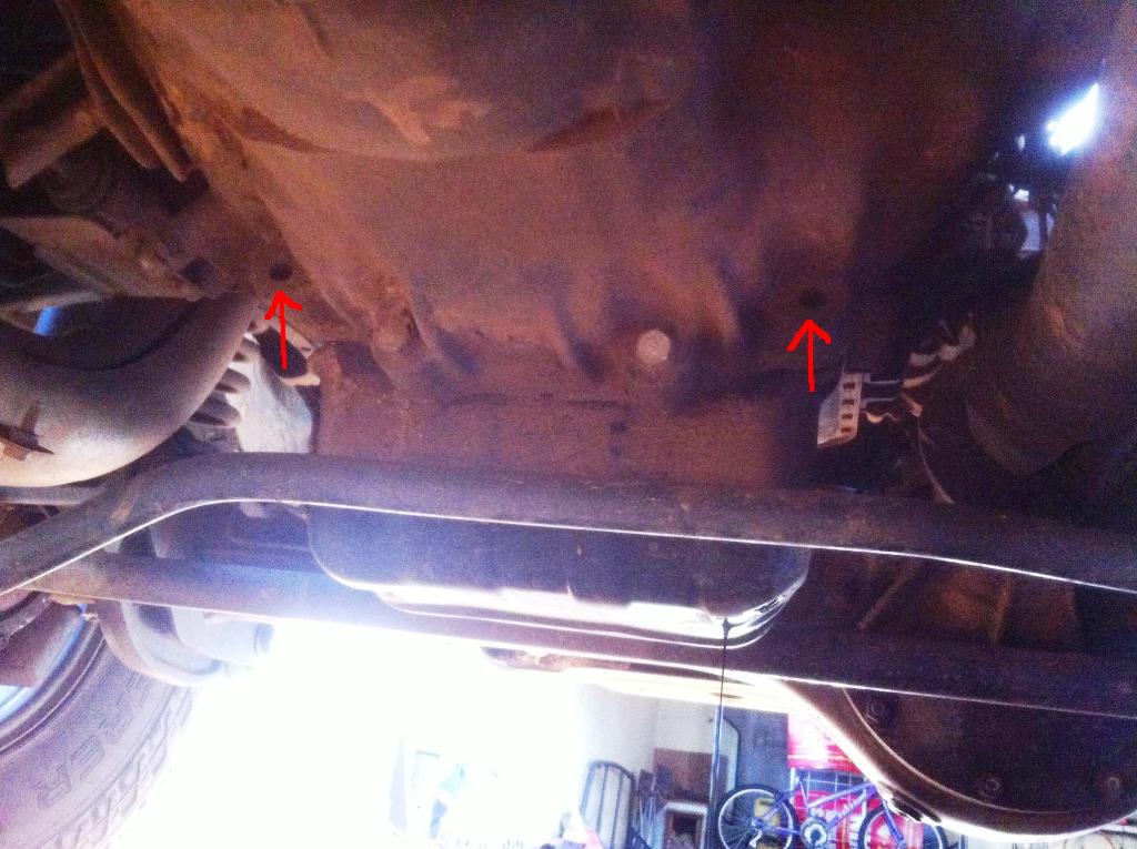

Can anyone tell me if there is suppose to be bolts here?
(Was busy draining the engine oil when I noticed this)...

Peter Connan wrote:It looks from your photos as if Nissan are now using the 4.8 Patrol's chassis as the basis for the pickup chassis.
Therefore, the 4.8's standard recovery points should fit.They use the same bolt holes that hold the plate under the radiator. You can buy them from Nissan for about R550 each, and I promise they are stronger than anything you can buy anywhere else.
You will need to buy longer bolts as well, M14 x 2 (I think but the first fine thread anyway), you will need 35mm long or more.
Which dealerships in Gauteng can you guys reccomend to buy a recovery point/hook from?
I will be coming up next week some time, maybe I can buy one while I'm there..
