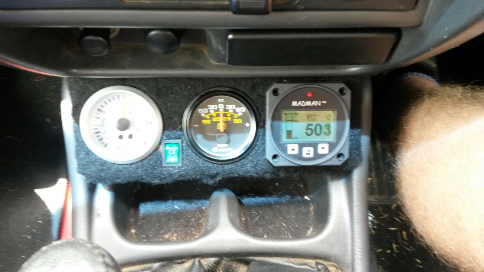

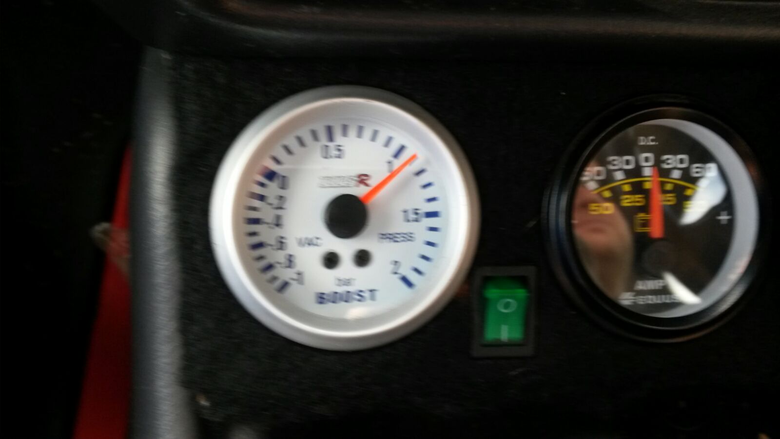

Sjoe Fanus, hy boost lekker hoog!
Ek glo nie dis te hoog nie, jou engine is gebou vir n turbo so sal nie n probleem wees nie.
Dis nie boost wat n engine breek nie, maar hoe EGT's
Been thanked: 432 times
Re: Madman / Landy on line
As jy n meer akurate leesing wil he moet jy die boost by die intake manifold meet, mens verloor soo bietjie boost deur die intercooler.
As jy jou exhaust doen gaan jou EGT's ook laer wees
Kan hy nie maar n agste feul by sit nie????

Fanus, weldone ou :clap: :thumbup:
Bly jyt al die goete kon in kry. Dis mooi boost daai. Hy loop seker al lekker.

Tinus lotz wrote:Kan hy nie maar n agste feul by sit nie????
Ek dink hy moet eers sy exhaust doen voor hy aan die fuel stel..... Nog fuel gaan sy EGT's weer op jaag

After almost 2 years of nagging. My friend with n chuned up Mazda drifter2.5 finally bought an Mandman EMS2. i helped him to install it this morning. We took the car for a drive. Boy was he surprized. He reached a max temp of 762 degrees at 150km/h. :lol: . Well needless to say, he is much more carfull with the foot know....
I was very surprized when I saw his boost :surprised:

Hy boost selfde as myne... :lol:
