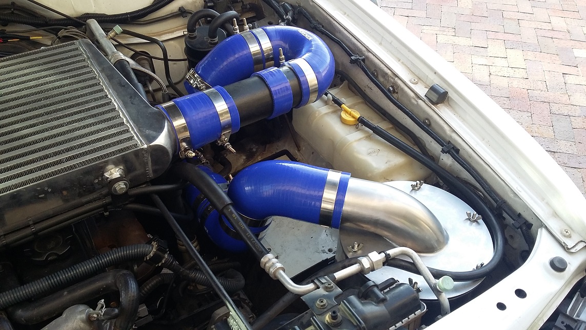

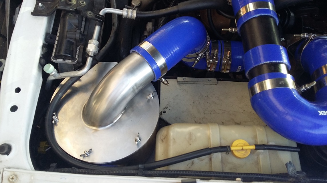

The air box finally came.
Fits nice and snugly. A piece of 3" silicone hose on the snorkel inlet seals super tight, no way water is getting passed that.
The air box looks awesome in the engine bay
Going to relocate the 2nd battery into the back. Will cut an access panel in the drawer system lid to fit the battery between the drawers and the body panel.
Unfortunately the air box won't allow for the 2nd battery as the outlet to the turbo touches, so a bit of compromise
I'm sticking the air boxes under Marketplace - General items / Services for sale if anyone would like to order one.
The engineering shop made some serious jigging fixtures, so they can churn them out 100% every time.
I made up a really cheap and nasty hood scoop from HDPE and pop riveted it to the bonnet for now until the final part is complete.
You have no idea how much it hurt me to have to cut a hole in the bonnet
At least it's drivable now, so time to drive and tune it
