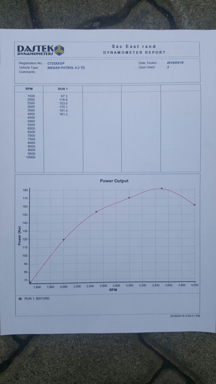

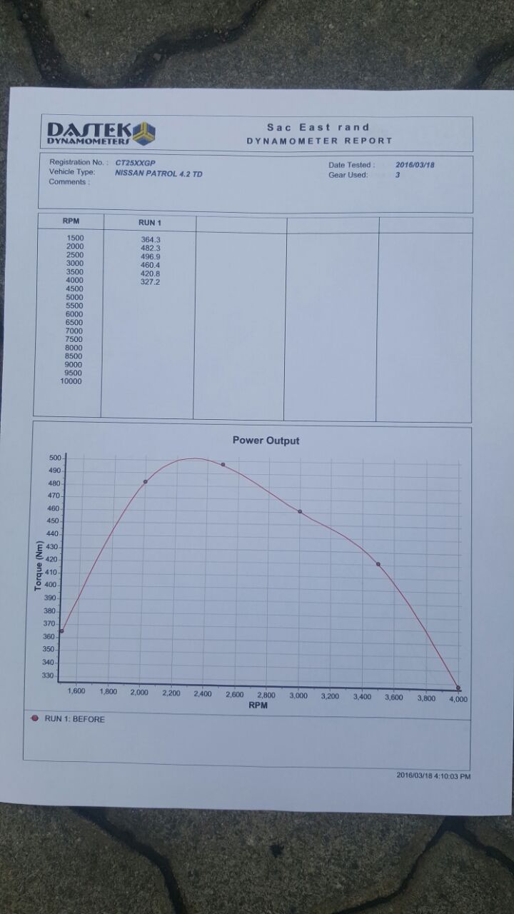

So last week I took my Patrol for a dyno with Josh.
I upped the boost to 1 bar and it spikes to 1.1 bar, gave it some more fuel to match the boost and modified the aneroid fuel pin a bit to deliver a bit more fuel under full boost.
The results are higher than expected, but we will verify this at the next dyno day.....
181kw and 497Nm

Here is the video clip of the Dyno

Thanks Cedric
I am a bit skeptic about these numbers, but the owner from SAC said we have another Patrol dyno day in May......so will see then I guess

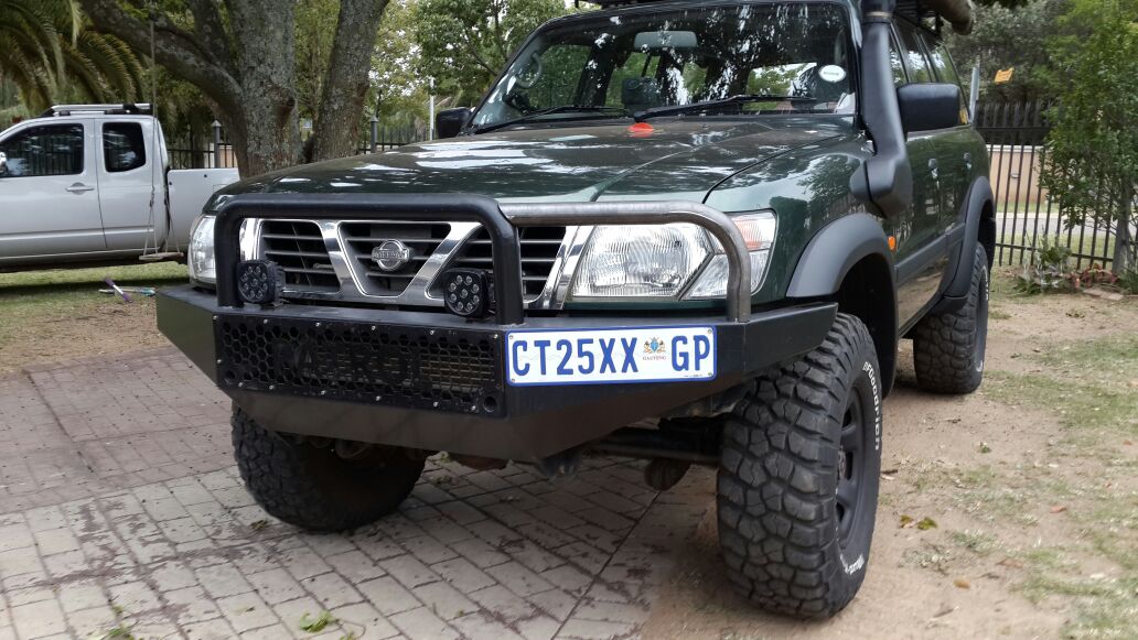

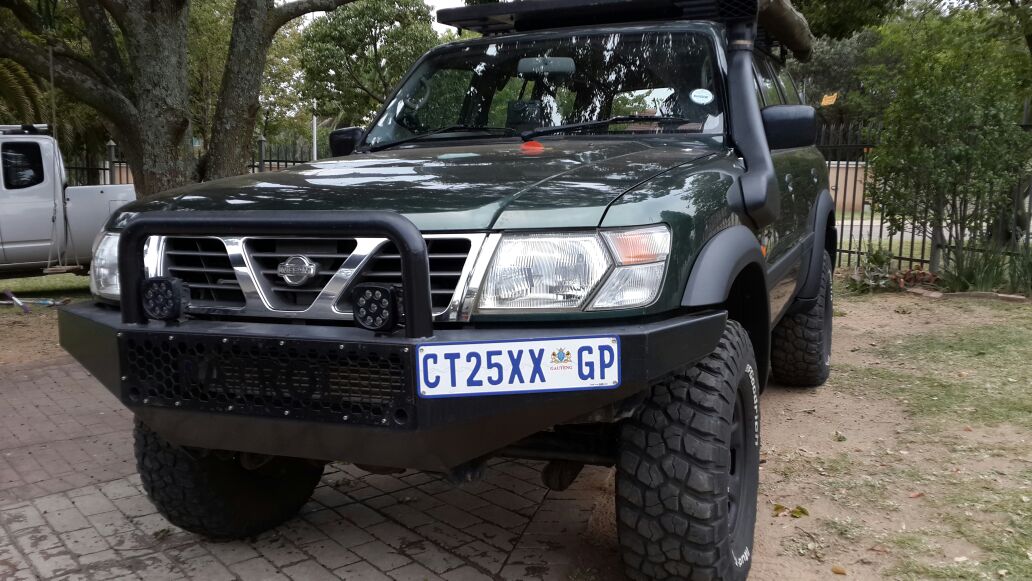

Ok so for a while now I wanted to modify my frint bumper a bit. I like the look of the bush bars with the pipe that protects the headlamps and indicators.
It also helps you to see better where the bumper corner is in tight spots.
I need some comments please.....yes or no for this mod.
See pics below
