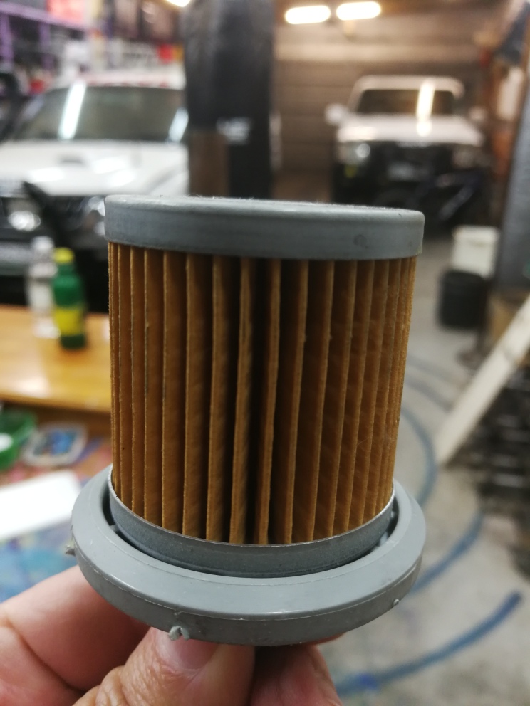

The plastic isn't a problem. It's actually flippin sturdy. You could probably hit it with a 5lb hammer and it wouldn't leave a mark. When I was cleaning my fuel system I had a new filter that was only on for a few test drives around the neighbourhood and then replaced it again. So I cut it open out of curiosity. It's a GUD. So here's a photo of the filter with maybe 6km-10km on it.

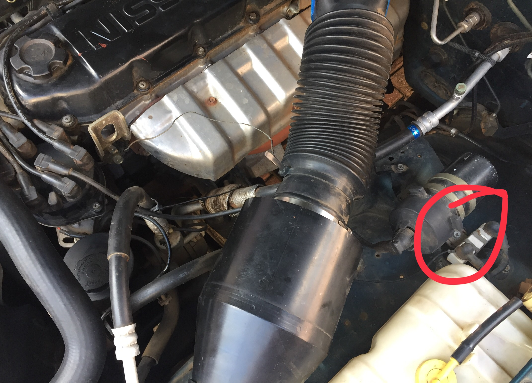

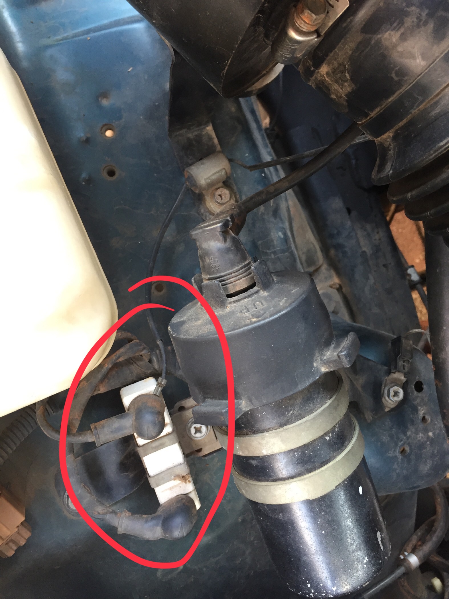

So I discovered a loose earth cable connecting to this (red circle). What is this thingy?
Condensor?
Condensor?

Looks like an ignition ballast resister. Can't advise more though, the last time I fiddled with them was back in the day on a Ford Cortina

Yes, that is the ballast resistor.
Some coils need it, others (aftermarket) don't. A coil that needs it won't last very long if the resistor is by-passed.
Check the resistance of the coil, and compare it to the value in the manual. If it is according to manual spec, make sure the resistor is connected.

Will test the coil

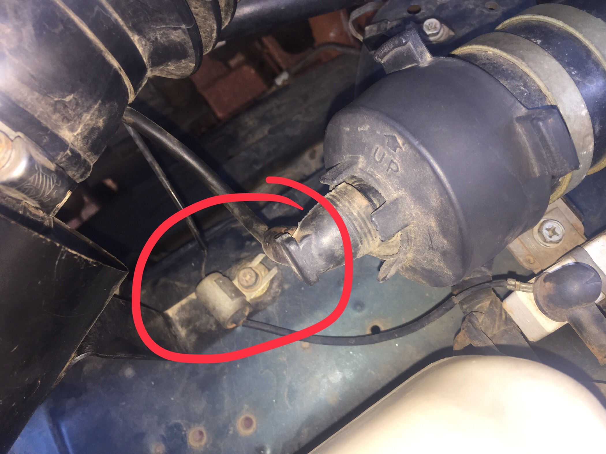

This earth cable from ballast resister is first connected to the condensor and then to engine block.
