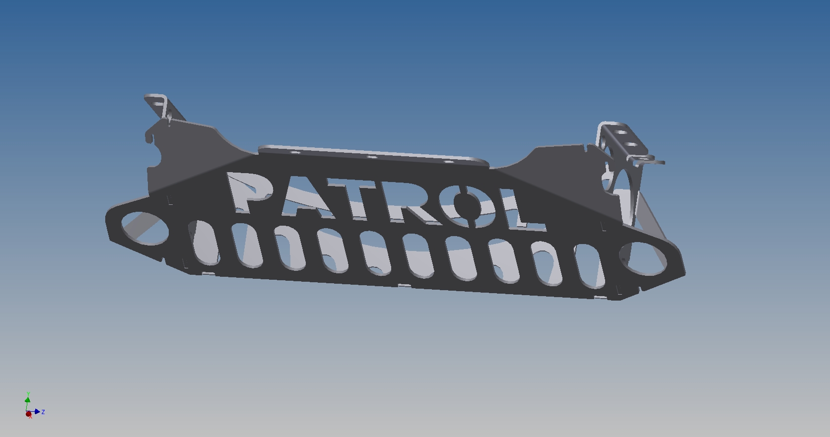

Like this:
Or did you have something else in mind? Also, do you want to be able to read it while standing and looking at the car, or do you want it reversed so that the guy infront of you in the traffic can read it in his mirror?

In fact that looks very good, I dont want to take away my ground clearance or approach angle. Just good protection with a personal touch. I am a bit worried about the strength? Do you think that will weaken the bash plate a lot? Maybe a small support pieces through the P-A-R like the O to help with strength?

Jacques, I doubt whether the cutout makes any difference to strength. The reason I say that is because (and it's not really visible in the picture) just between the text and the row of holes there is a gusset.
This plate doen not affect either the approach angle or the ground clearance, but there are some guys who feel that it extends a bit lower than they would like. To be honest, it was designed to still be fulle effective with a 2-inch lift. May I recommend that you get hold of Tinus Lotz, and take a look at his? He is in Rooihuiskraal and has one fitted to his 2003 GRX with standard suspension?
I have not gotten a price yet, but am confident that I can manufacture these for R1300 or less (if there are another four or so 4.8 owners who want, it should be even less). I am in Kempton, but could easily get it to Tinus in Rooihuiskraal. He operates a business from home, so it should be easy for you to collect from there?
