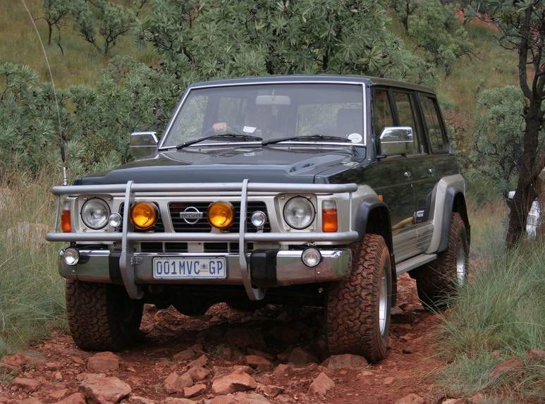

As far as the TB42i is concerned, my Patrol had factory injection (it was a grey import from the UK with a MPH speedo, which was a problem). I do not know if it improved matters, apart from being reliable and working properly on steep inclines where a carb may have its chambers running dry. It was not at all light on fuel, on a Namib trip I got an average 2.23km per lt on the section from Solitaire through the Namib Spergebiet to Walvis. I was lucky to get 6km/lt on the open road. This despite me doing a MAUS conversion, including a chip to try and improving consumption.
Eventually I fitted a 149lt main tank from Northern Off Road and a 60lt secondary tank of my own design built by Uys van Rooyen of Stofpad 4x4. In total I could put 210lt of fuel in the system, which in 2011/12 cost me over R2500 to fill!!! This gave me a decent range between fill-ups....
My Patrol.jpg (78.38 KiB) Viewed 14462 times
