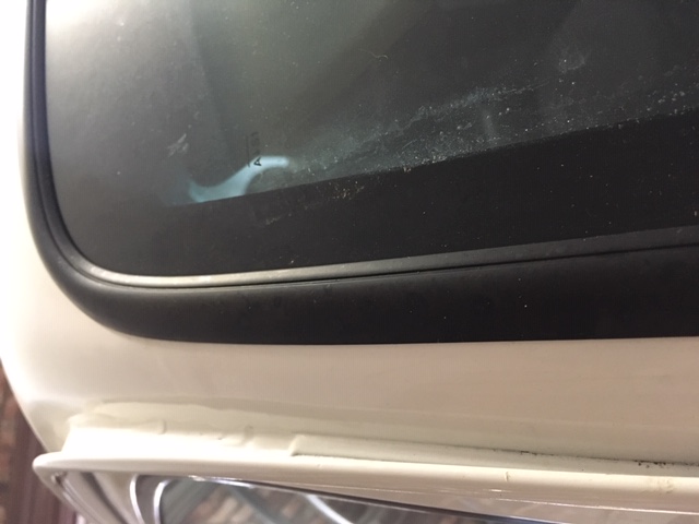

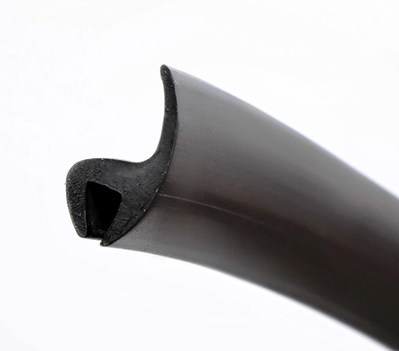

my apologies for the late reply. here some picture of the universal trim rubber fitted to my car.
the rubber looks like this and is one piece.
i see i will have to clean on the body side as there is a little dirt collecting. it is possible to get in with a brush.
at this stage i am happy with how it works and looks.
